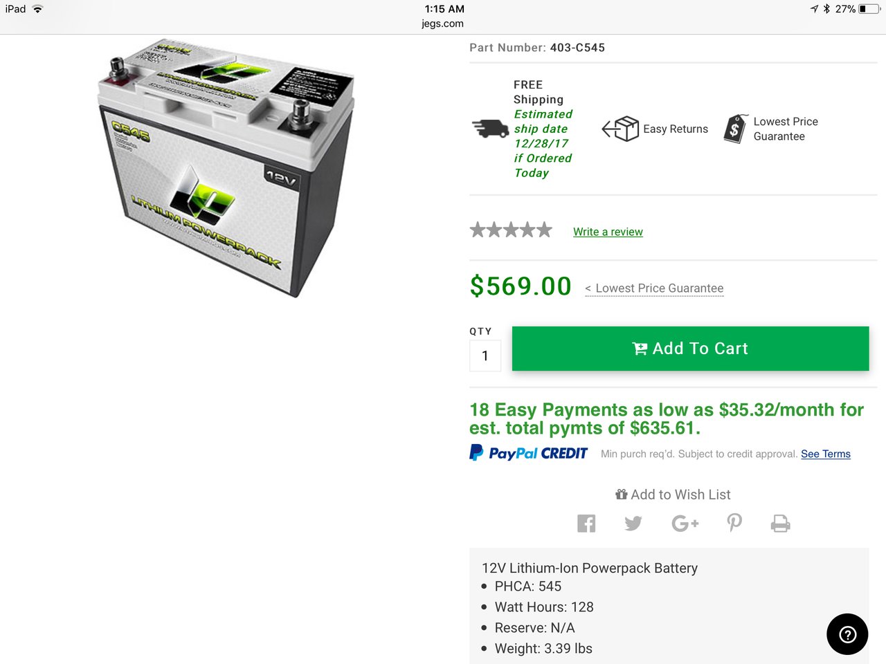

    #237812
    850
    2025 OR DC iF Max
    Would these work well on our trucks?
    Only $1,138.00 for two batteries! Fast charging and good deep cycling.
    These are stated to be good for up to a 3.8 liter engine.
    Weight is only 3.89 pounds or 7.78 pounds for two batteries saving 62 pounds off of your fender compared to two Optima batteries or 107 pounds less than two Odyssey batteries.
    Somebody on TW has to be able to afford these!
