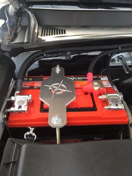

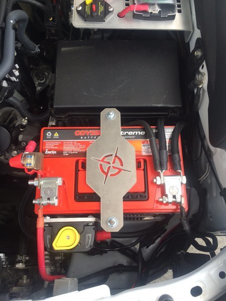

    Just wanted to thank Matt at O.G.E. his system is absolutely flawless and could not be more clean. He was very helpful along the whole way answering any questions I had and it here is how it turned out!
  12. Jan 7, 2017 at 4:18 PM
    #32
    HeliMedic
    HeliMedic [OP] Off-Grid Engineering
    Nov 12, 2010
    #46096
    616
    Erie, CO
    Constant revolving door of Toyota vehicles
    Great work Grant! Very clean install job.
    And thanks for the good word!

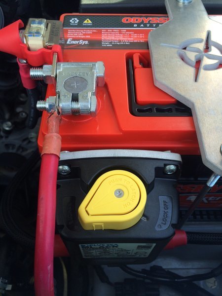

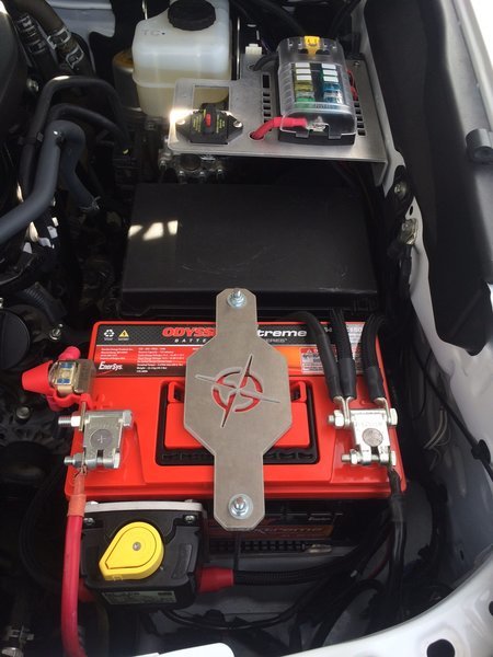

    I just wanted to jump in here and add from my experience that Matt and Off-Grid Engineering were great to work with. Matt helped me through many questions via emails and phone calls and all very timely. I ordered a custom cable kit from Matt, which included the ML-ACR/voltage meter pre-wire, jumper cables and an ML-ACR/battery tray. The quality, packaging and labeling were all excellent for my Optima dual setup with one in the bed and the other under the hood. I can't say enough good things about Matt and his company, so everyone please take advantage of this great resource here on TW.

    Thanks so much for the good word! It means a lot.
    It looks like you did a great job of getting everything put together. I hope it treats you well. Please give me a shout if I can do anything else for you.
