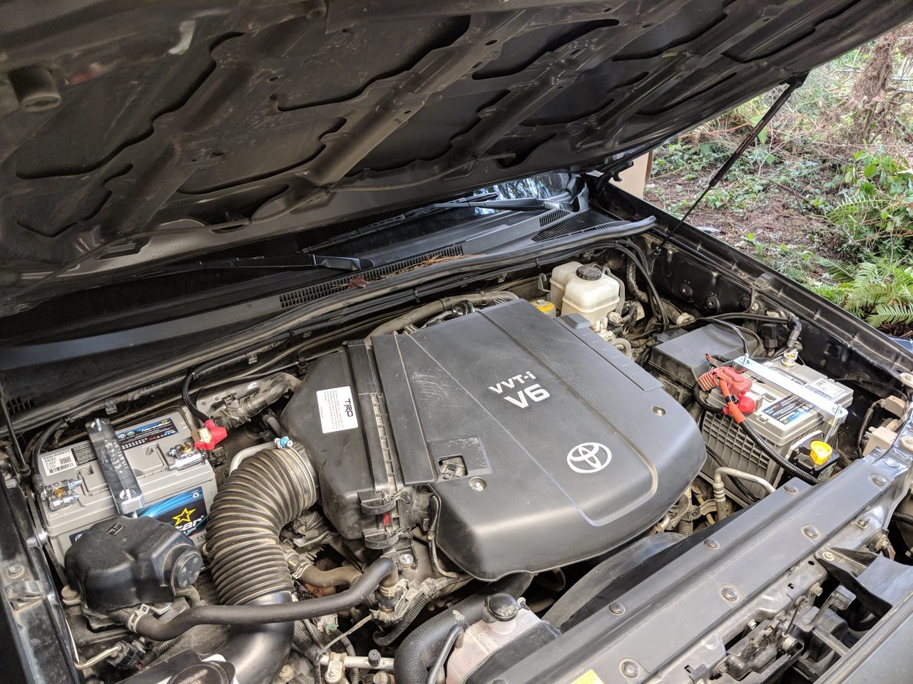

    Dual battery split system installed today with 2 Northstar AGM. Pretty straight forward install and super quality parts! Thanks @HeliMedic for making the bed quality product out there. Now I just need to get my Spod so I can clean up the rest!

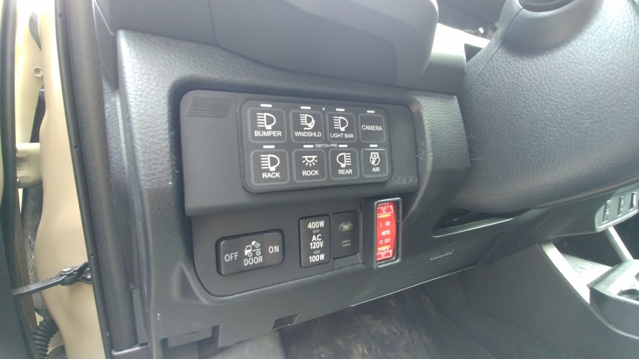

    Sub’d to stay current on this topic, thinking even though i might not “need” it yet, when i install my switch pro and a few smaller LEDs i can be prepared for adding to the system later. Does offgrid offer provisions to run another wire to the bed for a fridge? Thanks
    -Yota

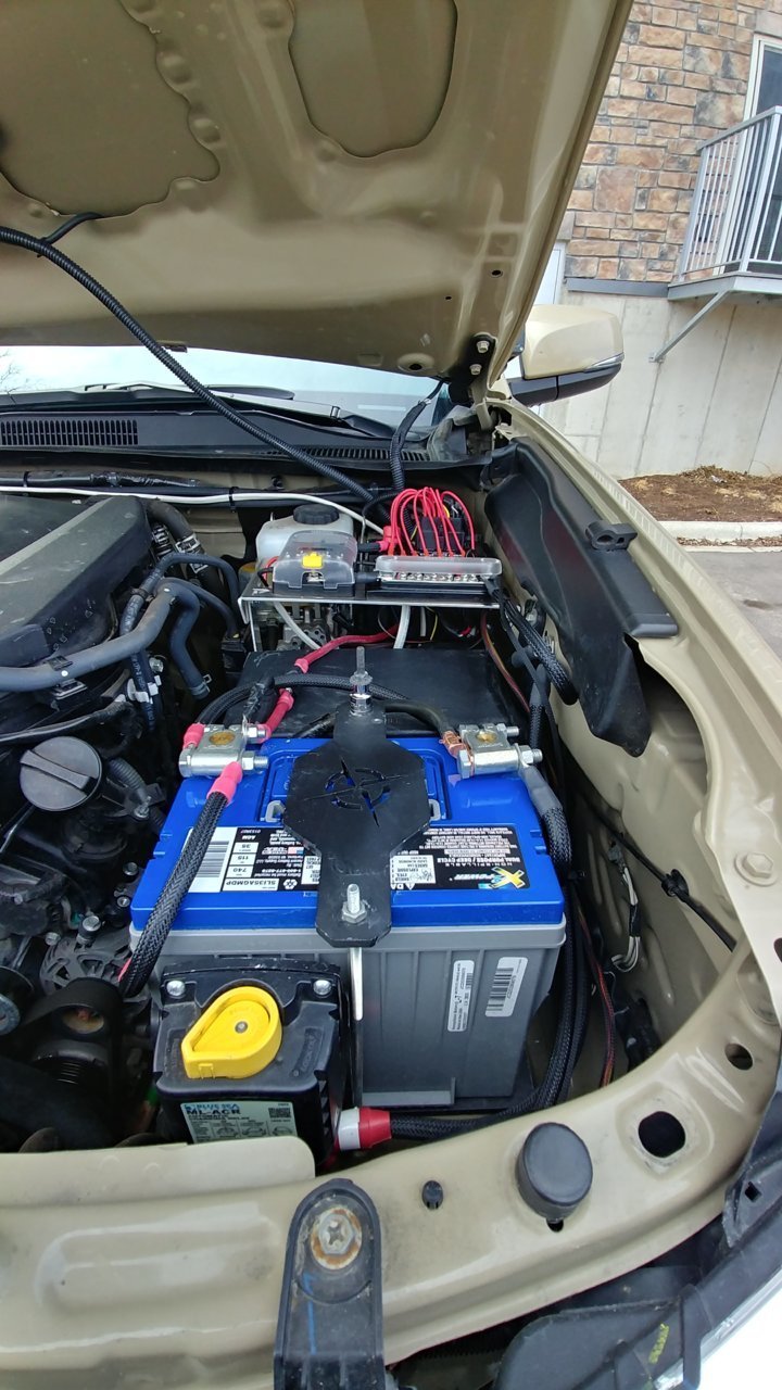

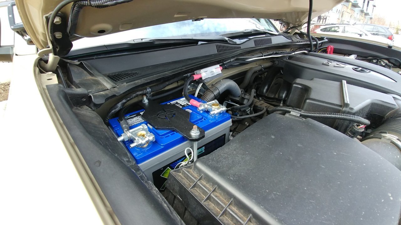

    Posting my install with a few questions -- I have noticed that the ML-ACR seems to be running basically all the time. I have just left it in 'auto' and it seems to be turning on pretty much every time I drive. I had the batteries checked and they're both allegedly fine -- is this something I should be concerned with? I would have assumed that the aux battery would only turn on if the voltage was low...and I didn't think the voltage ever ran that low during normal use.
  18. Apr 6, 2018 at 12:10 PM
    #398
    RCRcer
    RCRcer Well-Known Member
    Jul 14, 2015
    #159476
    879
    2015 OR DC
    If by "on" you mean the center of the yellow switch is in down position, that's a good thing. It means both batteries are connected and at the same voltage. In auto mode when he ML-ACR senses voltage drop is when it will disconnect and draw on the house battery and leave the starter battery with no drain on it.

    Gotcha. I was just slightly alarmed that it was activating so quickly and wondered if I installed something incorrectly. I have all my aux stuff run off the house battery [minimal drain -- switchpro/bluesea] and was just surprised that it was turning on so soon. After reading about it a bit more it sounds like I'm okay though.
