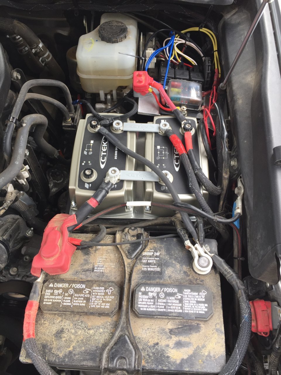

    I went the CTEK D250S and SmartPass route with my set-up. Bought it 2 years ago on sale and finally installed 2 weekends ago. Using stock battery and Odyssey Grp 35 as the service battery with Off Grid tray on the passenger side. 80 amp circuit breakers inline to the fuse panel as well as the service battery.
    https://www.ctek.com/storage/ma/ee2...l_SmartPass_with_Charger_at_Start_battery.pdf
    Ignore the dirty battery...the result of the previous weekend...
    Solar ready when I get a panel in the future and ready for shore power hook-up if extended storage is required at at a location with A/C power and the purchase of the M300 as shown in the link.
    sawbladeduller and Tacomavkk like this.
