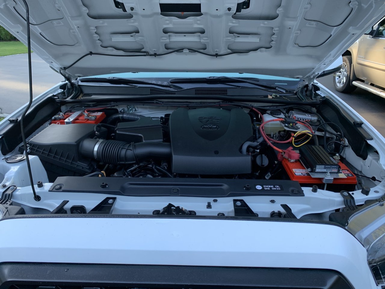

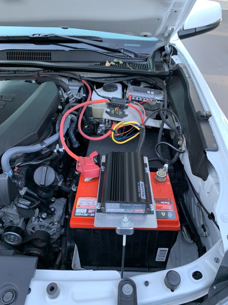

    Selling my complete dual battery setup with a Redarc solar capable charger. $925 includes batteries $550 without batteries. Price is for picked up on Long Island, NY.
    Fuse panel and holder not included. Can include for additional money.
