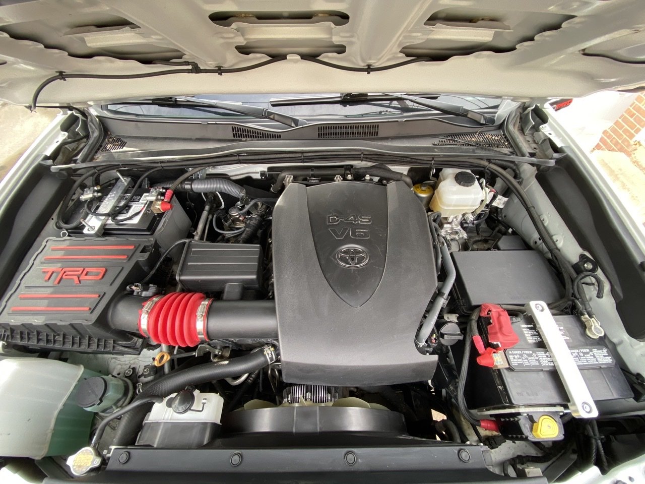

    On my 2019 SR5 there is some equipment in the area where the second battery goes? what is this? can i move it? Is it only the SR5 that has this?

    Watch their install video. He talks about something that gets moved. I forget what it is as I did not have it on my OR.

    from his website:
    “The TRD-OR/ TRD Pro models have the unique advantage of ATRAC. Besides being a great traction aid, ATRAC deletes the ABS module on the passenger side fender, creating a perfect space for a second battery!”
    If it’s the ABS module in the way, ya can’t move that.

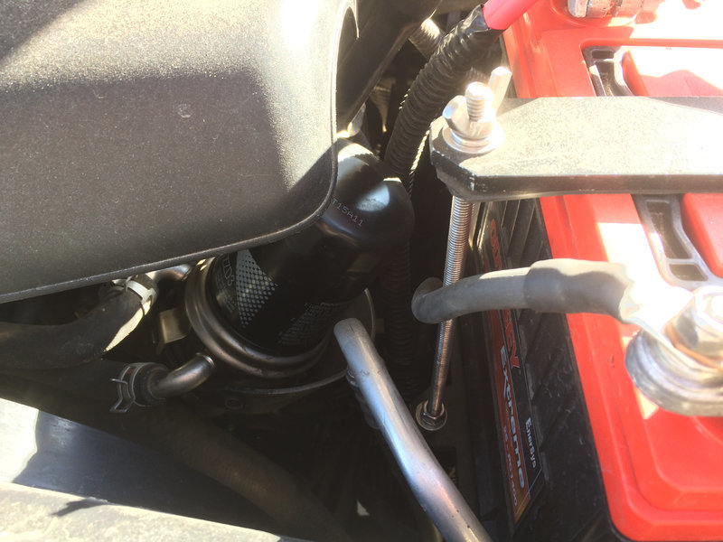

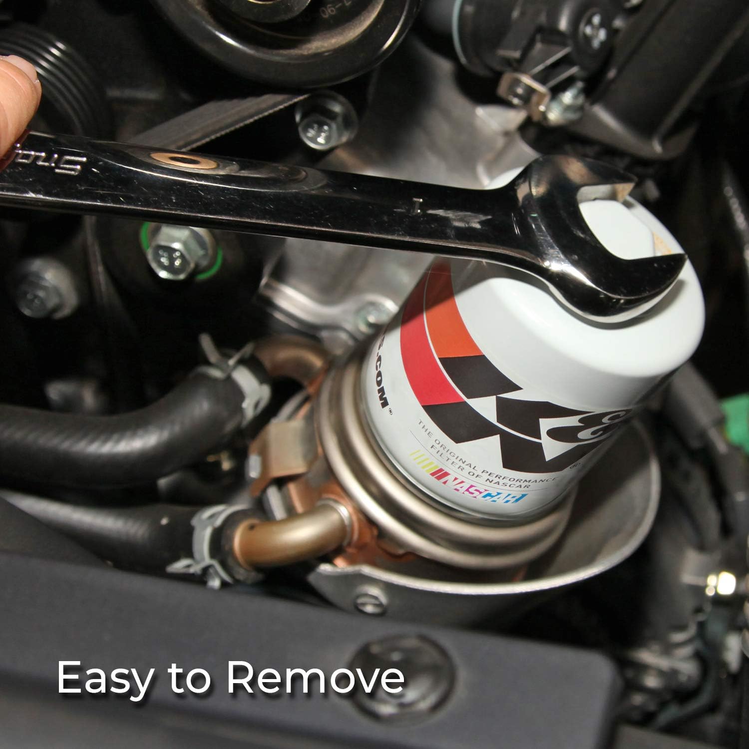

    Using K&N Filters, with their wrench lug on top helps remove the oil filter

    Matt's (Heli Medic) / OGE post was talking about the fuel relay/resistor, which is moved simply by removing two 10mm bolts and turning 90 degrees clockwise and mounting it back on the tray's side panel.
    AS A SIDE NOTE !! Some earlier TRD OR (as in my 2006 TRD OR) were made before ATRAC, and have the ABS module on the passenger side where the tray is designed to go.

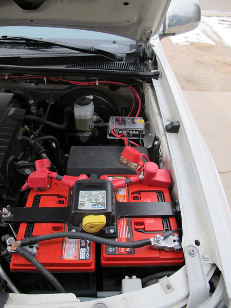

    Which battery do you hook the blue sea to? driver or the passenger battery?
    I have everything hooked up to the passenger battery. Is that correct? When the switch is on
    Or in auto on both batteries are connected but when it disconnects which battery is the main battery? The passenger or the driver side or does that not matter? thanks

    The only thing the ML ACR does is connect or disconnect the batteries. It doesn't really matter which one you call the main or the auxiliary.
    As long as you followed the instructions and the wiring diagram to hook it up, then you should be good.

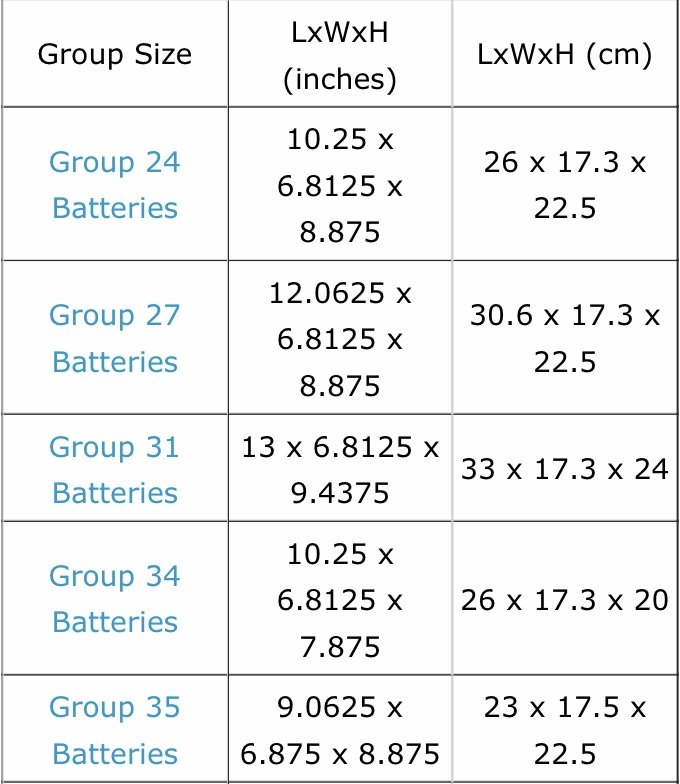

    Still trying to map out a system for my 2012 before buying anything. I have it narrowed down to this kit with two AGMs but was wondering why the Group 35s are recommended for both batteries? I understand the Aux battery is in a tight space but why would you put a smaller Group 35 in place of the stock 24 or 27?

    I went with a 27F in the stock location and a 35 over on the passenger side near the firewall.

    Thanks. I figured the physical size wouldnt matter with pairing, only the type of battery and age so the charging properties are as close as possible... just wanted to make sure.

    "They" say it does matter, but I think its a very small consideration compared to two batteries of different age or even worse, different type. Thats a much bigger deal

    Im going to wait until I get the kit installed to fit check but I think I will get two 24F batteries since they are slightly larger than the 35 and come stock on non tow package trucks. Just to be safe since “they” say it matters. But nice to know I could run different sizes in a pinch.
