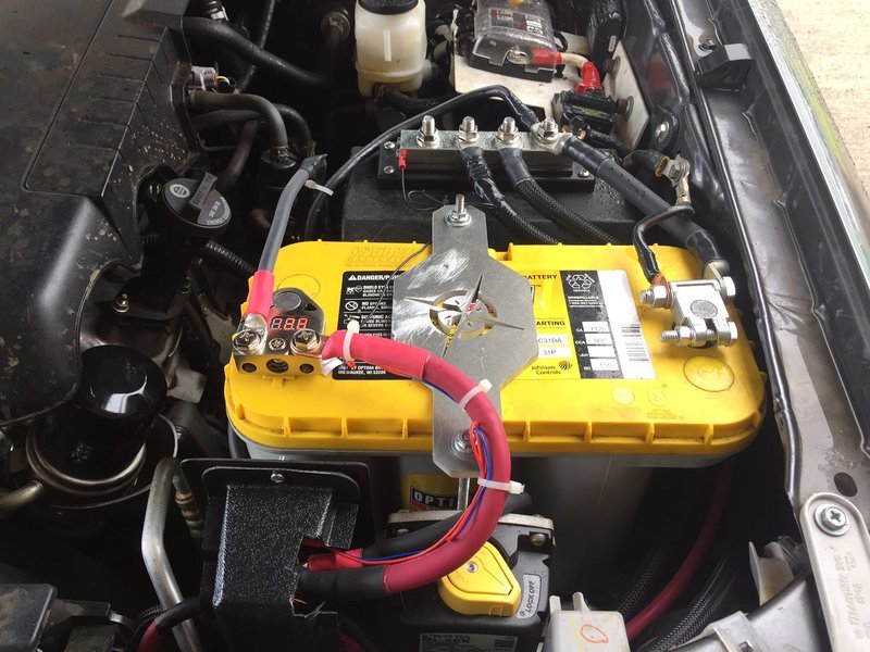

    Where did you pick up that voltage meter? Really like the clean setup!

    In the original picture of the wiring there is a negative wire running from the main battery to the aux. Is there a reason to run a wire instead of using the truck body as the negative like the main battery does?
    I didn't read through all 33 pages, so if the answer is in there, I apologize but I don't have 33 pages of extra time.
    And I've crimped wires using a blunt masonry chisel like mentioned above and it works just fine. Haven't had any trouble with the ends years later.

    Great Question!
    That is our ML-ACR kit, in which we do have the batteries connected through the negative. Our DC-DC REDARC kit do link through the chassis due to a much lower charging amperage. 25amp vs 130amp.
    The reason why we have our batteries hard connected negative to negative, is so that we can guarantee that there are no restrictions on how many Amps the batteries can be charged at. By linking the batteries through the chassis you might end up with a restriction. especially when you are using both batteries to start the truck or winch. The ML-ACR which links the batteries can handle up to 500amp charging. That is far greater than the 130amp rating of most Toyota Alternators. But 130amp is still a lot to ask to be sent through the sheet metal of the truck. Even using large gauge wire to connect the battery to a factory ground it is still relying on the spot welds that hold the inner fender on to transfer all that energy between the batteries. So by linking them together with 2AWG Welding Cable, there is no chance of the connection between to batteries is the restriction of charging or draining ability.
