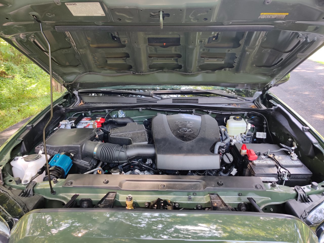

    I just installed this Odyssey AGM Group 65 in my 2017 with the Off Grid Engineering dual kit and it fit without issue. I wanted the expanded AH capacity to run my fridge... it's only 6lbs heavier than the recommended group 35 battery on the OGE site.

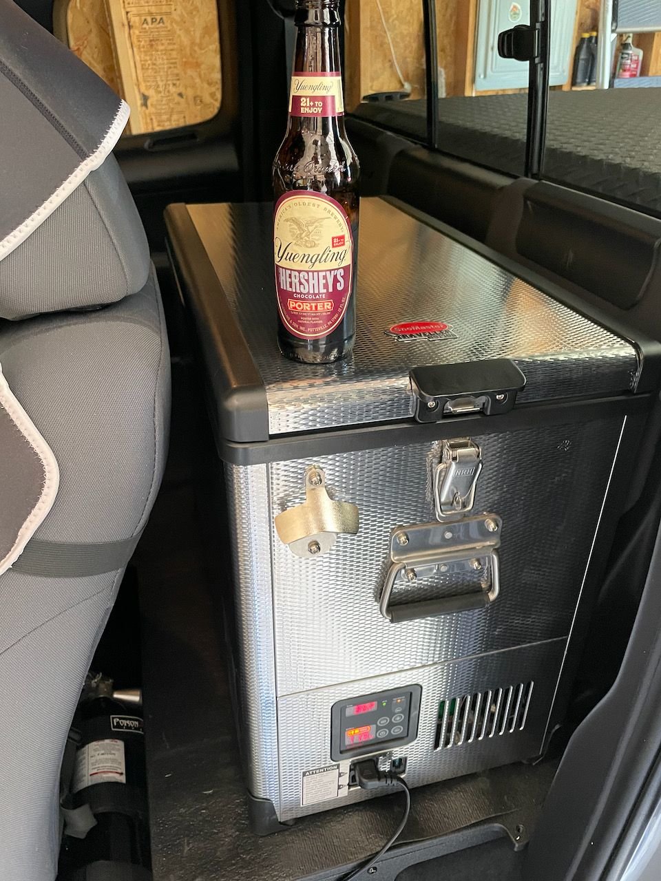

    P.S. So I have their recommended Full Throttle Group 35 that has 64 AH, and I can see having as many AH much as you can. I've noticed that on hot days power consumption on my fridge (42L Snomaster) is higher of course as the fridge is not venting to the outside so it's just continually sucking in the Tacoma's interior hot air. Currently I'm on vacation, no plans to drive today, and it's going to be 96 degrees outside. With my Tacoma sitting in the sun, I have the fridge plugged into an outside outlet at a rented cabin.
    I'll note that I also have a dual battery setup in a Jeep TJ (using the National Luna isolator), and "I think" that my Jeep's alternator charges the auxiliary battery faster than the Tacoma does? I'm wondering if I should have stepped up to the DC to DC alternative over the split charger? My fridge has different settings where it will turn itself off, and I have it set at the lowest at 10 volts, but I have yet to test how long that will take? At home I'm always parking in a cool garage overnight and driving daily, so the auxiliary battery is getting charged daily. I think when I get back home, I'm going to do a controlled test to see how long the fridge remains running on the Full Throttle (being full, set at 34 degrees, Tacoma setting outside in the sun).
    P.S. EDIT: I also want to run a test how quickly the auxiliary battery recharges (and does it really recharge up to 100%?) from being flat.
    ANYWAY! Having ice cold beverages (water, soda, beer), sandwiches, cheese sticks, even ice cream, along a road trip with no ice required is a game changer! One benefit is I have already noticed is that I'm just not eating fast food on trips. I'll never go back to a cooler. :)

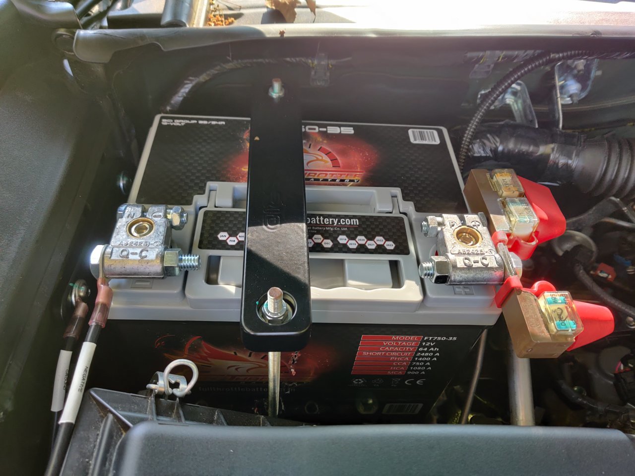

    Installed the OGE dual setup with REDARC last week. Put about 300 miles on the truck after the install, everything is working perfectly and the batteries are very secure with the new trays. I had the trays and tie downs powder coated locally.
    Kept the factory starting battery for now.
    Added a FT750-35 for the aux battery.
    Wired up nicely.
    Very happy with the Off-Grid Engineering and REDARC products!

    I’ve been curious about battery drain with my 42 liter Snomaster fridge, which I’ve been running full-time in my Tacoma since installing this dual battery system last spring, using the Full Throttle Group 35 batteries. I’ll note that most nights I plug the fridge into a garage outlet. On a recent trip, I didn't drive my Tacoma for three days, that sat in the sun, so I did bring an extension cord to plug in the fridge to a cabin's outlet.
    For some background, in 2017, I originally bought the Snomaser for a Jeep TJ for two-week camping trips as I was tired of dealing with a cooler and ice. I would usually drive every day so the auxiliary battery in my Jeep was to run the fridge overnight. The fridge otherwise has been a beer fridge for my garage. In my Jeep, I figured that during the summer, the fridge would run at least 24 hours on a Group 34 AGM battery. With several fall camping trips (ie. colder temps), the fridge would run upwards of 48 hours on the auxiliary battery.
    So to test power drain in my Tacoma, I started with charging both batteries (connected) overnight with a CTEK charger, and I took readings with a simple volt meter from both batteries as well as the outside and inside (cab) temperatures. Of course, the hotter temp it is inside my Tacoma, the fridge will use more power. Obviously it is (at least) best to leave a window cracked to allow cooler air into the cab, however I left the windows up.
    Friday 7:00 am (parked in garage)
    Both batteries 13.1v
    Fridge set at 34 degrees, had been plugged into a garage outlet, fridge was 95% full.
    Drove 15 minutes to work
    Friday 7:15 am
    Starter: 12.82v
    Auxiliary: 12.78v
    Temp Outside: 68 degrees
    Temp Inside Cab: 72 degrees
    Fridge temp: 34 degrees
    Friday 12:00 pm
    Starter: 12.84v
    Auxiliary: 12.72v
    Temp Outside: 81 degrees (cloudy morning, sun had just come out)
    Temp Inside Cab: 90 degrees
    Friday 4:10 pm
    Starter: 12.75v
    Auxiliary: 12.23v
    Temp Outside: 85 degrees (sun had been out all afternoon)
    Temp Inside Cab: 96 degrees
    Drove 15 minutes (to garage at home, garage had two hot vehicles)
    Friday 4:25 pm
    Starter: 12.97v
    Auxiliary: 12.71v
    Friday 8:30 pm (parked in garage)
    Starter: 12.67v
    Auxiliary: 11.83v
    Temp Inside Cab: 85 degrees
    Saturday 4:30 pm (parked in garage)
    Starter: 12.63v
    Auxiliary: 11.36v
    Temp Inside Cab: 86 degrees
    Sunday 7:30 am (parked in garage)
    Starter: 12.67v
    Auxiliary: 11.27v (fridge was beeping that it had turned off)
    Fridge temp: 44 degrees
    Sunday 4:00 pm
    Starter: 12.67v
    Auxiliary: 11.27v (fridge was off)
    Fridge temp: 60 degrees
    Drove 15 minutes
    Sunday 4:15 pm
    Starter: 12.58v
    Auxiliary: 12.04v
    Drove 15 minutes
    Sunday 4:30 pm
    Starter: 12.91v
    Auxiliary: 12.43v
    What’s all this mean to me?
    • The Group 35 with summertime temperatures will run the fridge set at 34 degrees for at least 24 hours.
    • The interior cab temperature is an issue with power consumption. Leaving a window cracked or having some kind of outside venting would be ideal to increase the running time.
    • Driving 30 minutes is not enough time to charge the auxiliary battery from near zero to a full charge.
    • However, driving 15-30 minutes (my commute time) is enough time to recharge the battery for running the 9 hours that I’m at work.
    And?
    • First of all, I love having a fridge for road trips vs. the old days of having a cooler and it’s been my favorite must have for camping. No more having to add ice and drain a cooler each day. For trips, I find that I eat less fast food as I can take sandwiches and my own drinks. Not to mention having ice cold beer without the ice.
    • For trips, I keep the fridge at 34 degrees as I find that frozen items (like meats) on the bottom stay frozen, yet water, etc., do not freeze. Running time would be longer if for example the fridge was set at 40+ degrees.
    • As far as keeping the fridge full-time in my Tacoma, I do have to plug the fridge into a garage outlet each night. I do like having the fridge as for example, I can stop at a local butcher over my lunch hour and buy steaks for dinner and put them in the fridge for when I’m home. I have even bought ice cream over lunch and turn the fridge down to 30 degrees!
    • I could seeing integrating a solar panel in to help power the fridge while parked outside, however with plugging in the fridge to AC overnight, that works for my use.

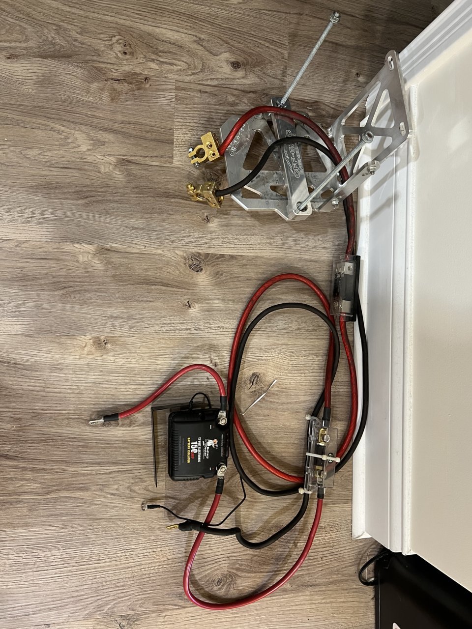

    I ended up building my own "kit". Used the Off Grid aux battery holder. All wiring is 4 gauge with crimped lugs and connectors as well as battery terminals with multiple 4/8/12 gauge holes for connecting your secondary loads or distribution blocks. Dual fuse holders with fuses. WirthCo Battery Doctor 150A isolator/auto relay with manual override. This automatically connects the batteries and charges the secondary battery while the engine is running, disconnects when not. Push a button to connect and jump start if your main battery goes dead. No longer have a need for it and probably going to sell it. Worked awesome.IMG_6205.jpg
