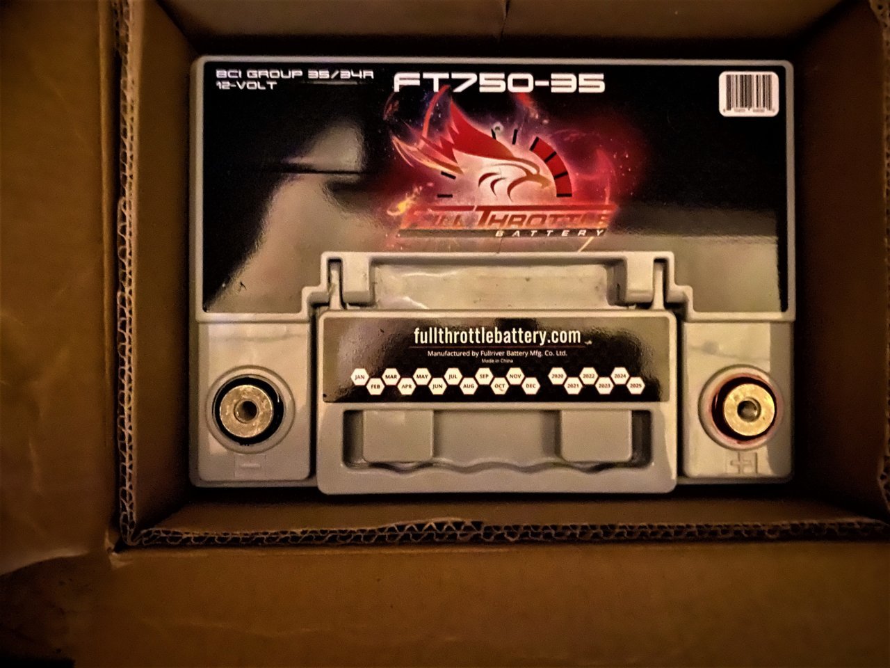

    I purchased 2x group 35 s Full Throttle batts from
    https://batteryguys.com/
    Best service and price on batteries.
    First class company!
    Getting ready to install my new OGE system as soon as the outdoor temp rises above 32 degrees, currently (-) 9 F

    Note that full throttle is an off-brand Chinese manufacturer. So yeah, great price because you are buying cheap Chinese batteries.

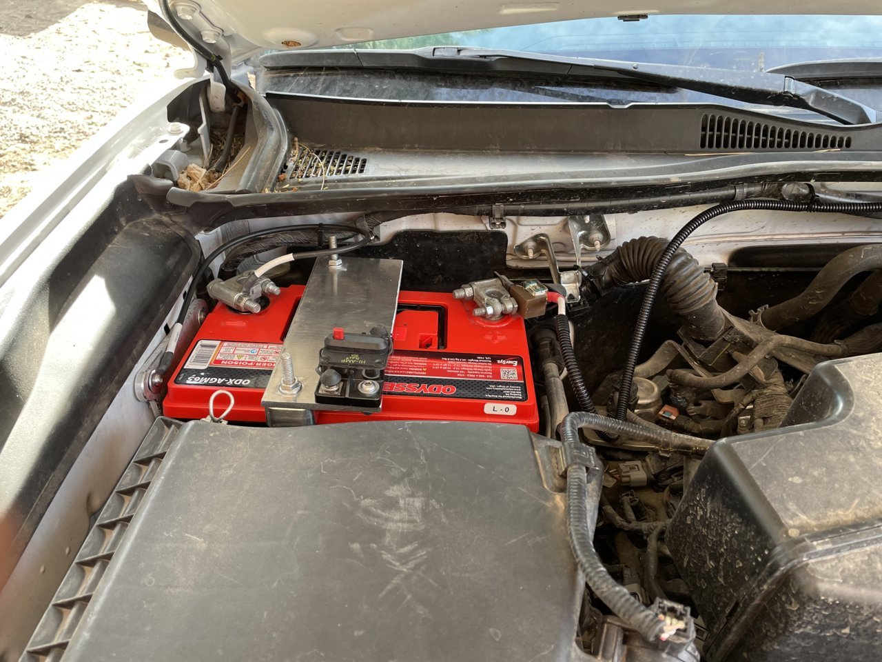

    After hours of searching the web I finally found this picture. I was concerned about where the red arc gets mounted in this kit. Thank you for posting. Could you tell me is this system still working good?
