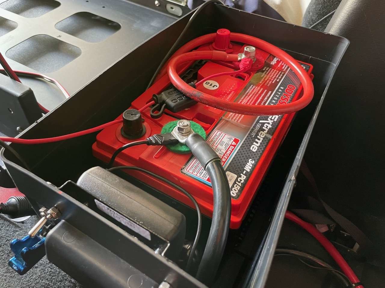

    So, my Tacoma is mostly a daily driver, so I don't have that issue. However, I also have a Jeep with a National Luna split charger that sits months at a time, which that split charger module draws on the auxiliary battery, and yes, over time drains the auxiliary. So on my Jeep, on the starter battery, I installed a disconnect knife switch (found on Amazon). It works great to cut power to the Jeep so nothing drains the starter battery.
    Then on the auxiliary battery (which sits in the back of the Jeep), I installed a switch on the negative wire to the module (see bottom left corner of picture), which when switched off, cuts the power to the split charger module, and prevents the drain on the auxiliary. Not the same setup as the OGE, however I'm sure you could install a similar setup.
    I'll note, I have a fridge that is usually in my Tacoma, however, I also put it in my Jeep at times, which is why I have dual batteries in both vehicles.
