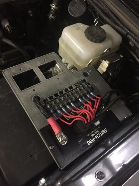

    Does anyone know who makes or sells the tray the switch-pro module is mounted to in post #124. I'm interested in buying the kit with the Switch-pro module but would also like to buy the mounting bracket. Also should I be thinking about fuses between the battery and switch-pro module or the switch-pro module and the devices being powered?

    That is a Pelfreybilt fuse box tray that we modified.
    The Switch-Pro unit comes with a 100 amp inline fuse built in to the cable that powers it. When you order a Switch-Pro through me, in conjunction with a dual battery system, I build a longer cable with the same 100 amp fuse built in.
    The Switch-Pro has built in circuit protection for the devices its powering. 18 amps per circuit, except circuit 8, which can run up to 30 amps if wired properly. The directions walk you through how to do it.

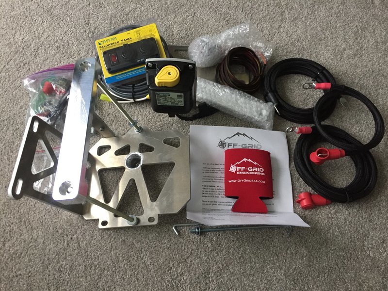

    Matt,
    From the photo I took, can you see if the longer switch pro cable with the proper 100 amp in line fuse was included in my kit?
    Edit: I ask because I don't think I identified it.

    Constant revolving door of Toyota vehicles
