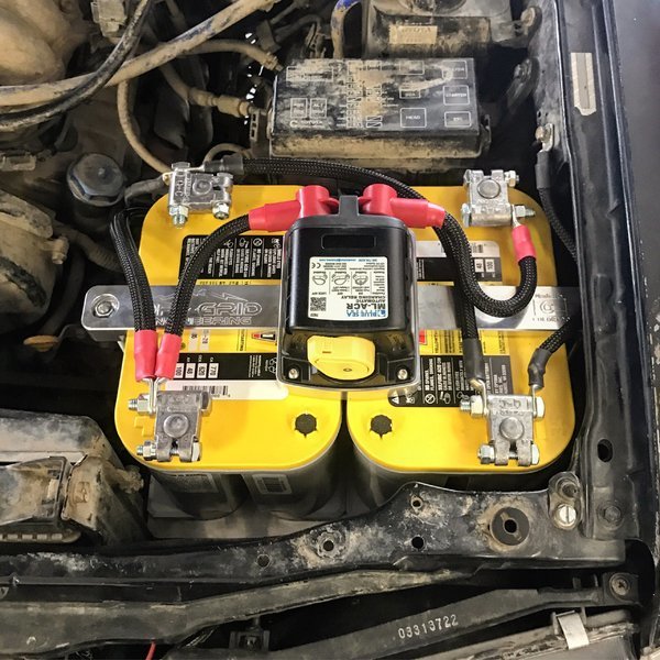

    So I did this install in the pouring rain as soon as I got it because I just couldn't wait! Got totally drenched, but I'm so stoked with the results!
    OffGrid Engineering side by side tray, custom cables for my fuse block setup, and 2x Northstar AGM35 batteries. Winch is hooked up to the Starter battery, and the fuse block (lights, compressor, fridge etc) is on the Aux.
    The install was pretty straight forward, and took me about 2.5 hours in the dark and rain. I know my engine bay is filthy, but @HeliMedic's clean cables make it look so pro!

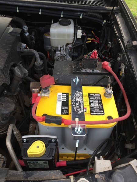

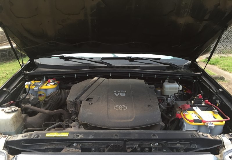

    Install complete! I ended up keeping the SP8100 hooked up to the starter battery, but moved the winch and air compressor power cables to the auxiliary battery. So no need for the modified cable from SwitchPro to aux batt. I hope this is ok.
    Thanks again, Matt, for answering all of my questions and designing a clean/quality system!
    Edit: I know, I know...engine bay is filthy.

    Any increased "taco lean" with the two Northstar Group 35 batteries in the front corner?
  11. Mar 15, 2017 at 2:04 PM
    #171
    WormSquirts
    WormSquirts Armageddon
    Dec 18, 2015
    #172583
    2,852
    Braeden
    BC
    At first I thought it was, but I think I just coincidentally was parking on ground that was always leaning that way, because after having it on for a while I can't tell that it's any more than normal.
    I do find that the body roll when turning right is slightly more than before though (no sway bar). Got used to that pretty quick though and I don't notice any more.

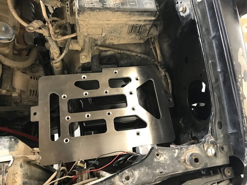

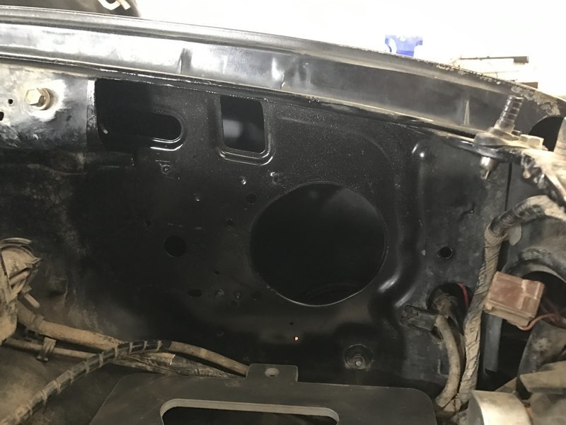

    I got a chance to play with a 3rd Gen 4Runner the other day and the conclusion was that it was going to be very difficult to develop a "bolt-in" kit that allows the use of two batteries in the stock location. So, I put the brakes on that for a bit. I may revisit the idea later... but whatever we come up with will have to be a complete departure from the rest of my trays/ systems.
    Now, with a little trimming of the inner fender and relocation of the radiator overflow reservoir, two Group 35 batteries fit beautifully using my 2nd/3rd Gen Tacoma kit.
    So, if you're a DIY kind of guy, I recommend going this route. Here's a few pics of the install and where we had to cut the fender.
