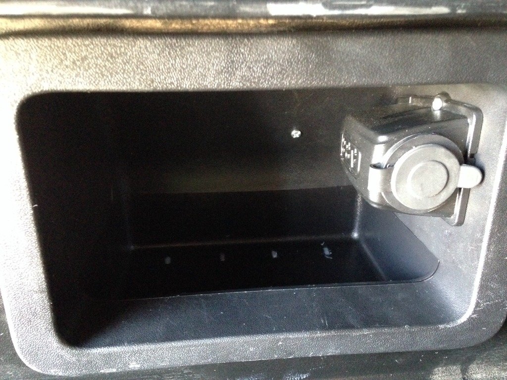

    I'm using ARB dedicated 12v to the bed. The AC in the bed is weak sauce and fishing a 12v cigarette to the bed from the cab is a no go. As Crom states ARB has low voltage cutoff to assist. When stopped I have an Arkpak with group31 diehard and 100 w solar. So good for dayzzzz.

    Strain relief. The cubby is silicone sealed and waterproof to date.
    The wiring is connected to SkyGear's box and fused just before the battery.

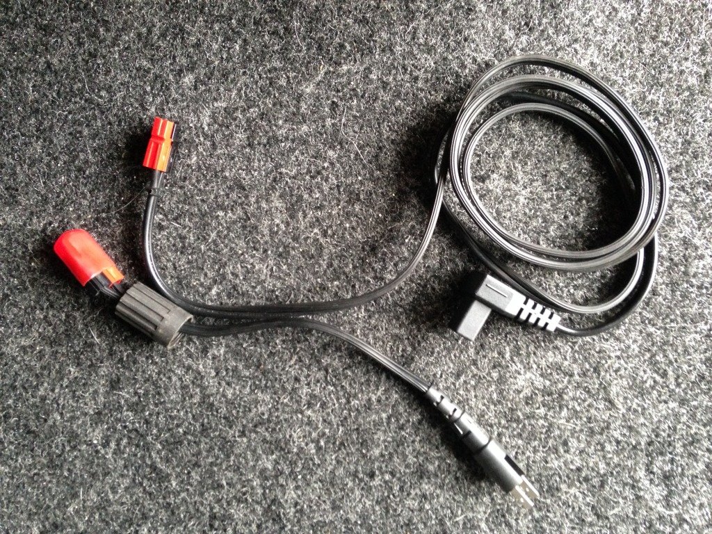

    As far as I know that ARB socket wiring extension thing is universal, but I'd want to be 100% sure before buying it. I'd also compare the cost of that thing vs. buying a fuse and some good 10 gauge stranded copper wire stick it in some 1/4" split wire loom and run it along the frame into the bed and wire yourself a socket. In my setup I cut off all the sockets and use Anderson Power poles for connecting things. Whatever you do apply some vinyl tape to keep things connected while on the trail.

    Here is a pic of the ARB cord. It's designed with center groove to fit firmly in the female end.
    In tandem with Crom , I'm using ALL Anderson powerpole connections. I spliced into the ARB wire with Anderson power poles. I can use the 12v connection you see, 12v cigarette and I have a separate 50a Anderson powerpole for the Arkpak. All solid connections and hand built. All fused for safety.

    In my bed, one of the pieces of the 120v outlet was cracked. I removed the lower right bolt and drilled out a hole big enough for one of the BLUE SEA 12v outlets. Stuck it in the place of the bolt. Secured it and ran power to it. Been running the fridge/ freezer in the 85 flavor for years now. I'lll snap a pic and post up later.

    I placed the socket in my driver's side cubby, just below my diff breather mod. FWIW, I plugged my ARB 50 qt into it and let it sit for 24 hours in my garage (granted, not out in the heat) and the draw on the battery was about 0.2v.
