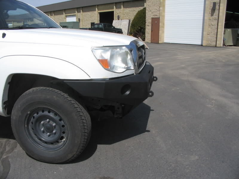

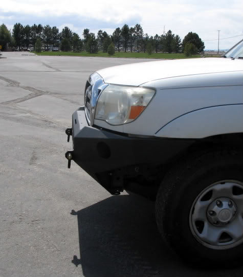

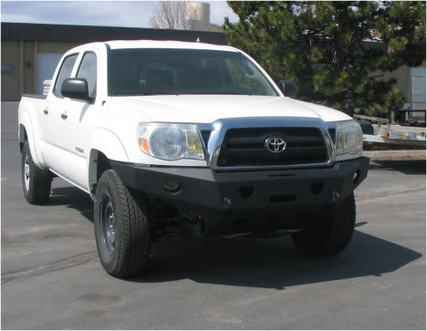

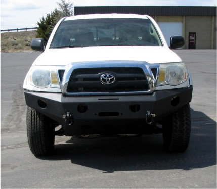

    How would an aluminum bumper hold up to a impact from a deer? or small collision?
  8. Nov 29, 2011 at 1:21 PM
    #28
    Pugga
    Jun 18, 2010
    #39131
    38,706
    Massachusetts
    '19 Ford F-250 6.7 SCrew
    F-250 Land Yacht Mod
    PM the guys from Relentless Fab. This question came up in another thread and basically the answer was aluminum isn't quite as strong as steel but will take a pretty good hit. It's not a battering ram like the ARB but Relentless wouldn't advertise it as an off road bumper if it wouldn't hold up to a decent amount of abuse.

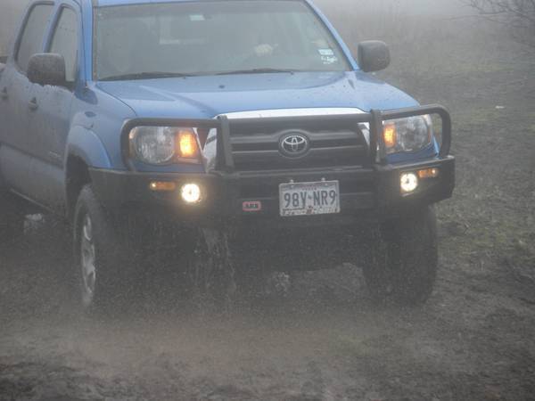

    Here's an ARB on another member's truck......

    x2 the arb imo does not look right with no lift on the truck but, that is subjective.
    whats not subjective is the fact that it weighs in at a massive 150 pounds lol that weight will have you factory springs begging for mercy in like 100 miles. a panic stop would most likely induce major nose dive and contribute to a possible loss of control and negate some of the safety designed into the arb in the first place.
    arb designed that bumper to be used in conjunction with their 885/886 ome springs and suspension to combat the extra weight hanging almost 1 foot past where the factory bumper was. look at a profile pic of a stock tacoma then look at a profile pic of a truck equipped with an arb bull bar it protrudes far past the factory bumper.
    this only exacerbates the problem of beating up your springs because when the truck hits bumps the weight of the bumper will be multiplied by it hanging further from the axle.
