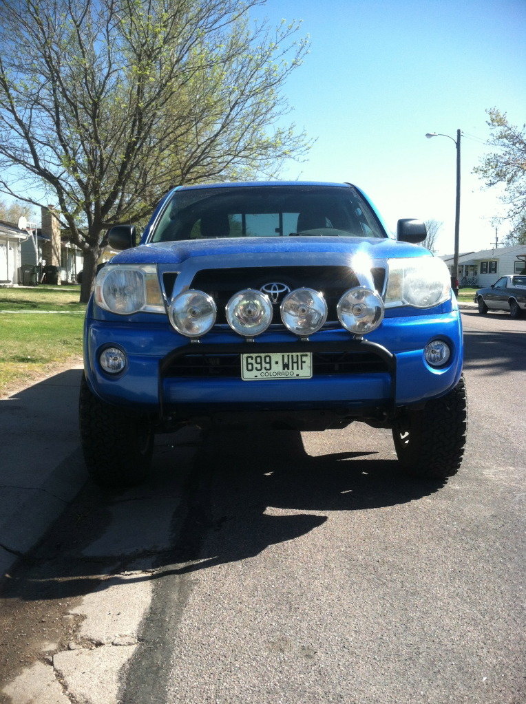

    Lol thanks Reed. I think I am going to go with the Hella 500ff with a 55w HID conversion

    Anyone else out there? I have some Hella 500FF but want something a little different... for distance.

    You're definitely not going to want LED if you're looking for distance. Don't get me wrong, I'm a big fan of LED's, but they simply do not compare to HID and even some halogens when it comes to distance (the lightforce genesis halogen mentioned above has better distance than almost any LED light bar available, that I know of).
    A retrofitted hella 500 is going to certainly be the cheapest option and will probably have pretty good distance. Many people have done it and been very happy with it. Not a bad route to go especially since you already have them.
