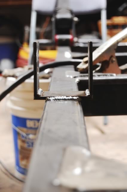

    Small update.
    Got both spring hangers made and welded on. I'm getting started on the u-bolt plates but that might take a while.
    And yes, those are the chrome dubbs this thing is rolling on :rolleyes:

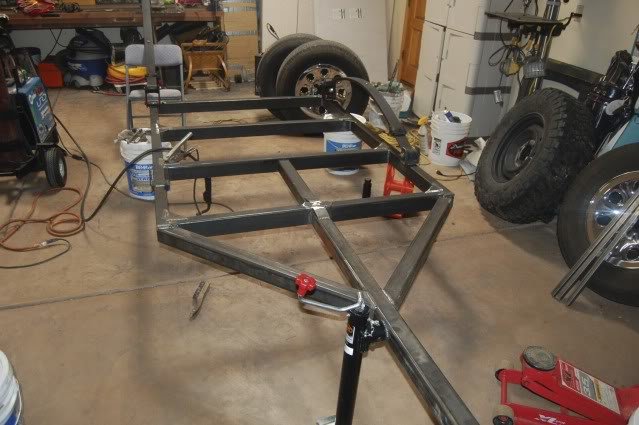

    Got it rolling last night. And my hitch arrived today, so I can get that all hooked up.
    My dad is helping me out today so we should make some solid progress.
    Hopefully we can at least get the frame cleaned, add the fenders and get it ready for paint.

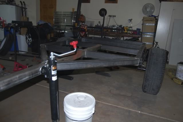

    sorry for the messy garage.
    but I just hooked everything up and took it around he neighborhood. next I'm going to work on the shock mounts. I think I might use the tacoma shocks and make a small shock hoop in the trailer. Then I won't have to worry about maxing out the shocks.
