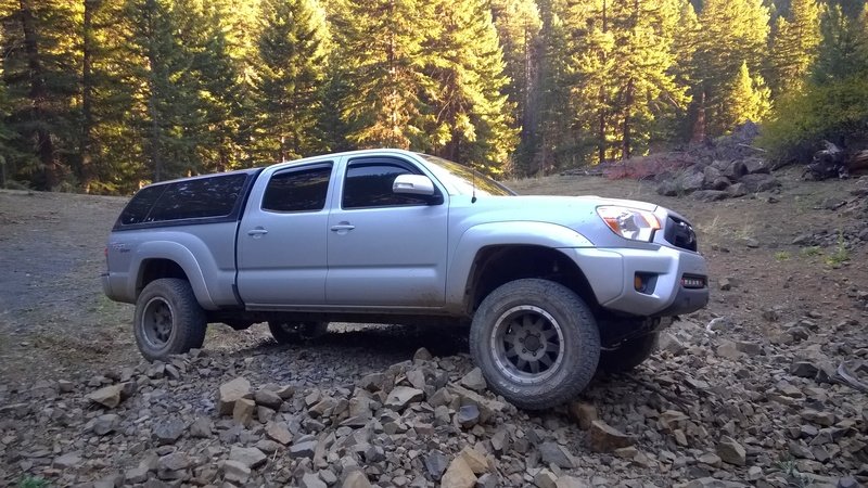

    Toytec coilovers in the front set to 2 inches of lift, Light racing upper control arms. for the rear its got the Dakar leaf packs, Ubolt flip, icon 2.5's w/resis, also have a 1 inch block under the leaf because of extra weight. for tires i have 35 inch BFG A/T KO2's. truck rides great, flexes nicely, its done most of what I've asked it to do.

    How'd you fit 35's on 2" of lift when my 33's rub at 3". And I've cut up the fender flares pretty good... Narrow 35's?

    lots of cutting and hitting

    cab mount is very chopped also

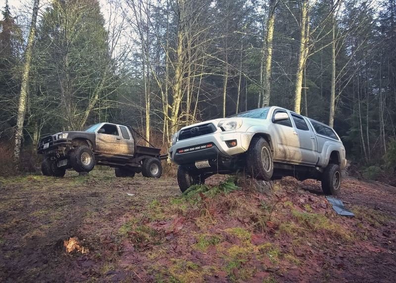

    6" body lift, LEDs errwhere, Jesus mural on the hood
    I have Icon extended travel coilovers in the front on my truck, set to a little over 2.5" of lift. Rear is an Icon AAL pack with Icon non-res shocks. Tires are 265/70/17 Hankook Dynapro ATM. I can keep up with my friends on 40" tires on their dedicated trail rigs (though I often have to go a little slower).
