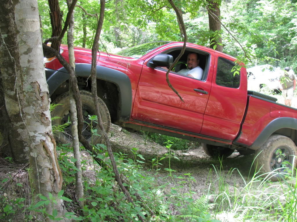

    I took my 2.7L access cab just about everywhere people did with their 4.0L TRD's on a meet. 90% of it is driver skill.
    I parked my truck on this hill with the rear bumper touching the ground. Got back in and started it up and went right up the trail.

    thats a neat picture:cool:
