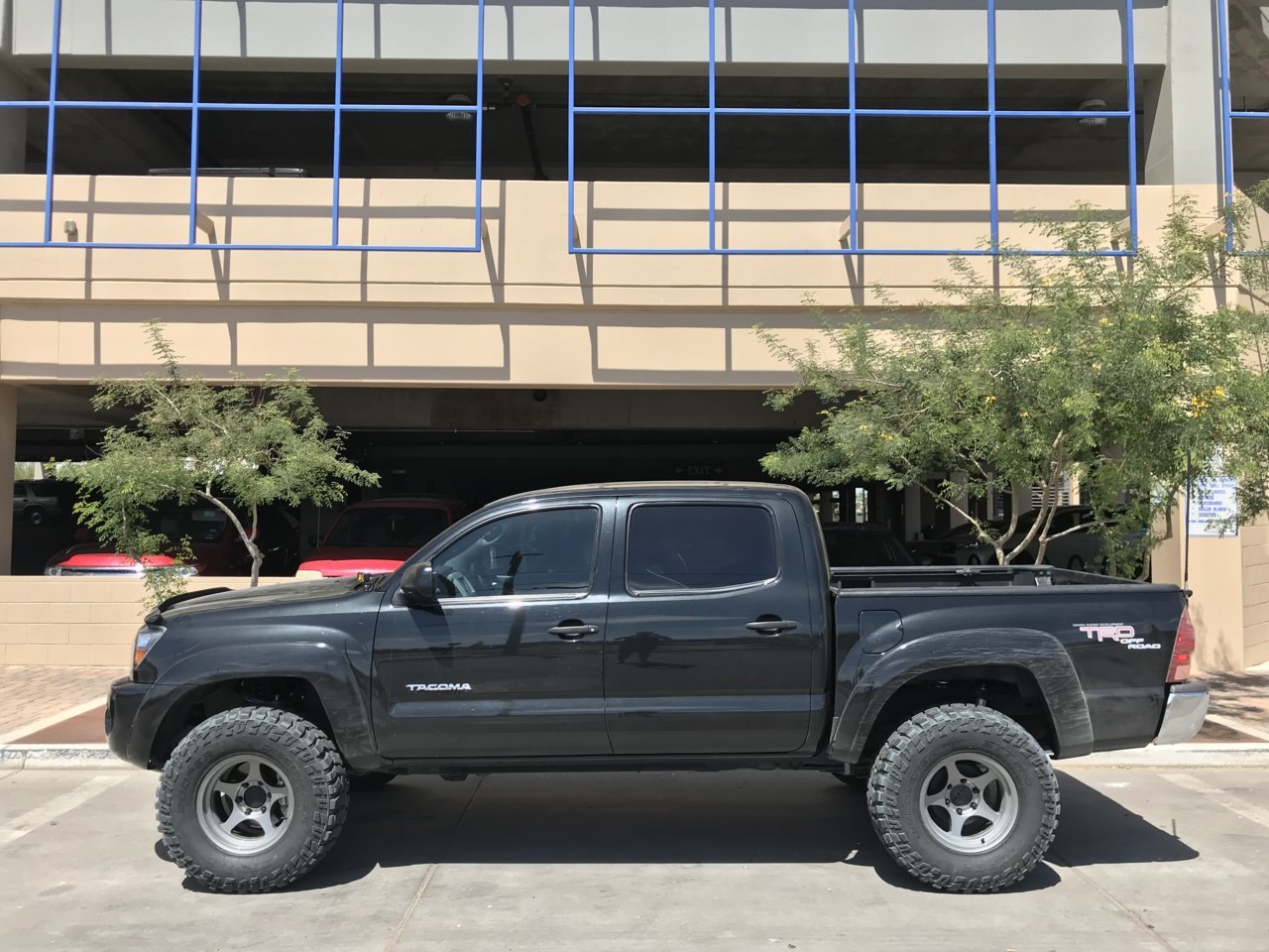

    Mine is my DD, I have a toddler & a Wife who ride in it with me regularly and I wheel moderate trails often. If you get a 2.5” lift and some proper off road tires >stock size you’ll fine you can go nearly anywhere without getting hung up as long as you know how to pick lines. My lift is humble.
    Front Bilstein 5100 shock with OME 885 lift coil & total chaos UCA.
    Rear is OME Dakar pack with extended 5125’s
    Decide what route you want to go with the truck, try to wheel or ride in/with other tacoma trucks who have different degree’s of lifts & make a decision and go for it. I bought my truck 10yrs old with 127k miles on it because I wanted to be able to get it banged up and not be too worried about it and I wanted to learn all about doing my own maintenance/mechanical work when possible.

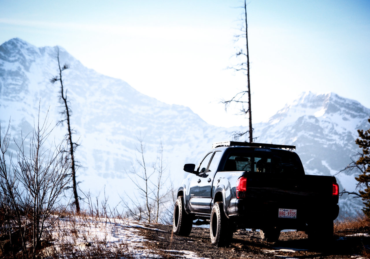

    Nothing worthy
    Just takes some skills!
    The places we've been, the obstacles we've overcome without so much as a scratch, no touching the undercarriage, no scratching a wheel, a few hits on the skid plate. It's our stock suspension daily that we like to keep looking good. Just take your time, don't go out of your comfort zone, know your limits and enjoy!!
