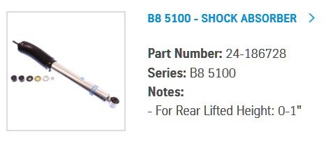

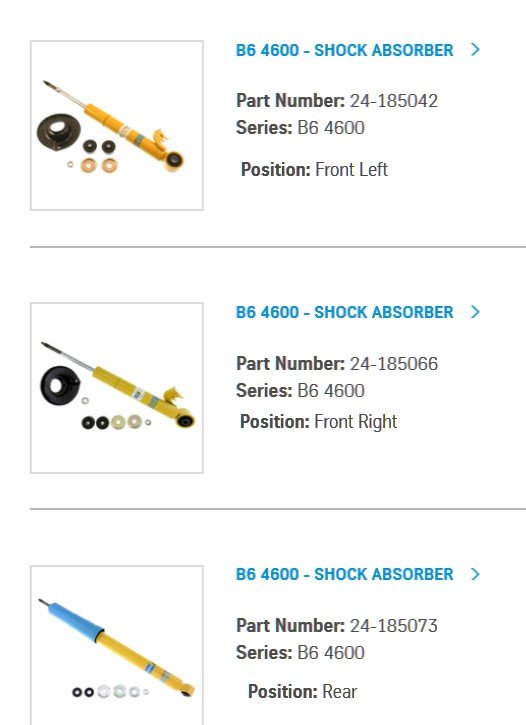

    4600s for stock height
    5100s if lifted (around $85 each)

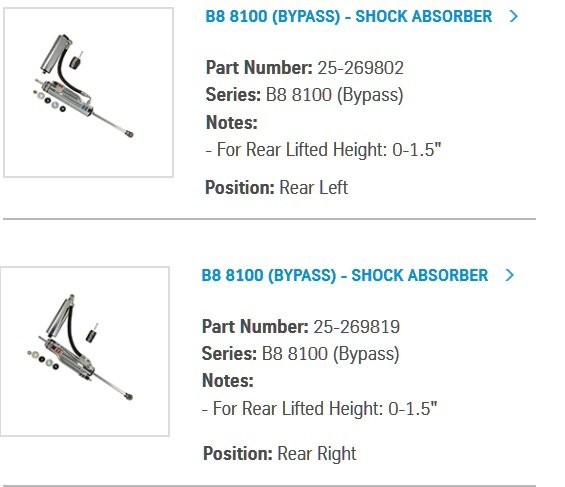

    Texas
    2007 FJ
    The 5160 run around $200 each and the 8100 $1K each

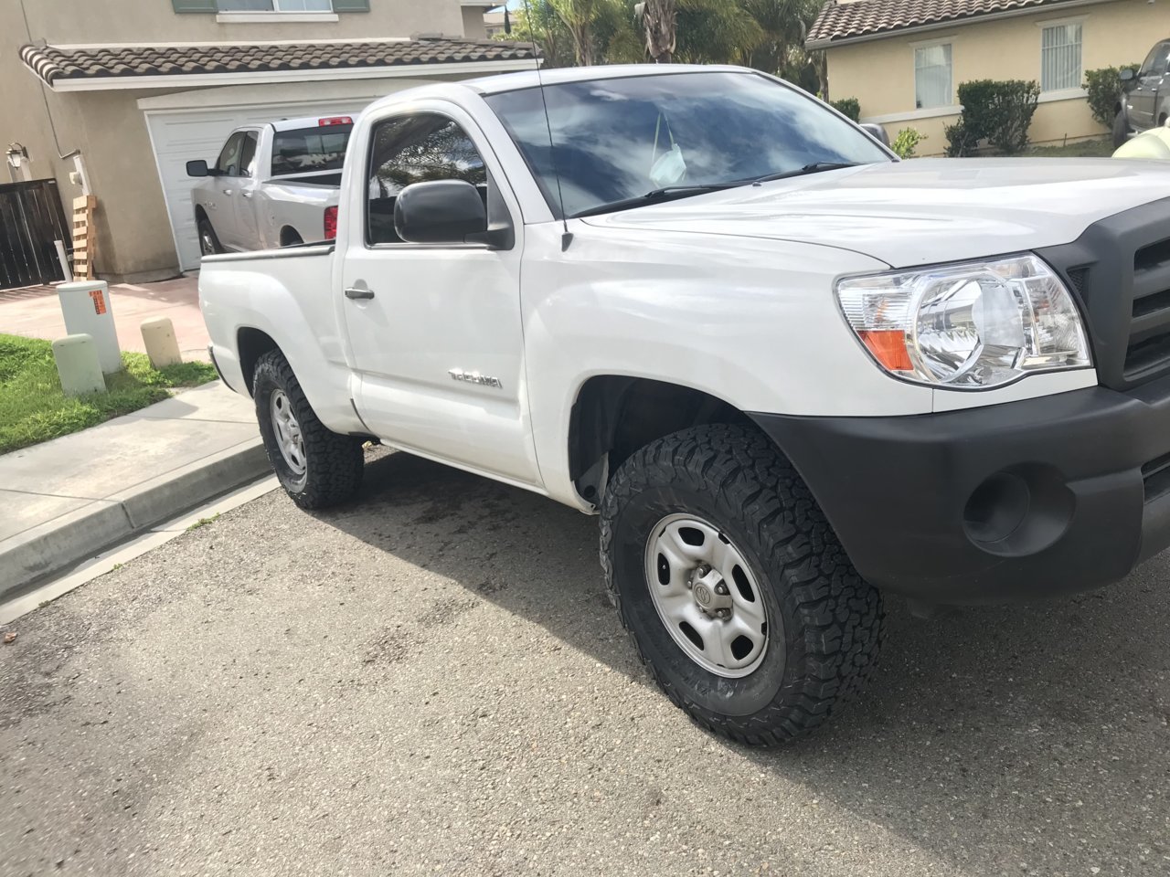

    173485D0-0991-43D4-8693-CDC833295781.jpg Just installed 3” Ebay spacer. I had 235/75/15 but wanted to go big or go home so went 31x10.50x15, love em! Rub on stock wheels a little bit but going to put on some Cragar soft 8’s 15x8 4.00 backspacing with -13 offset & that should solve the rubbing. (Thanks 5 lug fury) The rear is stock for now, installing the bilstein 4600’s in rear this weekend & replacing ball joints, inner & outer tie rods, sway bar end links & new bushing. Will send pics when done.
