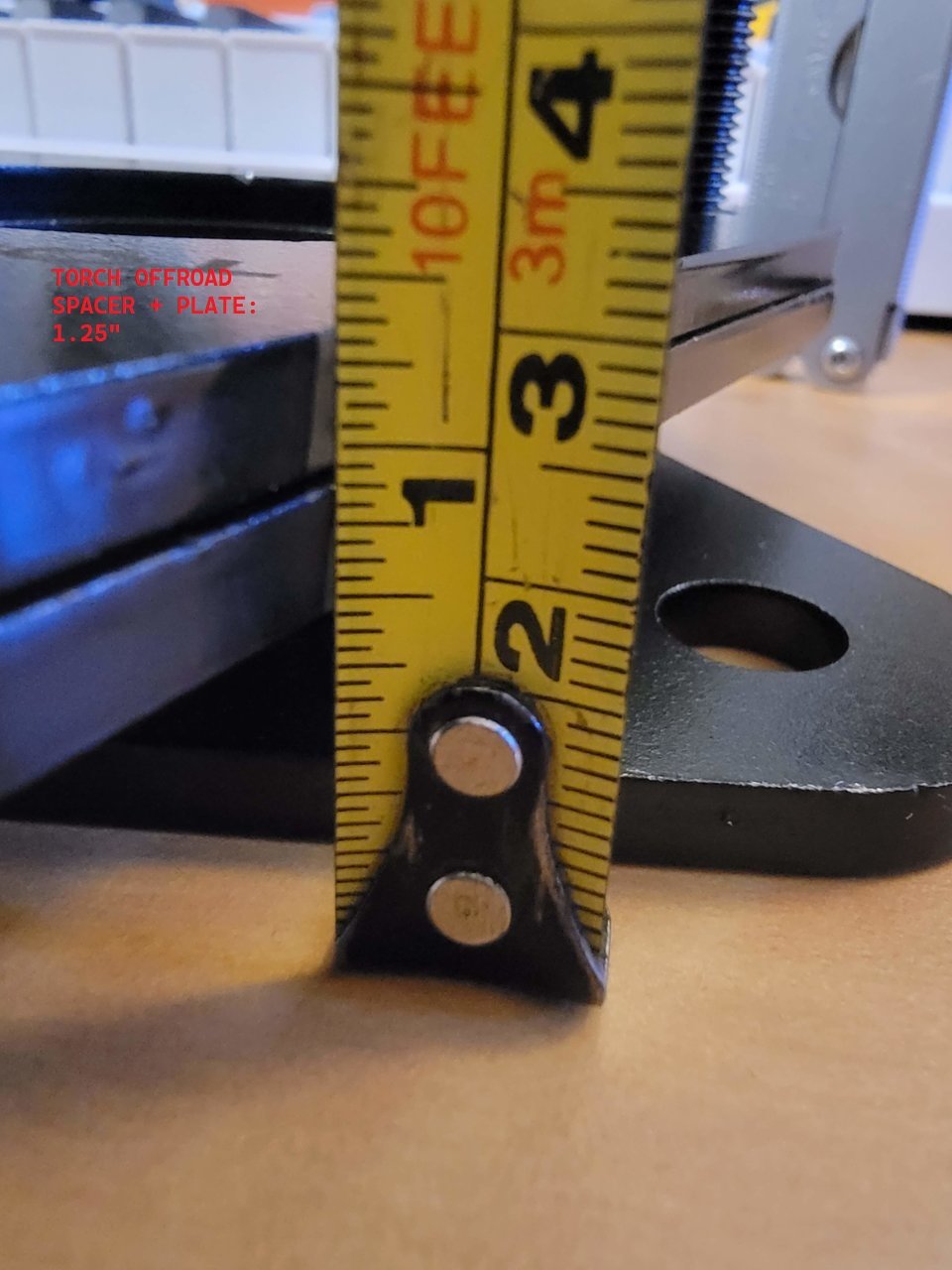

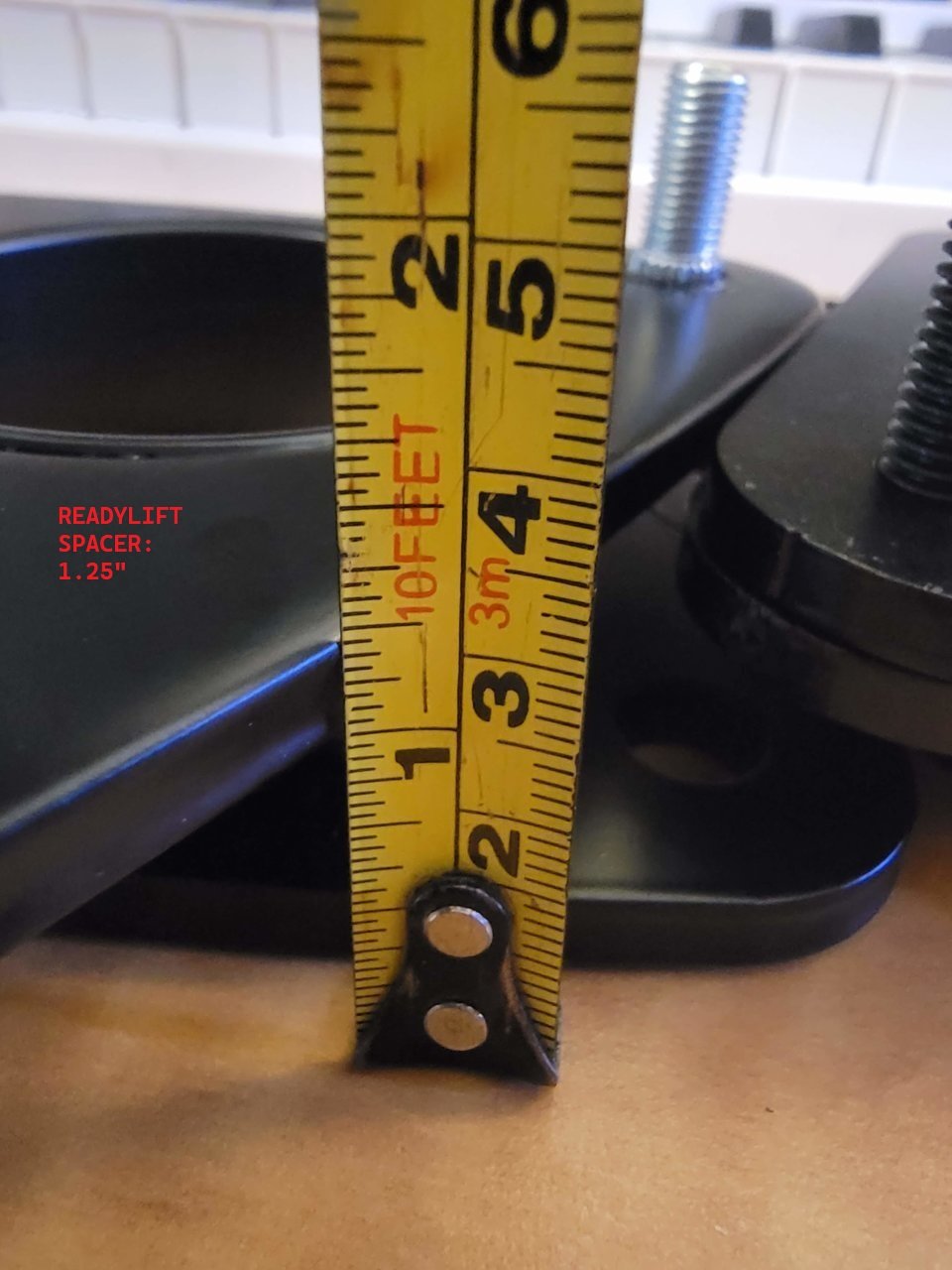

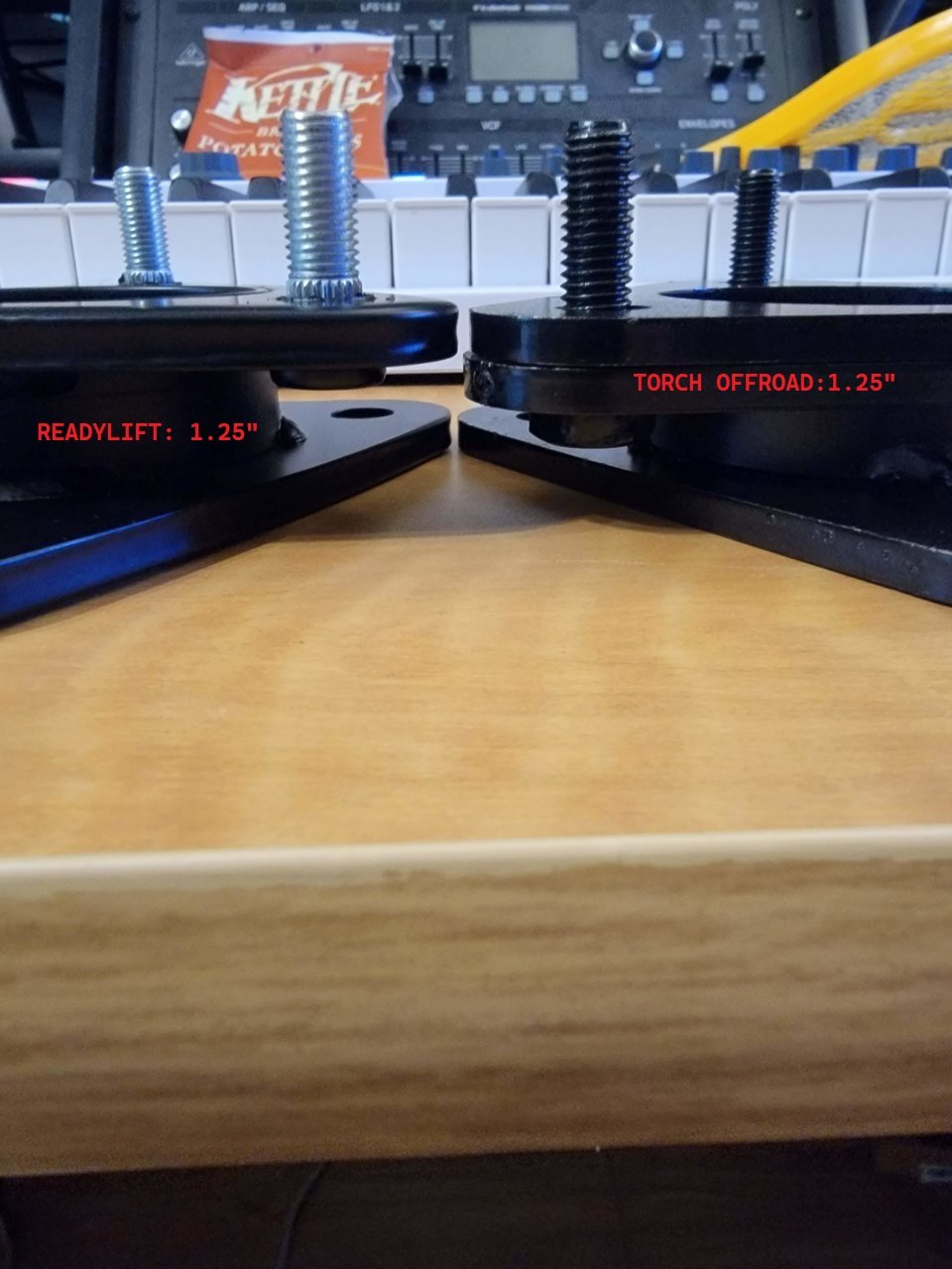

    I haven't seen anyone post about doing what I did, but I added a 1/4" plate made by Torch Offroad to the top of the Readylift Spacer for a teensy bit more lift. I gotta say, my alignment is pretty messed up. Camber and Toe are within spec, but Caster is about 3 degrees off. My workaround is Firestone's free lifetime alignments, but I'm scouring for TC UCAs.
    The point is, if anyone needs an additional, approximately 1/2" of lift, this is one way to get it!
    Overview:
    I didn't want to reuse my old springs so I bought replacement struts from FCS.
    I threw away the basic shock absorber they came with and kept the spring itself. Mounted the new spring onto the Bilstein 4600s.
    The Readylift spacer goes on top of the strut and then comes the additional spacer plate from Torch Offroad.
    To elaborate: Torch Off-road and Readylift offer the same sort of kit.
    The Readylift spacer is one piece, 1.25" tall, and advertises 2.75" of lift.
    The Torch Offroad spacer is two pieces, a 1" spacer, and a 1/4" plate to make up for the difference, and they also advertise 2.75" of lift.
    I bought BOTH spacer kits so that I could take the 1/4" plate from the Torch kit and add it to the slightly taller Readylift spacer.
    With this math, Each 1" of spacer adds *roughly* 2" of lift.
    This would mean that the additional 1/4" plate gives me an additional 1/2" of lift compared to just using the Readylift spacer on its own.
    Clearance with the UCA is very tight, but does not touch whatsoever.
    The tab for the brake line bracket on the 4600 touched my steering knuckles, likely because of the additional plate, but with a little percussive maintenance, you can bend it out of the way and nothing interferes!
    You can see the 1/4" plate on top of the spacer in the close up shot!

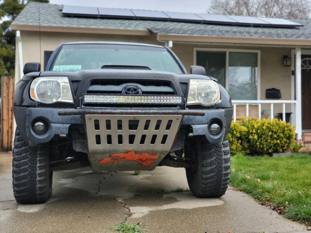

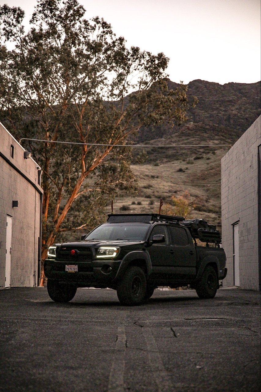

    In the past year or so, I've been on a handful of camping trips, involving 1000's of miles of highway driving fully loaded, and dozens if not hundreds of miles of fire roads. Here is my honest review of the setup:
    The front is a bit softer than I expected, but I think I still prefer it greatly over the stock handling. The alignment going out of wack after the slightest dirt road does get annoying, as I think I've gotten 5 or 6 alignments last year, but this is something I was prepared for.
    Personally, I do see myself dropping the money on a Coilover setup as soon as I get my hands on a TC UCA set because these 4600s don't seem quite enough for heavier loads.
    When I'm unloaded, they are wonderful and fun and hold everything nice and still.
    When I am loaded, it takes an extra "bob" of the front suspension to level out when coming to a stop if that makes sense.
    SumoSprings makes a "coil sumospring" that goes in between the wraps of the coils, so this may help as well, but I really only see myself needing to install them if I do go with proper coilovers.
    To install coilovers on the front end of our trucks, we have to cut off our bump stop, so the sumo spring going in the wraps of the coilspring is supposed to act as a progressive stop to slow the compression of the coil as it approaches full compression.
    The rear setup is just a Readylift AAL and 5100, and I am already looking for proper medium-duty leaf springs to offer a level ride when fully loaded with gear. Unloaded, you do get 2" of lift, but you quickly lose it with any kind of load in the bed, so Blue SumoSprings and Dobinson's Leafsprings are on the list to remedy this.
    The wider shots of the truck are sort of meant to give an idea of the rear sag when under load.
