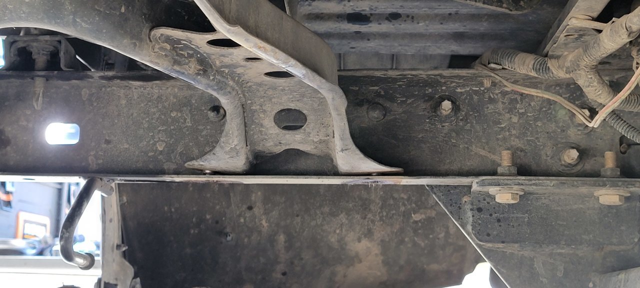

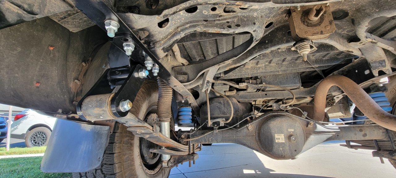

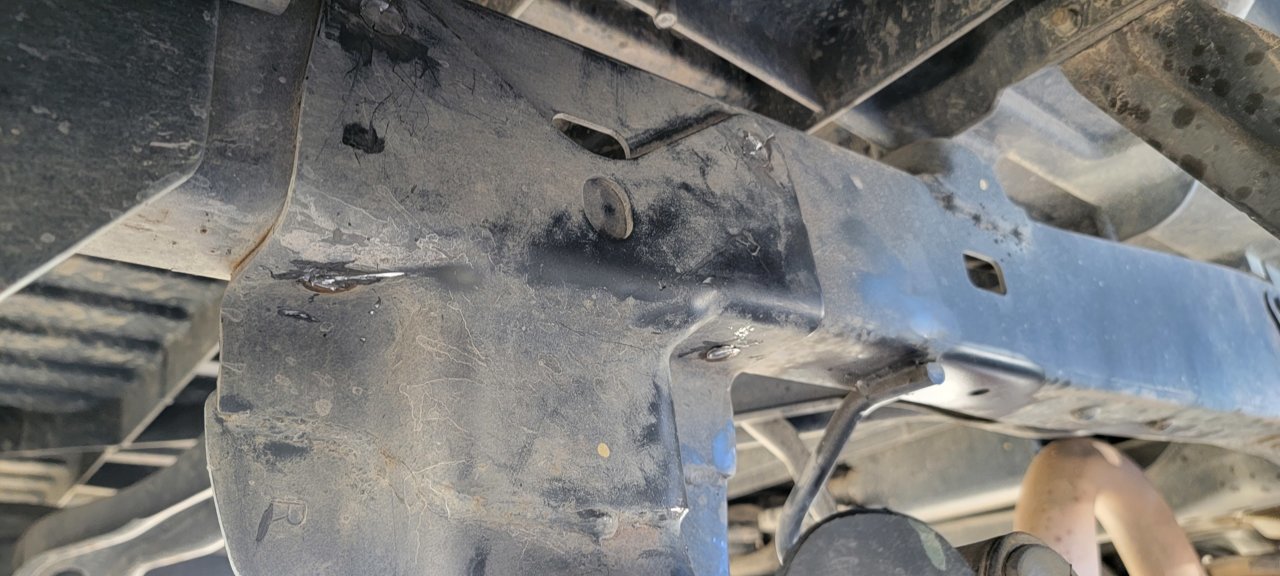

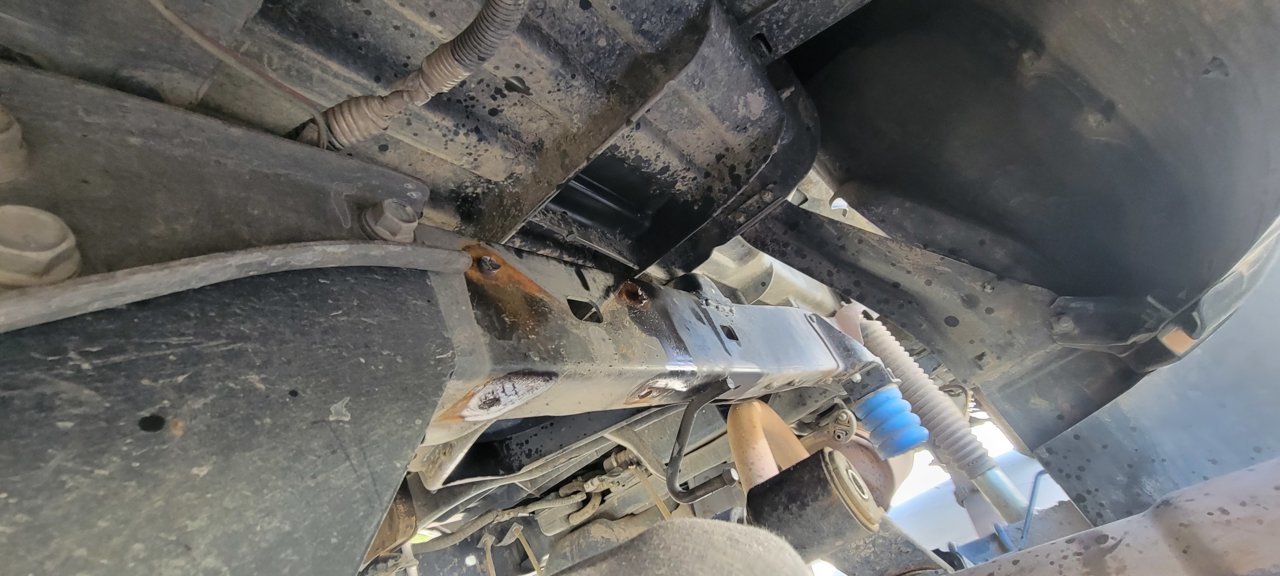

    Hey Everyone!
    I just did a Shackle Flip on my 5 lug and have some things to add/confirm for the discussion!
    I installed the @ARCHIVE Shackle Flip Kit https://archivegarage.com/explore-archive/ols/products/premiumtacomasfk
    on my 5-lug Dbl Cab and had success.
    Context/What was already installed:
    3" ReadyLift Spacer / Bilstein 4600 in the front
    1.5" ReadyLift AAL / Bilstein 5100 in the rear + 5-lug SumoSprings (Yes we have our own, vehicle-specific sumos!)
    Purchased the Shackle Flip with the EXTRA M12 Frame Bolts and Drill Bits.
    Install was a PITA (10hrs), but very straightforward
    I'm no leaf spring expert, but Tacomas have different LENGTHs of leaf springs which affect where the shackle hangers must be positioned for proper geometry.
    You get decent diagrams and references for which bracket position to use, but I immediately saw that since our SUA springs curve way more compared to 6-lug SOA, more forward bracket positioning is required, aka drilling the frame.
    For this reason, I was NOT able to use the 4 original rivet/bolt holes and had to drill 4 new holes in the frame, using the bracket as a guide for where to drill.
    I used the 4.75" Shackles, Brackets in the most forward possible position, and I got fantastic results.
    About 2" of lift compared to the before, goes down to about 1.5" of lift under load. Huge improvement over the slightly-squatted look I had with the AAL alone. The Slug is finally level with a few degrees of rake to account for squatting under load.

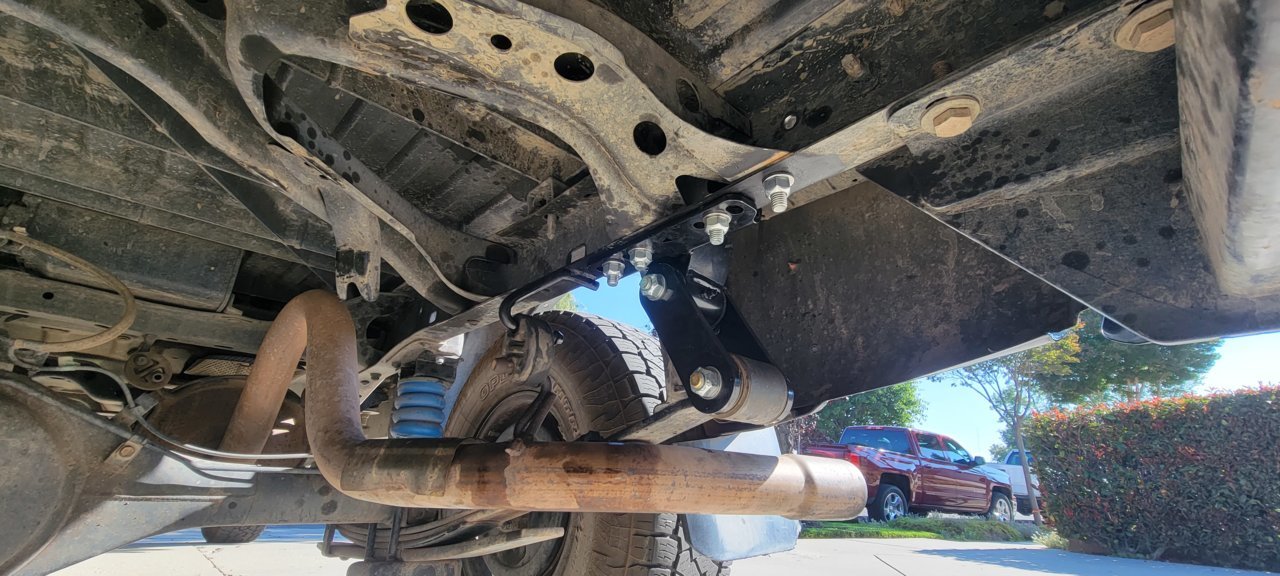

    IMPORTANT:
    Shocks:
    You will need longer shocks and brake lines to get the most out of these brackets. The 5100s came up about 2" too short to bolt into the lower shock points while at full droop. I've ordered Bilstein 5125s which should be the right length but I'll confirm when those come in. You can run the 5100s with the shackle flip but your shocks effectively serve as the limit straps and you do not want to bottom out your shocks this way or you can damage them. This is temporary until the longer shocks come in.
    Brake Lines:
    You will need longer brake lines for full droop. I had to unbolt my brake lines to install the shackle flip and could only bolt them back once the vehicle was under its own weight. Ideally you install the longer brake lines before you do this install, but as long as you don't go full droop, you won't put any more tension on them than there was before.
    To reiterate, under the 5100 stroke length, the stock brake lines are fine. At the new full droop, which is 2" lower than 5100s allow, you'll need longer shocks and brake lines.
    Noteworthy: My stock exhaust now touches the leaf springs at full droop, but only at full droop. Can be fixed by bending the exhaust hanger or cutting the exhaust. I've bent my hanger for now.

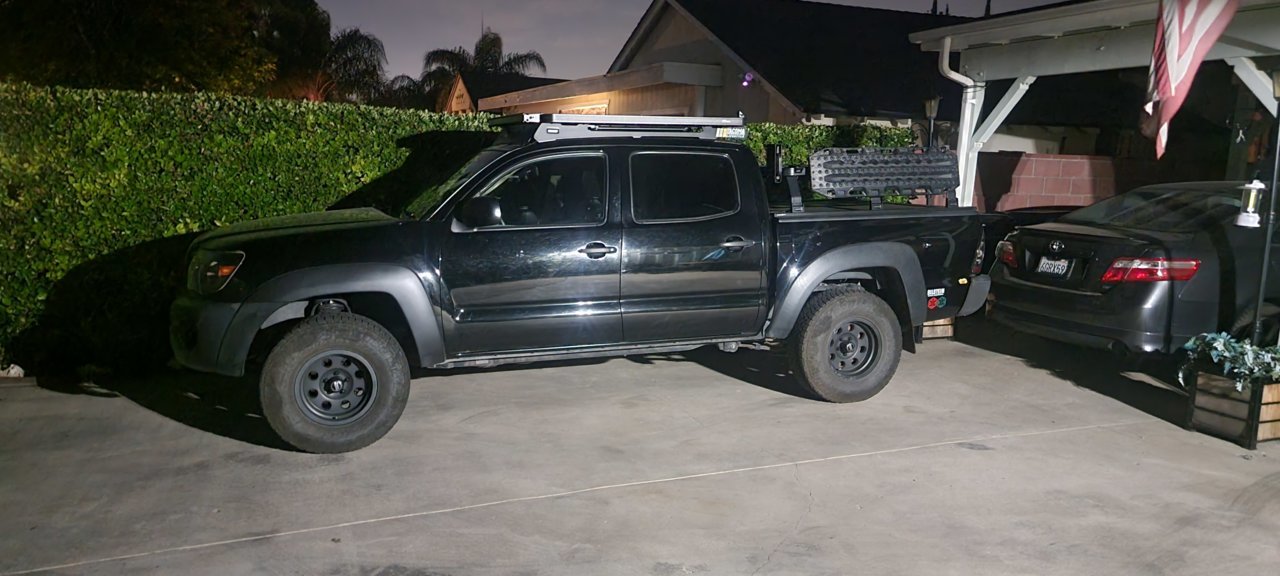

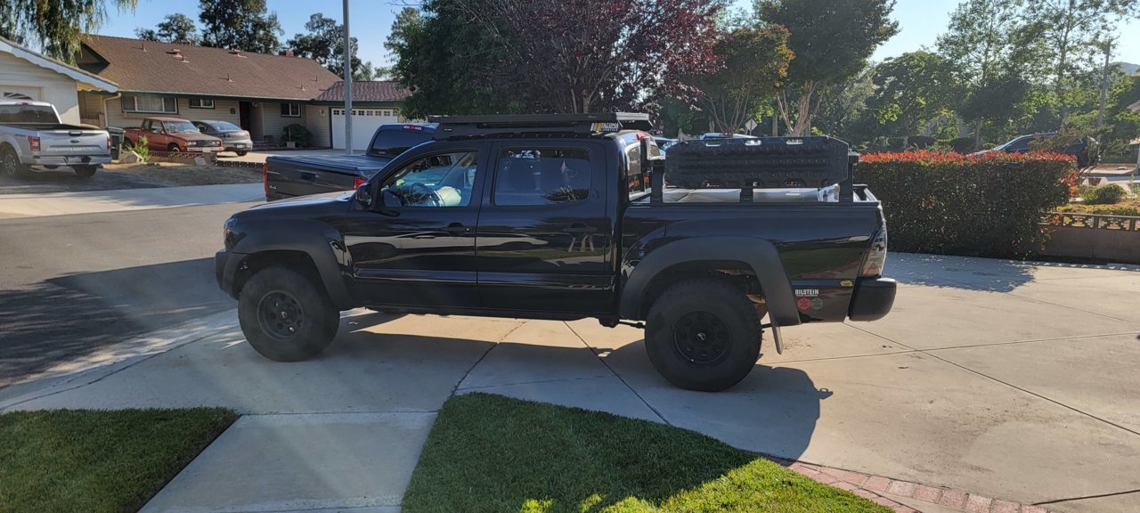

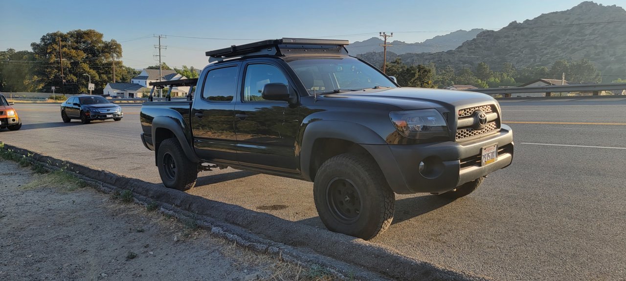

    Photos of truck! @5_Lug_Fury
    3" Spacer / Bilstein 4600
    1.5" AAL / Shackle Flip / Bilstein 5100
    TBD - Bilstein 5125 & Extended Brake Lines for full droop
    5 Lug Fury likes this.
