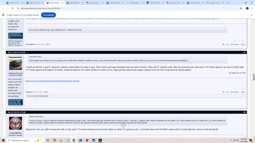

    when you say you made your own uca did you make one to match the total chaos? i got cash in hand if its possible to make another set? also im curios if anyone can help me understand this guys set up with the heim spacers? does that make it so you have more options of shocks to run up front since the icon shocks are discontinued? also anyone have any experience witht he sway away stuff? i was planning on doing the x runner disk break conversion with the red fj calipers and thought the red sway aways in the rear would look kinda cool too, some old reivews talking about surface rust but i shouldnt have much worries with that in so cal?

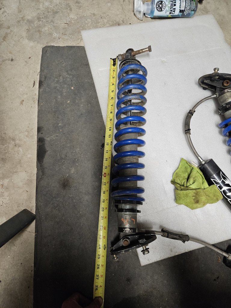

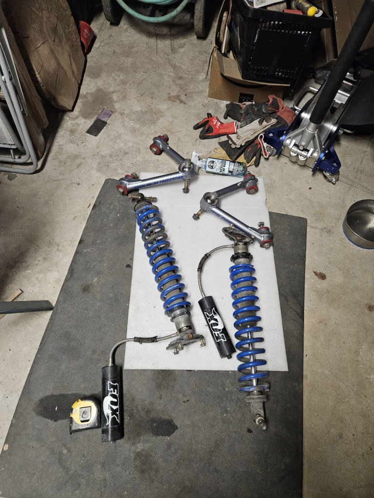

    Bought the mid travel arms and these fox coil overs but the coil overs seem big af. How big are the icons/sway aways that were used with this?

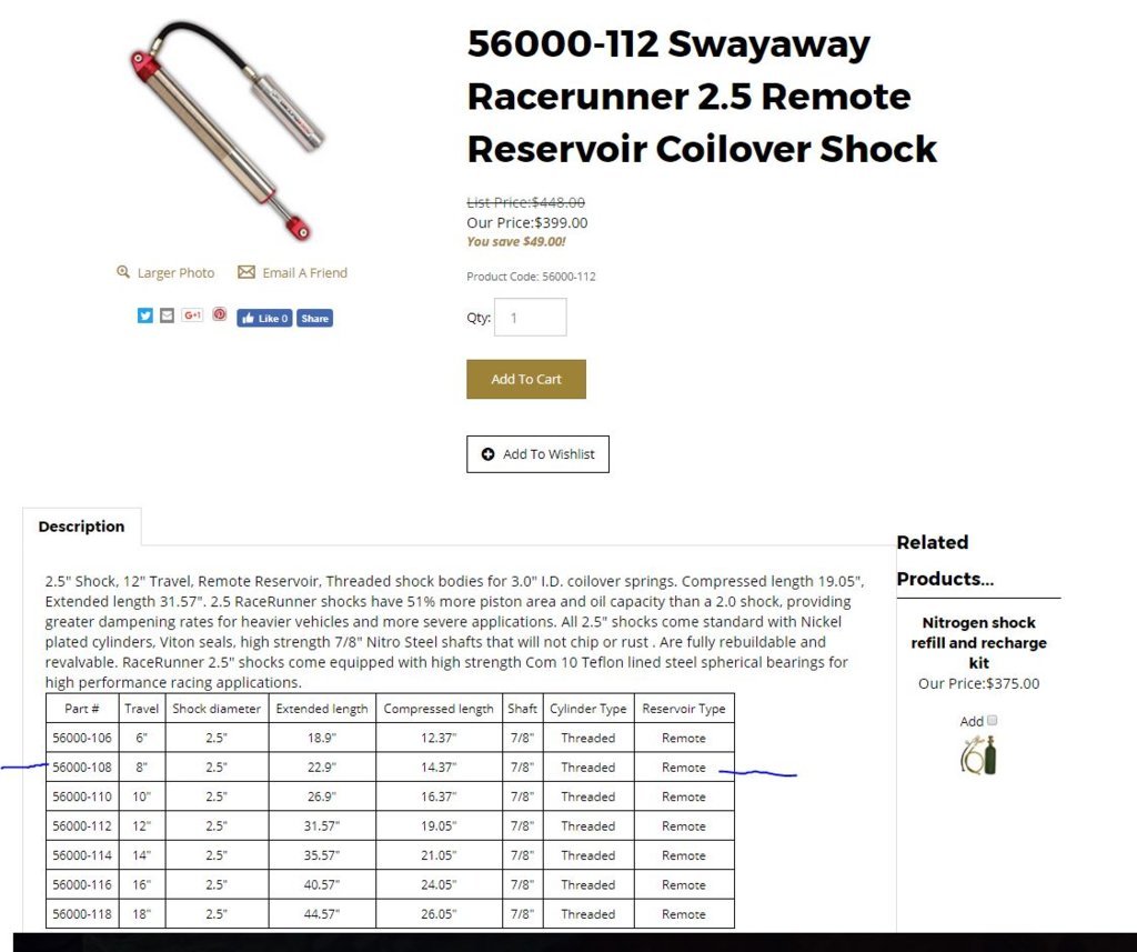

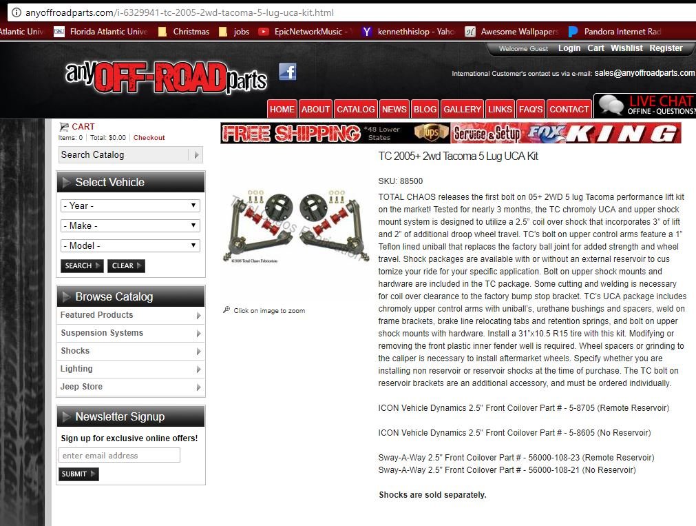

    Keep in mind not all 8" shocks are the same length. Gotta measure extended and compressed

    Oh shit it's the 8 inch for the mid travel? I thought it was the 6. Maybe these sucker's will fit
