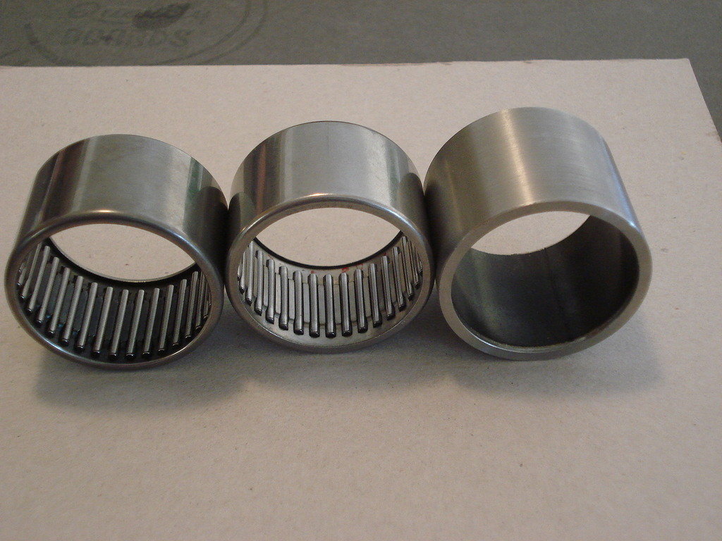

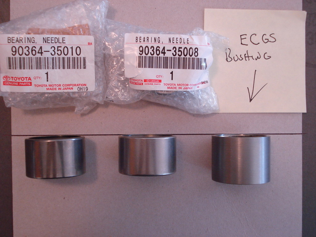

    Here's some good information for people finding this thread: taken from http://www.toyotanation.com/forum/6...front-differential-bearing-vibration-tsb.html
    "The New Toyota TSB
    After 10 years of production Toyota has finally issued a TSB. T-SB-0026-15, dated May 15, 2015 is applicable to 2005-2015 Tacomas, 2007-2014 FJ Cruisers and 2004-2015 4Runners. TSB's are not safety recalls but rather guidance documents intended to help their technicians identify problems. The TSB is attached to this post:
    https://www.tacomaworld.com/threads/...#post-10828880
    Comparison
    I took some pics of the old needle bearing, the TSB bearing, and the ECGS bushing. I also took some quick measurements and made a few observations:
    [​IMG] This image has been resized. Click this bar to view the full image.
    Report this image
    Report this image
    Left to Right: Old Needle Bearing, TSB Needle Bearing, ECGS Bushing
    Old Bearing - 90364-35010
    Manufacturer: Koyo
    Length: approx. 25.8 mm overall
    Number of Needles: 34
    Length of Needles: approx. 19.8 mm
    Material: the cage is a seamless dark gray steel similar in appearance to spring steel. The outside housing appears to be a chrome steel.
    Comments: IIRC the one I originally removed had a plastic cage. I no longer have it to confirm. Otherwise I still have several purchased in 2011 that have the dark gray steel cages.
    New TSB Bearing - 90364-35008
    Manufacturer: Nachi
    Length of Needles: approx. 18.5 mm
    Material: the cage is steel similar in appearance to either a chrome steel or stainless and has a seam. The seam is micro-welded. The outside housing appears to be a chrome steel.
    Comments: It is curious that there is a new manufacturer and that the needles are actually shorter than the previous needle bearing. Also, the cage the needles ride in appears to be a different kind of steel than the previous.
    There is no history of durability of this part yet.
    ECGS Bushing - T8CS-Bushing
    Manufacturer: unknown
    Length: approx. 31.1 mm overall
    Length of Bushing Contact Surface with the CV Journal: approx. 28.5 mm.
    Material: sintered bronze with PTFE layer in a steel housing. A special tool for removal of the old needle bearing without removal of the differential was also developed.
    Comments: How durable is the bushing? This question has been in the back of my mind since doing the replacement. ECGS claims it to be the life of the truck. FWIW, as of mid-Sept., 2015, this person, screen name
    qynla, states he has >100,000 miles since installation without issue
    https://www.tacomaworld.com/threads/...#post-10716509
    I had been periodically monitoring mine with a dial gauge. It had developed some initial looseness between the bushing and journal on the CV shaft as the two "broke in" but it seems to have stabilized and I quit monitoring after about 18,000 mi. IIRC when I sold the truck.
    Is There a Needle Bearing on the New Trucks Too?? - The Parts Catalog
    Yes, sadly. A dealer was kind enough to allow me to peruse what exists of the parts catalog for the new trucks. As of a few days ago the manual for the new trucks was clearly preliminary and appeared to be in a sort of "Draft" form. I can only state what I believe the part number is as this information is subject to change when new info. becomes available.
    Also, it does not appear that the old needle bearing has gone away at all and you can still end up with the thing. The TSB assigns our old crummy needle bearing to the 4Runners, and the Tacoma and FJ Cruisers get the new part number...well, kind of...
    It is true that the TSB gives a new part number (90364-35008) but in the PNC parts catalog I saw one is given a choice of either a Type 'A' and Type 'B' bearing. This has been done before when there were more than one supplier for a particular part. For example, up until about 2013 the 2nd Generation manual transmission trucks had either Type 'A' (Luk) or Type 'B' (Aisin)clutches installed during production and for replacement parts. So the types could be different suppliers and different designs.
    In terms of the new trucks I suspect the new part is probably the TSB bearing. But Toy has been caught before not putting TSB parts in production runs. A good example of this is the infamous upper intermediate steering shaft where the old crummy part is still being installed during production five years later. One has to ask for an upgraded one by TSB part number in order to get it."
    TSB:
