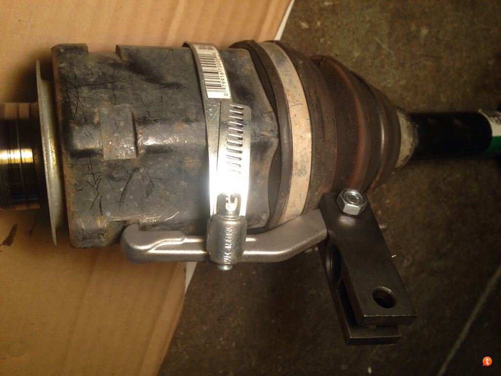

    I used a slide hammer to make quick work of the CV removal. Popped right out (picture of claw attachment method below)

    1) I thought I could use the pry bar method to get the CV out, but after using two different pry bars I resorted to the slide hammer method, and that worked fine.

    The prybar method to remove the CV works easy, you need to find the sweet spot though. Try turning the shaft and trying again. Next time. It pops right out if you have it right. Also I would recommend a driver tool and not a socket for the bushing. I ended up scoring the inner surface of the bushing with the leading edge of the socket.
