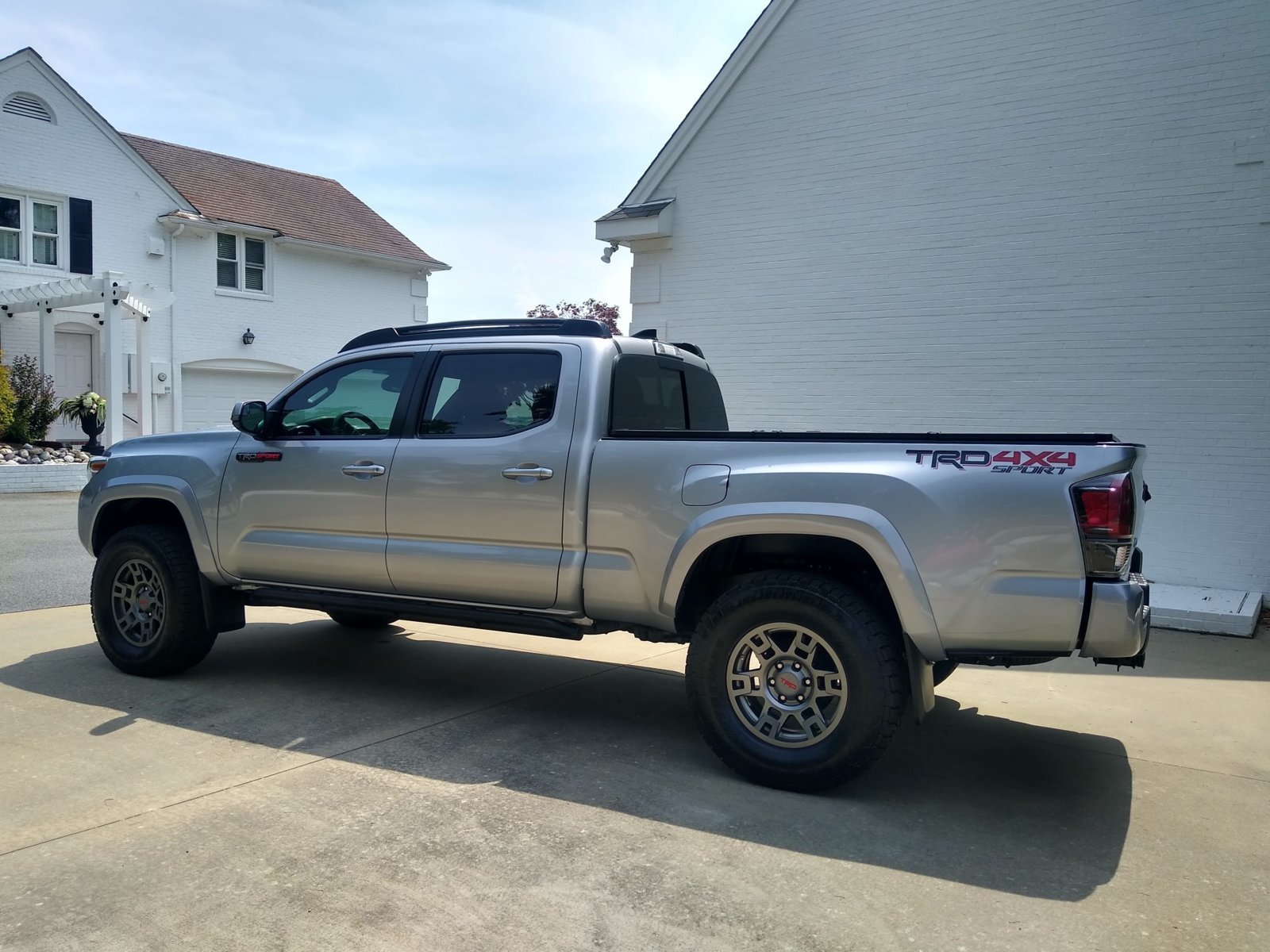

    Can you post a photo of the truck from the side? maybe some photos of the front tire/wheel well so I can see how the proportions look with the 285's on the 5100 set up?

    Bilsteins 5100s on the top setting, 4runner Gray TRD Pro Sema wheels, 285/70/17 Toyo AT3s, Sumo Bump stops, TRD exhaust, ECGS Clamshell bushing, 1/4 shim for the lean and one inch rear block, OEM Pro grill and garnish OEM TRD Skid plate, TRD CAI, Demon Brackets, Rigid Industries Pro fog lights, OEM Trail Rails sidebars, Diode Dynamics LED SL1 high and low beam lights, OEM Roof racks, Clazzio leather heated seats, Remote Start, TRD Pro shift knob, tinted windows, Rockford Fosgate 4 channel amp for the headunit and sub and amp combo, OEM Puddle lights, OEM tailgate lock, OEM bed mat, LED interior lights, OEM blackout kit for letters, JLT catch can, upgraded 27F toyota True Start battery, Vleds led tail light kit with Pro tail lights, OEM Rave4 side mirrors with convex spotters,just to name a few mods.

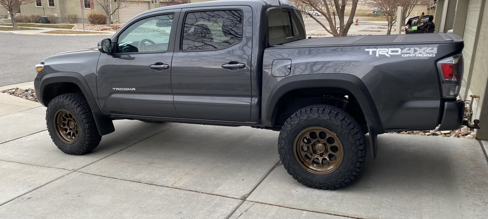

    I will report back mid week, 2017 OR replacing leveling kit with 6112/5160 set for 2' up front and 275/70/17 KO'2s . I currently have the SEMA 17x7 +4 wheels/on 265/70/17 KO'2s as well as 1.25 spacers and no mud guards. I would like to keep the spacers if possible , my hope is that I only need to trim the small 1x1 or so plastic on the back side of the front wheel wells. Fingers crossed.

    3” OME lift, 275/70/17 BFG KO2s on scs blaze 10s -10 offset.

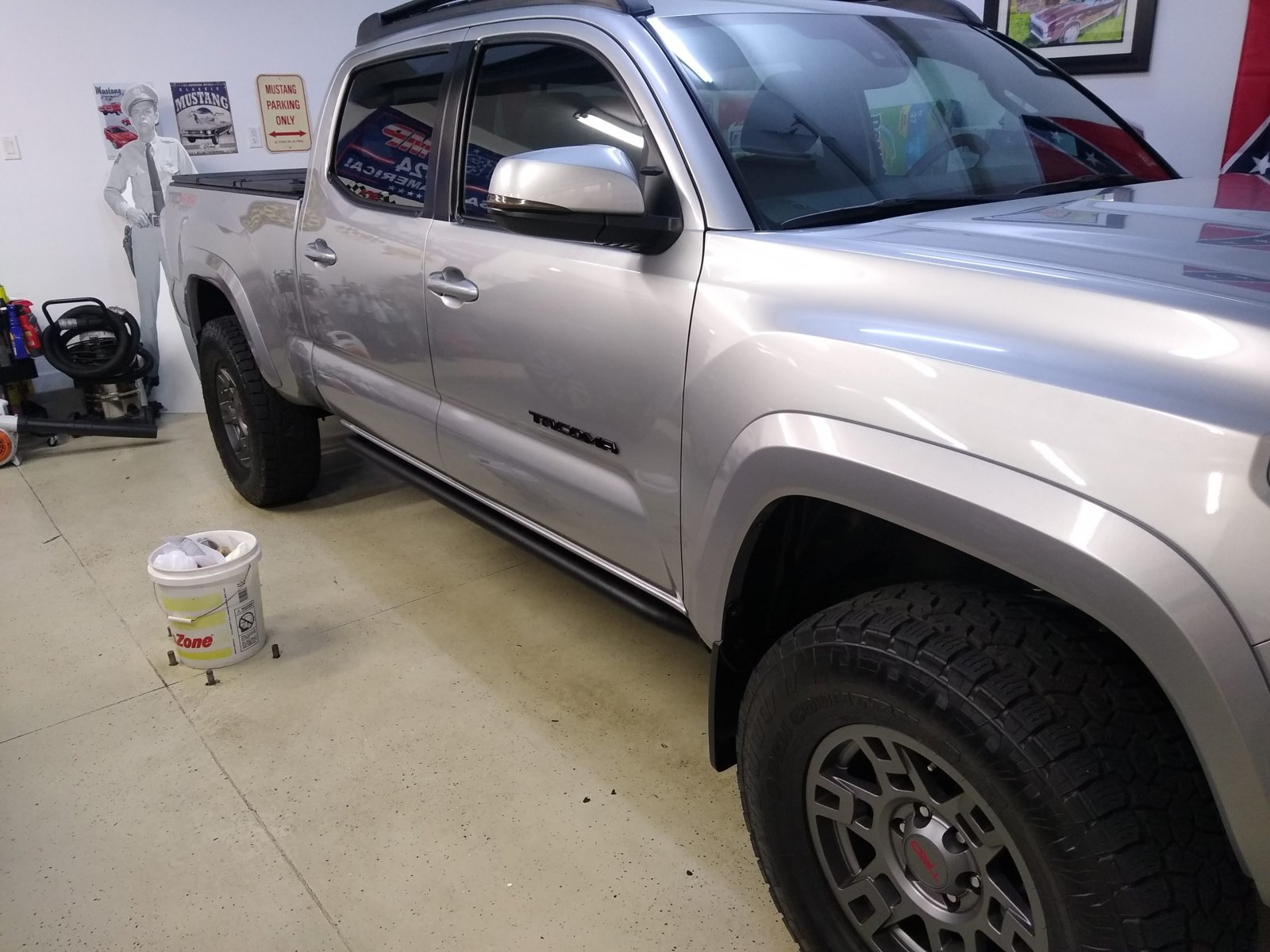

    Looking to have Eibach stage 1 lift installed, 1st clip, 2” front lift, 1” rear block. Will 275/70/17 fit with no rubbing?

    I run the TRD lift kit, which is about the same and I have had zero issues.

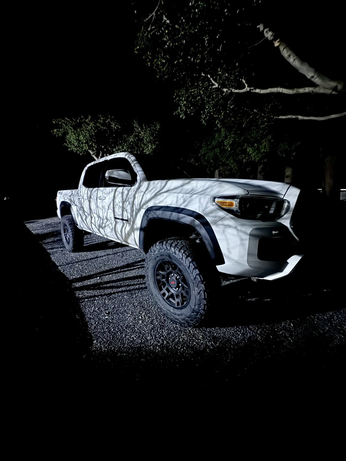

    6112/5160-275/70/17
    Verdict, no rub with or without spacers. Left them on since I think it just looks better..
    Super stoked how everything turned out.

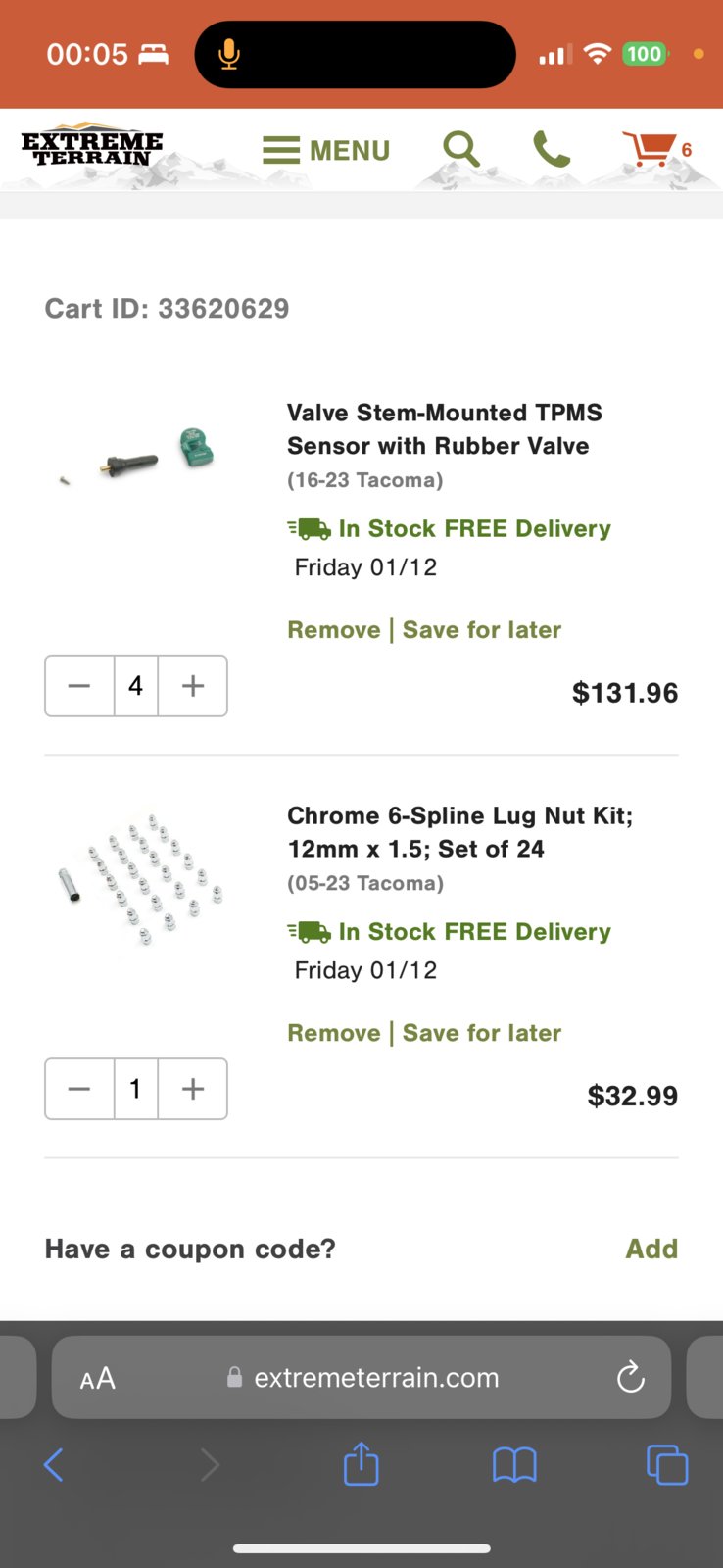

    Well I finally pulled the trigger on the 17x7 SEMA wheels from BAM Wholesale.
    Part # PTR20-35110-BK Toyota 17" TRD PRO Wheels OEM Matte Black for 4Runner FJ Cruiser
    I’m planning on just storing my old tires and wheels for now. So I need tpms sensors and new lug nuts? When I was looking at the same part number wheel on extreme terrain they suggested I purchase lug nuts, is that correct?
    I’ve uploaded the picture of my cart on extreme terrain, are those the right sensors and lugs?
    Lastly, what tires do I put on em? I’m thinking 275/70/17’s obviously. I had wild peaks on my diesel Silverado and loved em, but even in C rated they are heavy in their sizes. I’m looking at Toyo open country at3’s or the RT trail, since they are lighter and have a longer warranty. I know the mpgs are going to drop, since the wheel and tires I am about to put on it weigh a lot more thank stock. But does 5-8 lbs per tire make any noticeable difference, if any? What other tire suggestions do you guys have for a 275? I can’t make up my mind.

    Get black lug nuts......

    So the stock lug nuts will not work with this wheel, correct?

    I'm pretty sure the stock lugnuts will work.

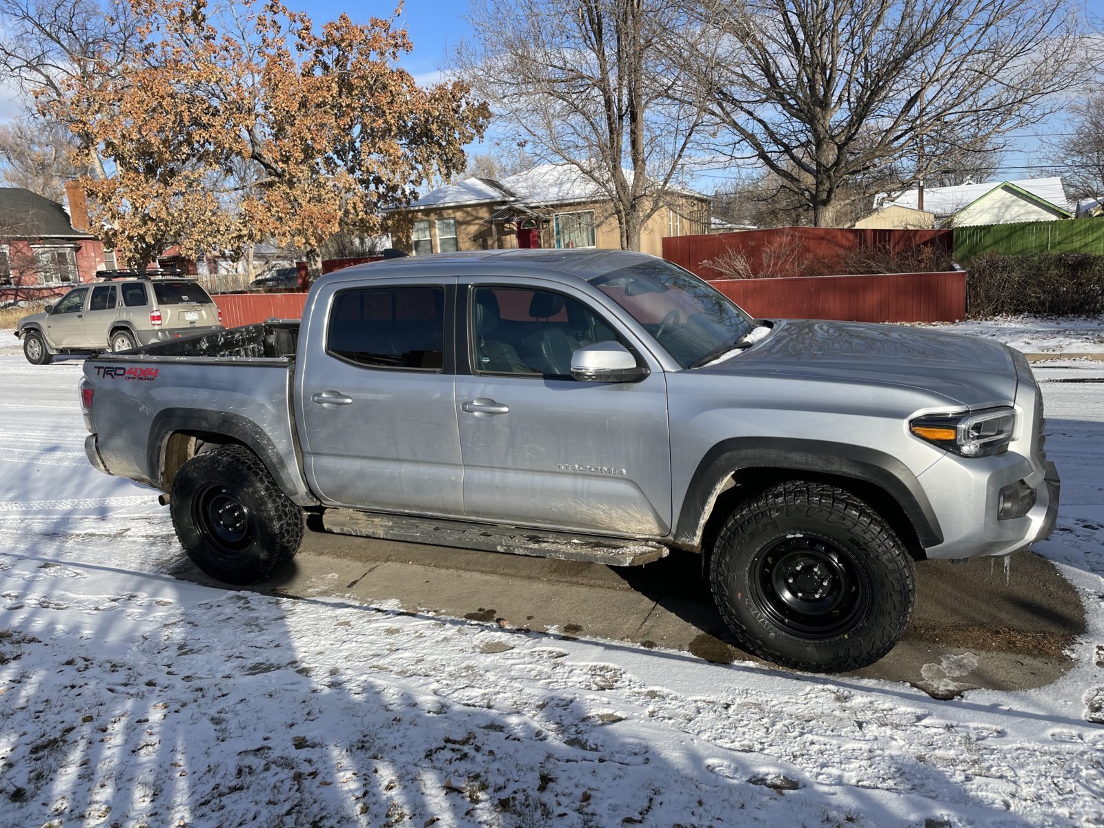

    I killed one of the original factory tires which gave me the excuse to get what I really wanted.
    Wildpeak AT3W 275/70R17 on FJ steelies. With the +15 mm offset they fit with plenty of room without a lift. No rubbing at all.
