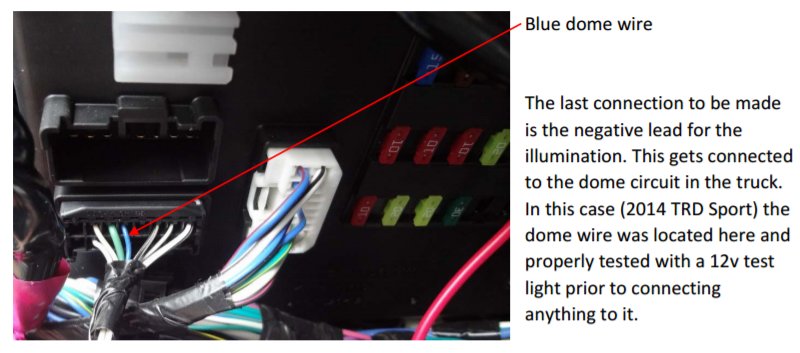

    I'm going to use an add a fuse from the fuse box and then connect to the variable ground for the interior lights near the fuse panel. Don't quote me on this but I believe it's a blue wire. I'll be doing some tests with a multi meter tonight. My harness from Jaimes will be here sometime next week I think. PM me if you have any questions one you get into it.

    You win which actually means you loose haha. I just confirmed the wire for the puddle lights too. They just need 12v and ground here.blue wire.jpg

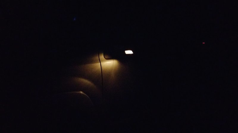

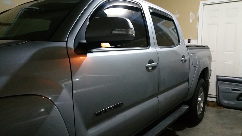

    Here's some teaser pics. This was with a 9v battery and yes I'll be using LEDs.
