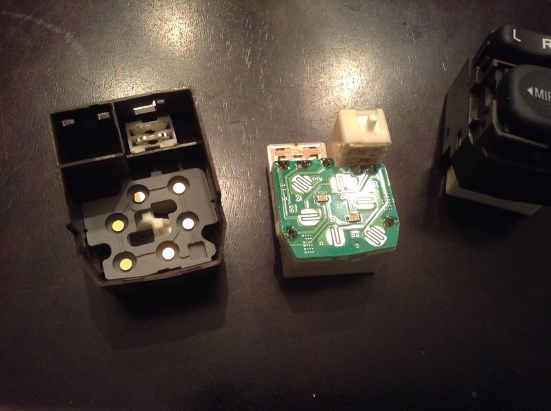

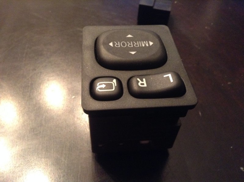

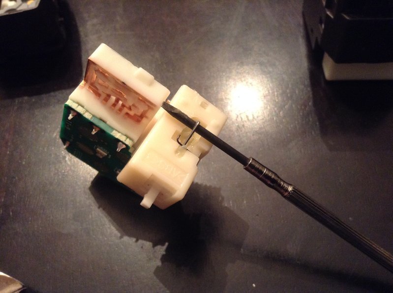

    The switch as received from Toyota are latching design (stays in when button is pushed) and ideally what you want is to convert it to a momentary push button. Below shows the button latched down.

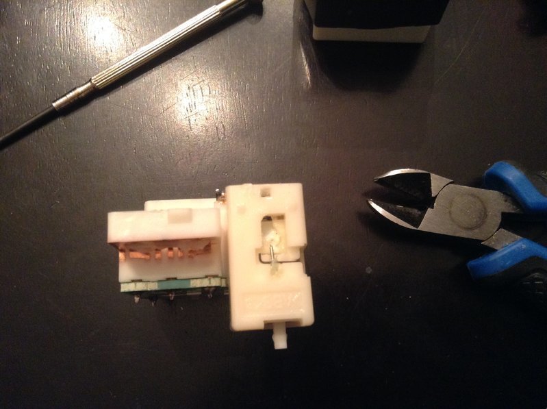

    To convert it you need to pull the switch apart and the pic below shows a mini steel rod that needs to be snipped out. That rod allows the switch to latch.
    After cutting it below. Switch can no longer latch and is now a momentary push button.
    When putting it back together see the rubber pad with round metal circles below. It is important that does not get jostled out of position when putting the switch back together. If it does all of your mirror adjustments may not work properly and you will need to pull the switch apart and reseat it.

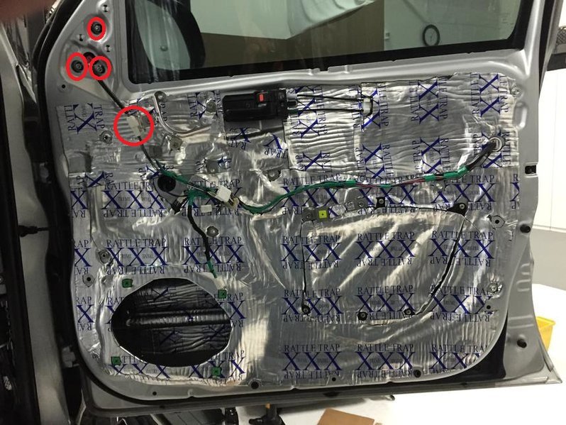

    You need to remove your factory Tacoma mirrors. You will need to remove the door panels to do this. Here is good door panel removal video. Once the door panel is removed unplug the mirror and remove the three 10mm bolts where that triangle piece was. Hold the mirror while removing these as it is all holding it to the door.
    Once they all are removed gently pull the mirror away from the vehicle and that's it. Repeat on the other side.

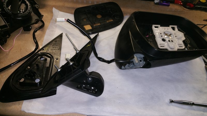

    First we'll be pretty much gutting the aftermarket mirror. All we're after is the mirror housing itself and a few electrical connectors. Start by cutting the plug off the end of the 4runner mirror close to the plug.

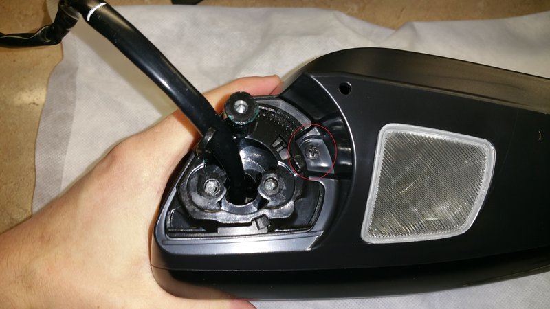

    Then pry off this cover on the underside of the mirror.

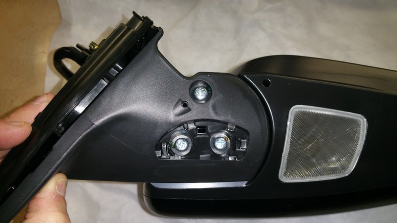

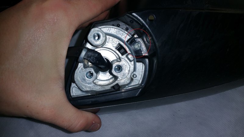

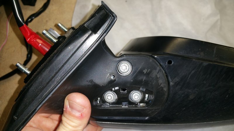

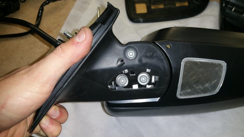

    Then you'll see these three screws. Remove all of them. The arm should then separate from the mirror.
    Remove this screw also.
    Next gently pull off the 4runner mirror glass. In all honesty you don't need it anyway so if it brakes no worries. Just don't break the main "shell" of the mirror.

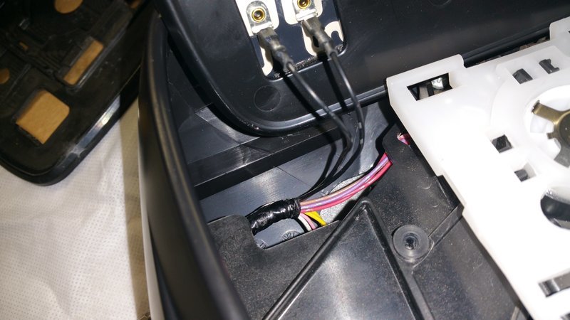

    Unplug the heating element connectors from the back of the glass. Be careful here because we'll be reusing those connectors.
    Next remove these two screws holding the motor mount in place. Then wiggle the entire assembly out of the housing.

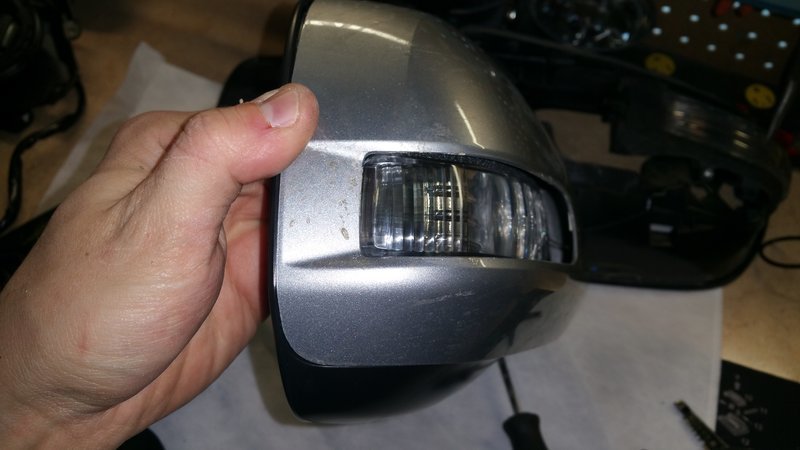

    Unplug the blinker and remove the puddle lamp bulb by pulling up. Just take the bulb out of the housing.

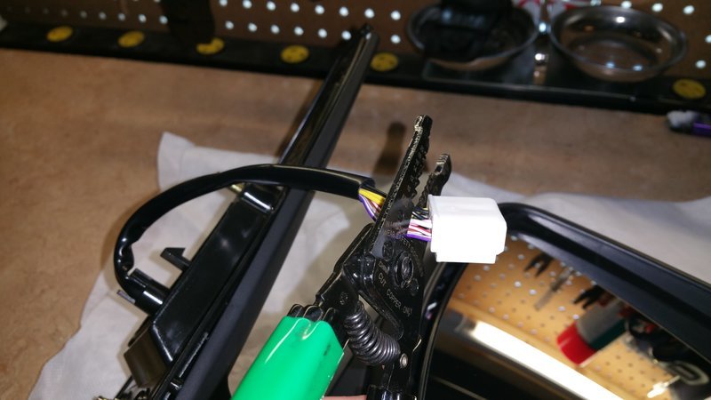

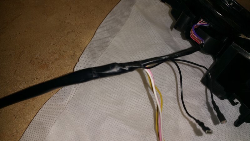

    Remove the tape a the top of the 4runner harness. We need the yellow and black wires from this. Do not cut the yellow or black wires to remove them.

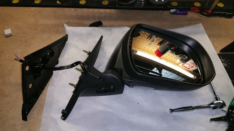

    Now if you have and want to swap the painted mirror cover on the front, now is the time to do it. I have a 2015 Tacoma TRD sport and my mirror covers were a perfect swap. This avoids a costly trip to the paint shop. If you are going to swap covers gently pry all the tabs to free the cover. There is 8 of them. After this be careful while working on it as not to scratch the paint on the cover you're going to use.
    Once the cover is removed set everything aftermarket aside and grab your factory mirror. Start by prying off the same cover on the bottom of the mirror.

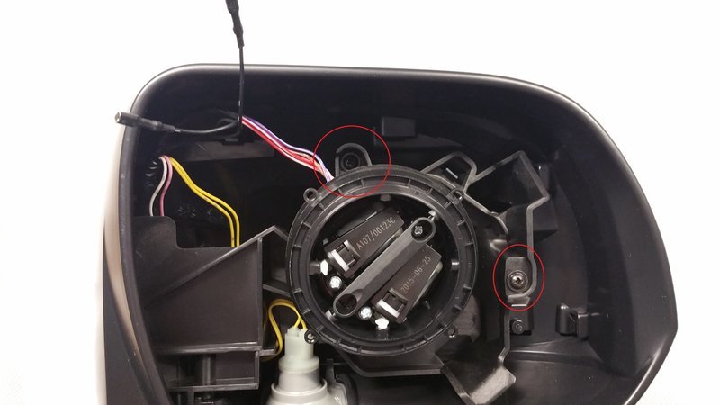

    Then remove these three screws.
    Also remove this red tape and this screw holding in the rubber seal.

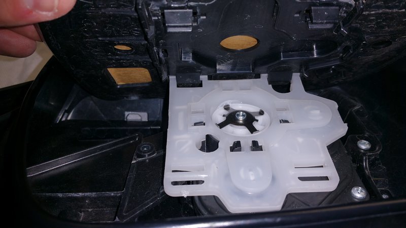

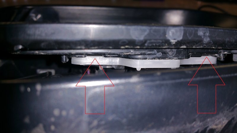

    Then push on the top of the mirror until it doesn't push anymore. You can then see underneath the mirror and put a flat head underneath it to pry it from the motor.
    Then tilt the mirror back down without locking it back in place. The mirror will rotate up and out of the housing.

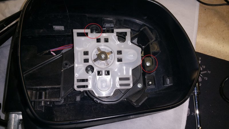

    Remove the two screws holding in the motor housing.

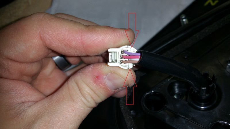

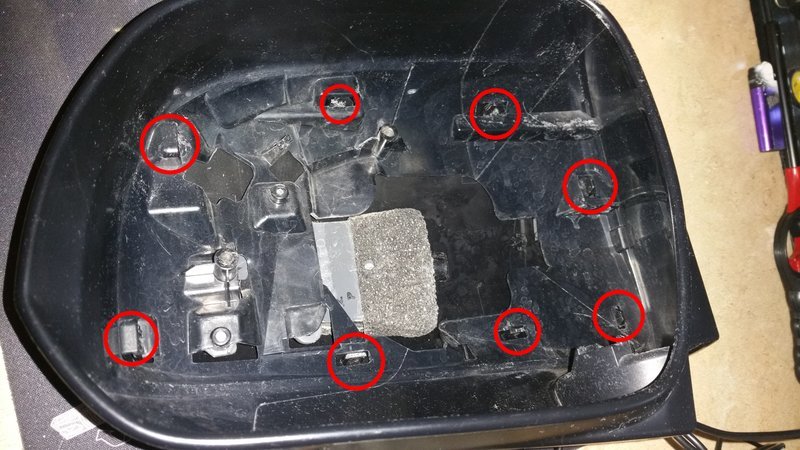

    Remove this screw and slide the casing off of the connector. Do this by prying where the arrows are. You should be able to see how it latches to it.

    Now run the yellow and black wires through the same harness as the factory Tacoma wires. Make sure the bulb and connectors for the heated mirror are with the blinker plug end.
    Once the wires are through replace the tape at the top.

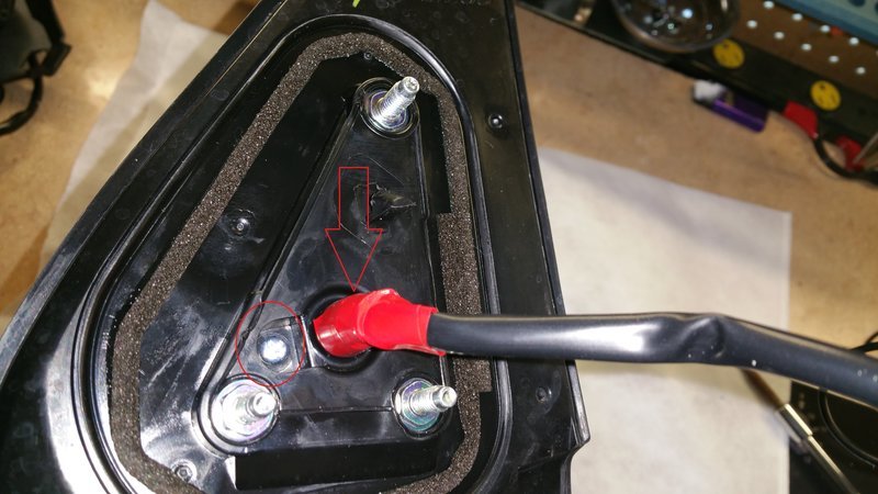

    Run the harness through the mounting arm and the rubber panel. Also put this screw back in said rubber panel.

    Put the screws back in that hold the mirror to the arm and replace the cover.

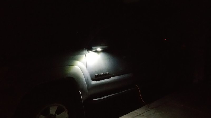

    20161215_152747.jpg 20161215_183724.jpg 20161215_183737.jpg 20161215_183801.jpg

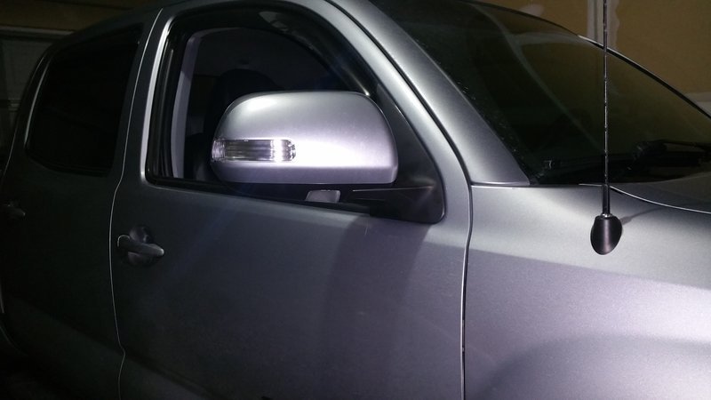

    Other then the heat and the puddle light, how do the mirrors look physically different? Having a issue finding before-after photos.

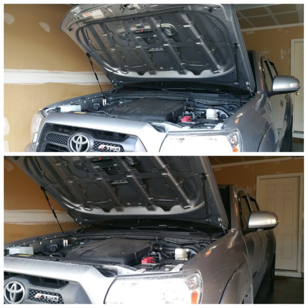

    I'll post a picture in just a minute. I don't think I'll have a good before picture though. The mirror is physically the same exact size. That's what makes this mod so easy. I didn't need painted covers because my Tacoma came with them from the factory. So since you have a 13 your mirror covers should be a direct swap. If you don't have painted covers the aftermarket 4runner mirrors that I used come with ready to paint covers. From what I've seen it should only be about $70 to get them matched.
    Edit: here's a good comparison shot.

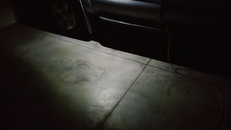

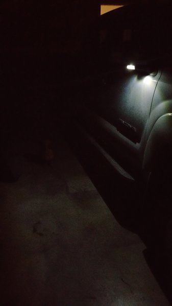

    No my mirrors only had the blinkers. This mod added the heated mirrors and the puddle lights.

    Got it. I have bought a set of aftermarket 4Runner mirrors and plan on switching them out with the mirrors that are on my truck now, which were the stock mirrors with no blinker, heat, or puddle lights. If I am reading what you have done it should be possible to switch the mirror portion of the 4Runner mirrors to the arm portion of the stock mirrors.
    And if I am understanding what you did in the write-up above, you basically used the housing for the 4Runner mirror and attached it to the arm of the Tacoma mirror, adding the wires for the puddle and blinkers, then used your stock Tacoma motor and innards to complete the installation?
