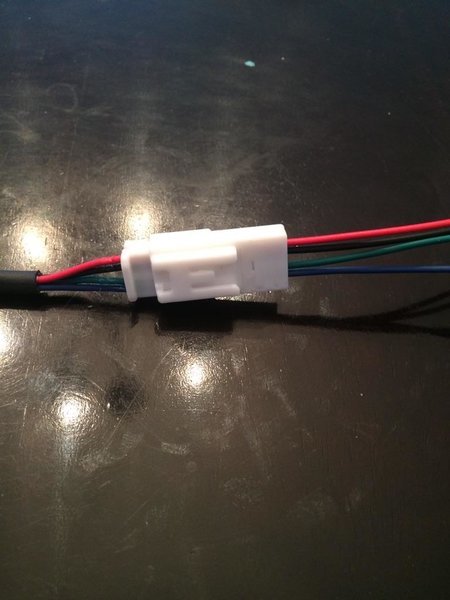

    It's the round 5 pin in the door, that connects to the Tacoma motor. I don't have it apart yet, but the part that's confusing is from what I've read the factory only uses 3 wires (power, left/right, up/down) what are the other two wires for?

    Ok so this connector?
    I'll get my multi meter out tonight and figure it out. Any input on this @Up2NoGood?

    That's the beast. Thanks! It's ~14* right now so I doubt I'll be outside anytime soon to install these.

    The other two slots are for the turn signals built into the mirrors.

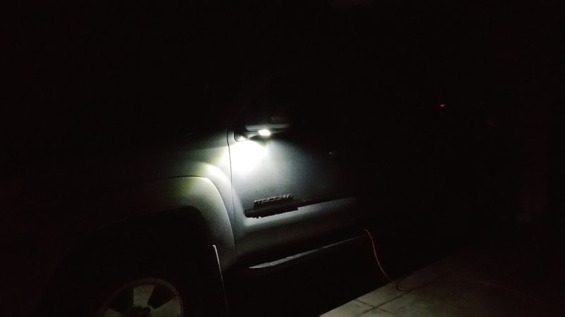

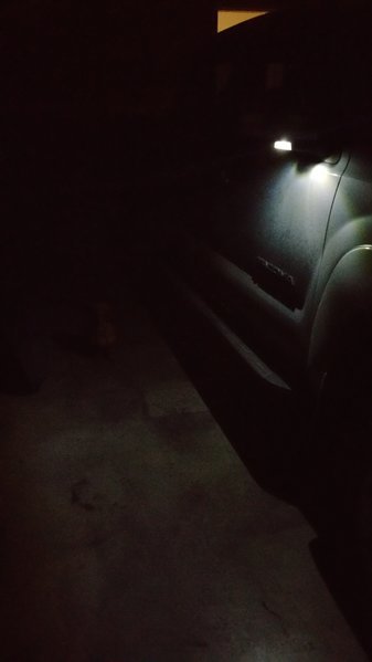

    Here's a picture with the led upgrade.
    Hey it's bright enough to see my wiener haha
    adio likes this.

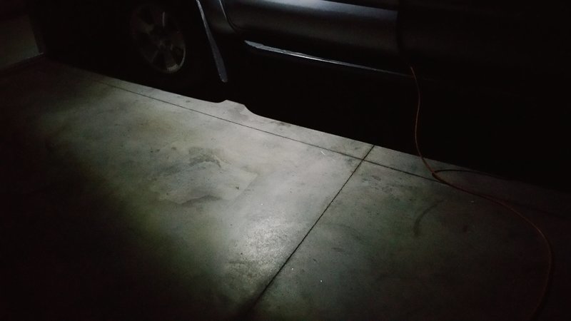

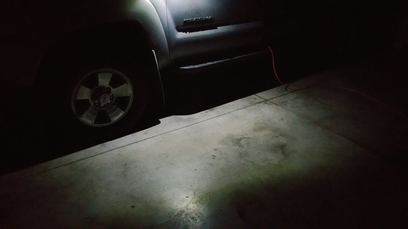

    Here's some better pictures of the leds with full 12v.
