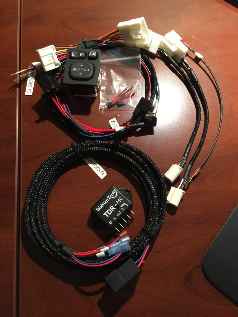

    The wiring should be pretty similar. I would talk to up2nogood. He can make you a custom harness that has everything you need and make it plug and play or pretty damn close!

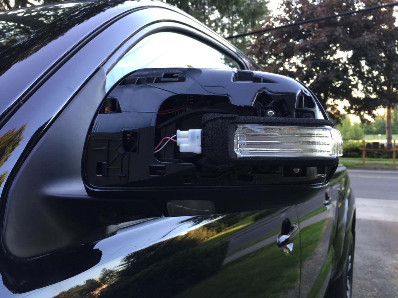

    If you are trying to swap the guts out with your 2011 mirrors, they won't work. Different design motor. Leave the 4runner mirrors the way they are and swap arms.

    Yes, I recently did this on my 2011. The 05-11 mirror motors are different than the 12-15 and will not swap out. Just buy the mirrors, swap the arms, and wire them up. They work fine.

    Is disassembly really necessary, or can you simply swap the arms and figure out the wiring. Not sure if the runner uses different signal combos for the motor controls.
    Also, I see you've included a link to additional heated glass. Do the mirrors not come heated already? Why the additional glass?
    What time relay did you use for the heated mirror circuit?

    The used mirrors I bought were already heated so I only had to disassemble enough to get the 4Runner mirror on the Tacoma arm (no glass removal required).
    I bought a harness from Up2NoGood
    It came with everything I needed to plug and play the new mirrors - its an excellent kit, I highly recommend it. If I recall correctly the timer was set for 5 minutes but is adjustable if you need longer. I used the heated mirrors all winter and the puddle lights are a nice feature as well.
