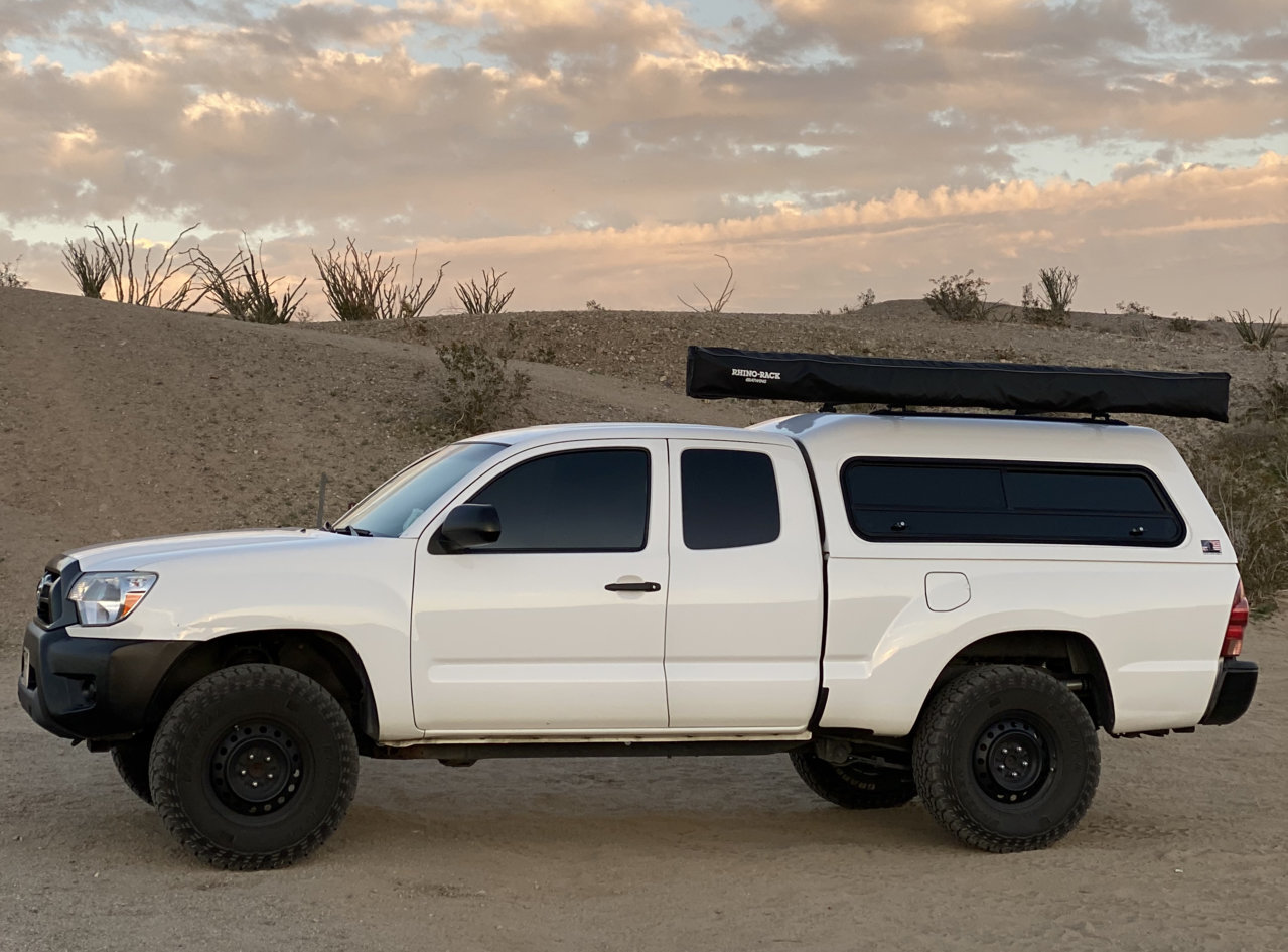

    My 2015 5 lug with some new shoes

    Looks good! What are your wheel and tire specs? Is that on stock suspension?

    Thanks! Its got the readylift kit with bilsteins front and back, and its on some procomps 17inch (cant remember the name) and KO2s 31

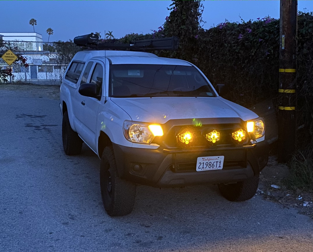

    Jack
    Ventura
    2015 5-Lug AC Tacoma
    ARB Rear Locker, shitty Ebay lift
    My washboard warrior.
    Ebay spacer lift + Bilstein 4600's in the front
    Firestone Ride Rite 6762 28C airbags + Bilstein 5160's in the back
    ARB twin compressor + air chuck
    ARB Air Locker
    ARB Batwing 270º awning
    Road Shower 4L (7gal)
    Frontrunner 11 Gal footwell fresh water tank
    Apple Carplay hack

    @farmdit,
    Sorry to be noisy, but may I ask what transmission & rubber in/on the above Taco?
    Why because my 2.7l w/ manual 5 spd. had a 3.31 gear & when I went to 255/50-19 or 29” tall tire the truck fell on it’s face! I first went w/ 4.10 but it was to low. So I traded an member for 3.73 gear.
    Auto 2.7l’s come with a 3.58 gear. You can find complete 3rd. members for as little as $150 plus a gasket & fresh lube... If you can change your oil you install a 3rd. member. Just my .02 cents.
    farmdit and Das it mang like this.

    I've got the Auto transmission with an ECGS 3rd member w/4.56 gearing and ARB locker sitting on 265/75/R16's (31.6"). The gearing is perfect with the 4.56 and the 32's; in (remember: auto) 4th gear I'm sitting at 2500rpm at 70mph. Third gear maxes out at around 95mph, so it's perfect for passing. With the controllable height the rear airbags give me, I can easily tack on a few hundred pounds in the bed without any sag whatsoever and still a comfortable ride and reduced body roll. My motorcycle can ride on it's hitch carrier and still not experience any rear sag, which really helps with the decrease in departure angle that thing brings when in use.

    I was initially set on the 4.10's but decided to go with 4.56 and just go another tire size up if the RPM's were too high at cruising speed. It turns out to be right where I like it, and I drive a considerable amount on the highway. If I could find someone to fab me custom UCA's I would be pretty stoked. Might try to have a friend build them in the future but they'd be hand made so not easy to replicate for anyone else. Hmmmm

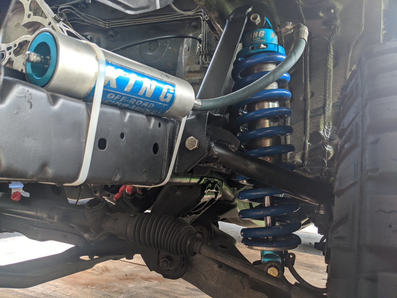

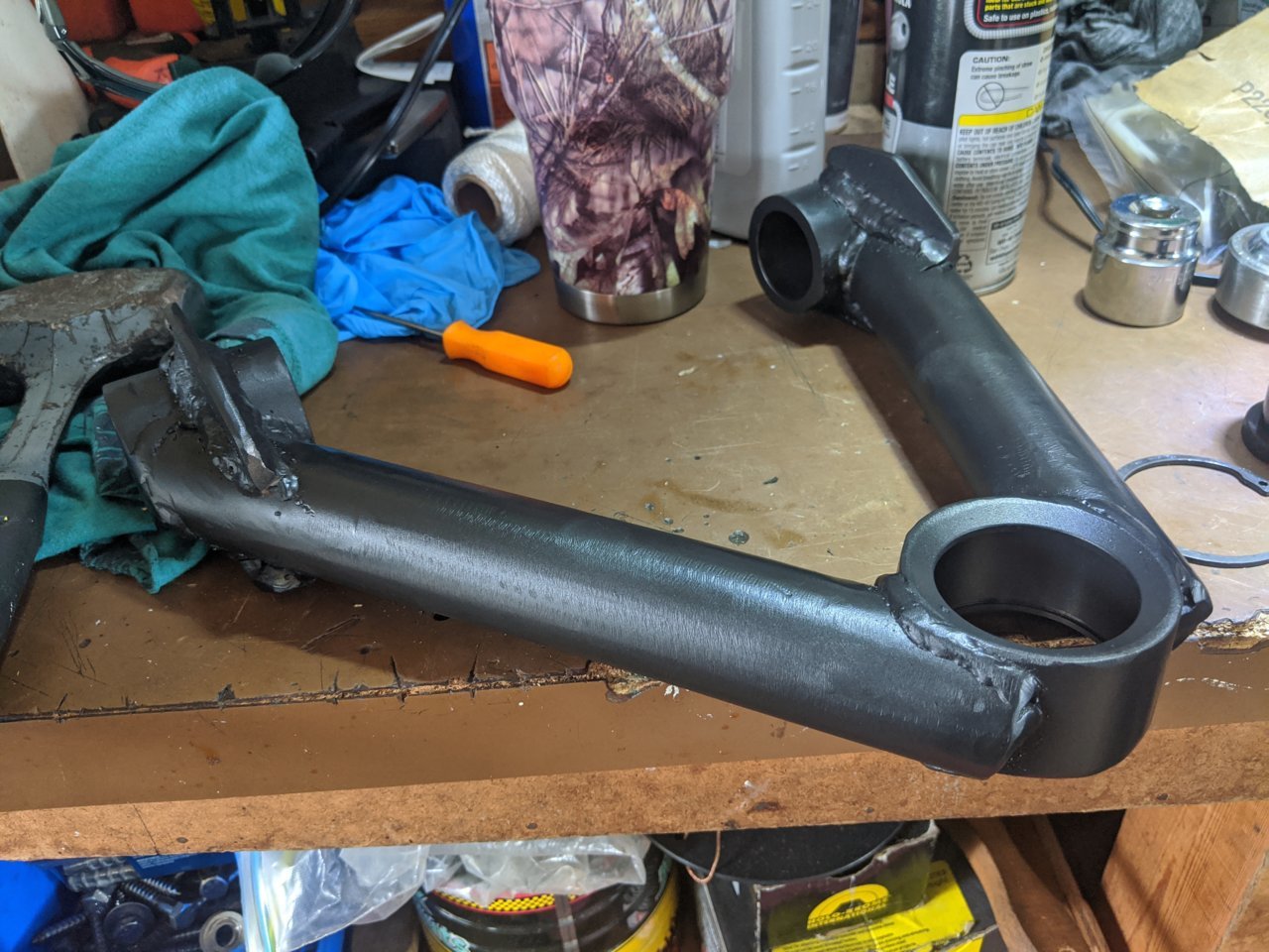

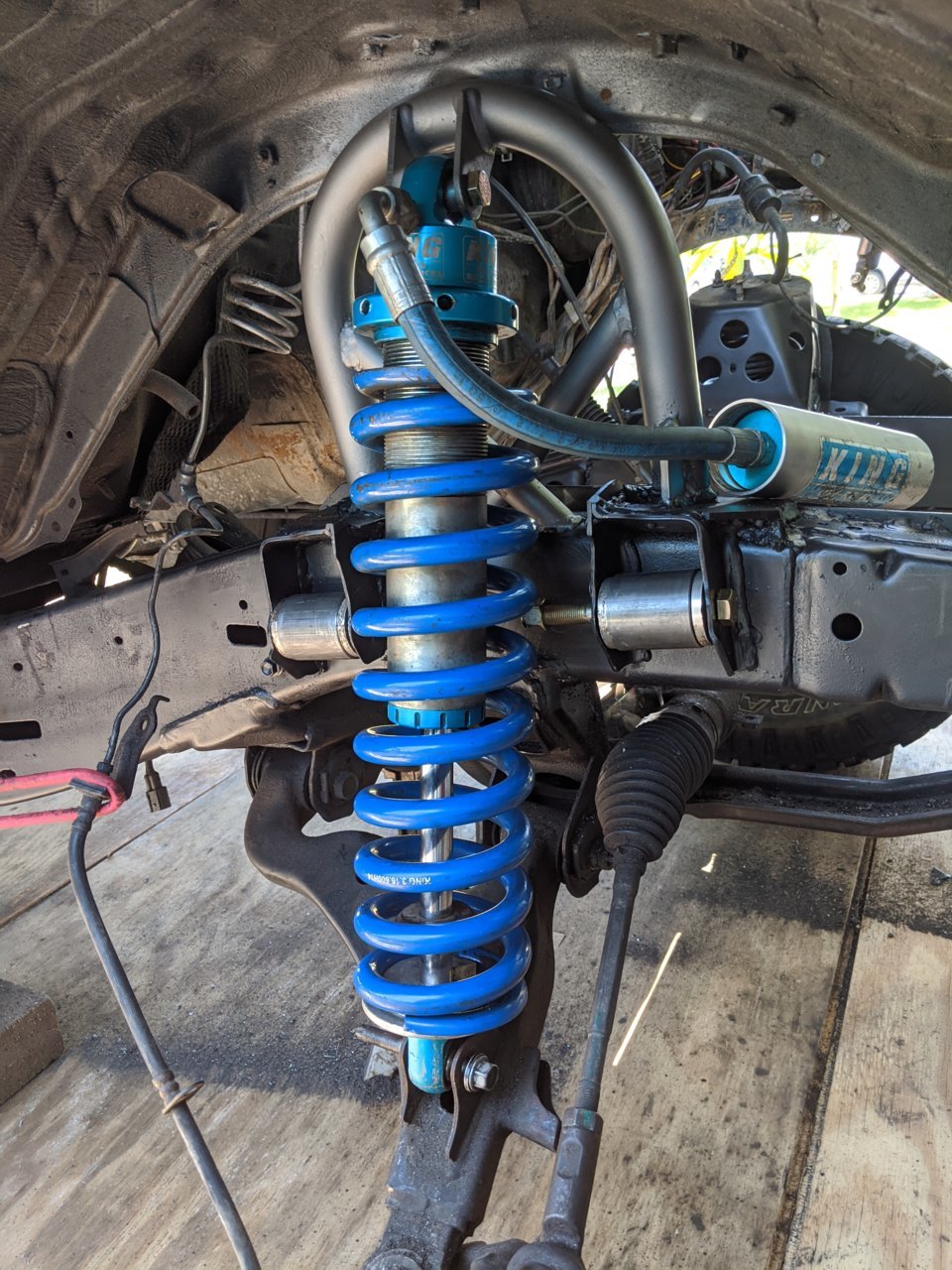

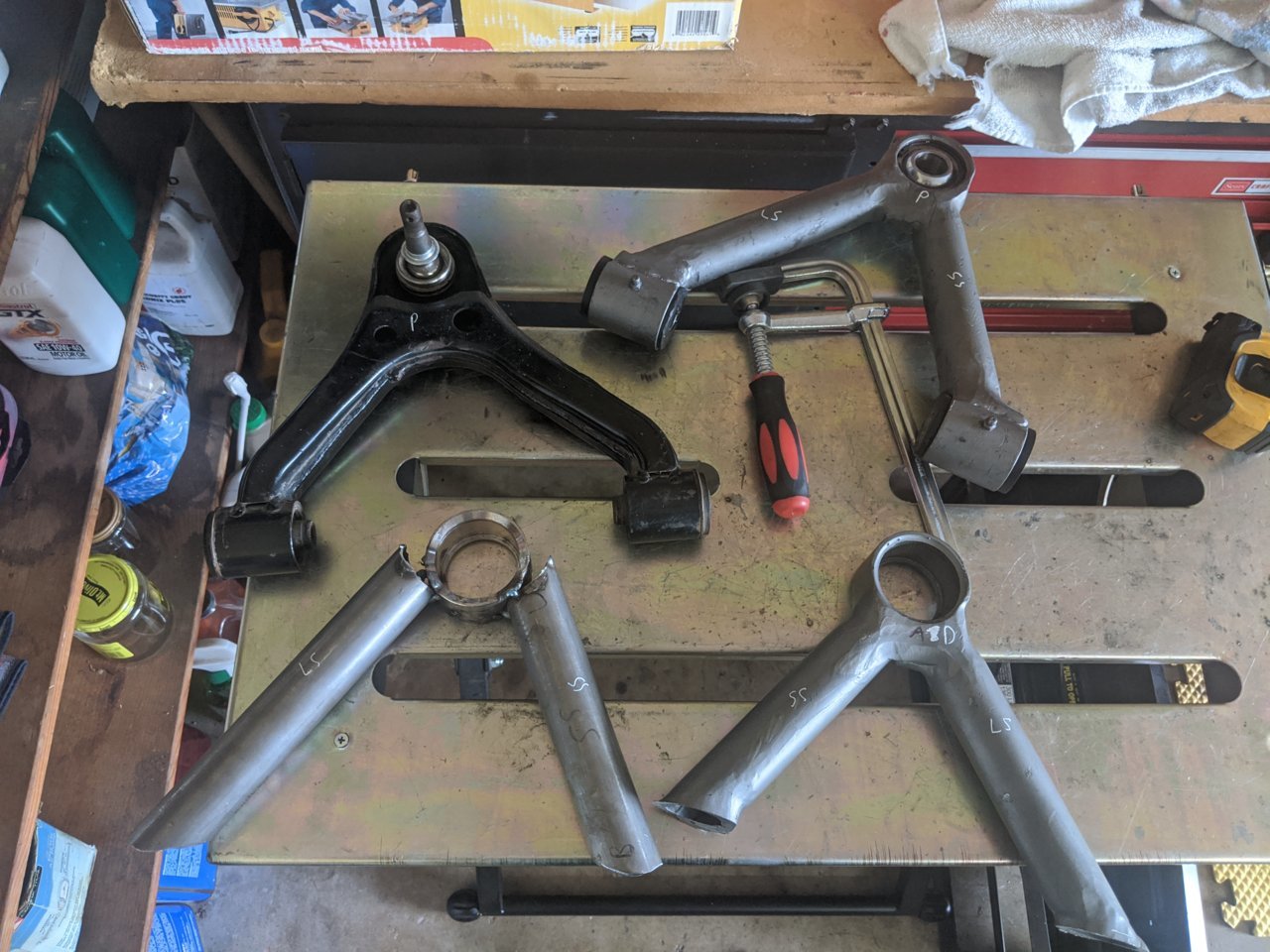

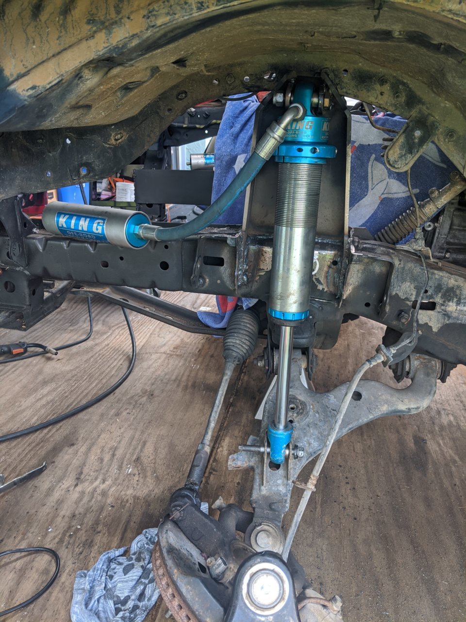

    Got a lot of stuff lol
    Supposedly the ucas may still be in stock here.
    https://bigcountrycustoms.com/product/toyota-05--tacoma-2wd-5-lug-upper-control-arm-kit/
    I'm still working on mine but I have something on the truck for now and will be waiting until Im done with the v8. I think my next set will be boxed and cut from a plasma cutter.
    I've done a couple of tries lol the hardest part is getting enough clearance inside the triangle for the shocks.
    For shocks I got originally tried a hoop on the frame but wasn't happy with it.
    So I tried ruff stuff shock towers and am really happy how they turned out. The towers fit just in between the uca mounting points and they have alot more room for welds.
    I was able to fit 8 in travel king 2.5s with remote resis (standard rod end and flat spring perch). Yes the zip ties are temporary and your mileage with fitment, I tacted the towers with the shocks installed.
    Currently with the v8, frame plating and tranny in it's sitting just below level with no preload with 700lbs springs. Still have to add a bumper and my hydraulic winch.
    I'll have alot more info once everything is done and driving and believe me I'm going to test it hard lol
