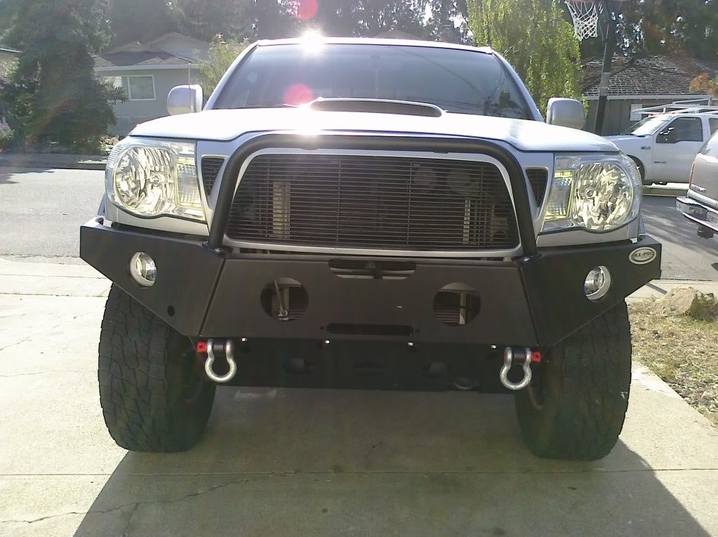

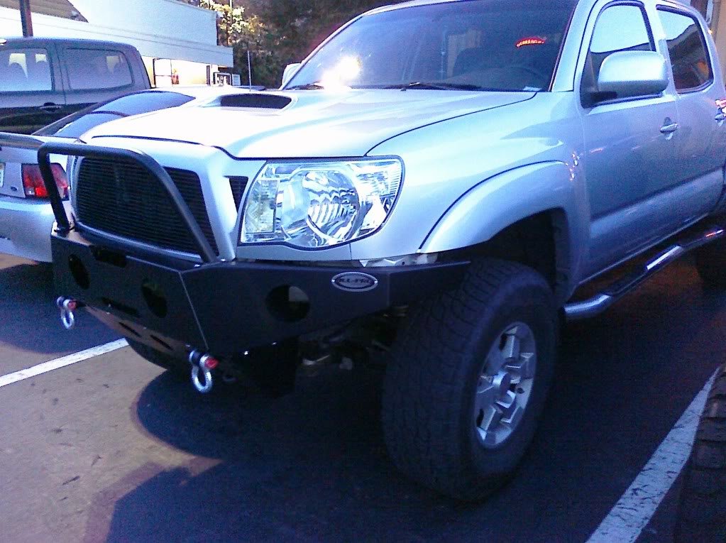

    MJonaGS32
    MJonaGS32 MJ on a GS
    Apr 14, 2009
    #15949
    12,405
    MJ
    SF Bay Area (East)
    07 LT 4x4 DCSB 6spd Vagabond
    Drifter wedge camper, Dual battery, OBA, ARB locker, 4.56 gears
    I have a problem with the angle of mine also. Although, I think I have mine bolted together incorrectly anyway.
    http://www.tacomaworld.com/forum/all-pro-off-road/87646-ap-bumper-install-help.html
    I got all the bolts in all the holes (took some work), but I was thinking that if I reinstall it the correct way, then it'll correct the angle?
    Or how about adding washers on the top bolts where the bumper is connected (IIRC, they have 3 bolts on each side). What if I put washers on the top bolts to kind of create an angle back upward?

    MJonaGS32
    Apr 14, 2009
    #15949
    12,405
    MJ
    SF Bay Area (East)
    **update, fixed it!

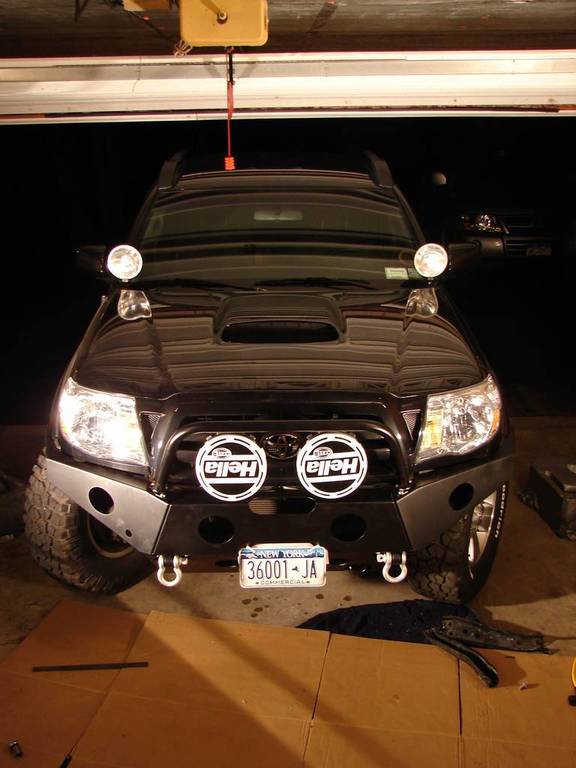

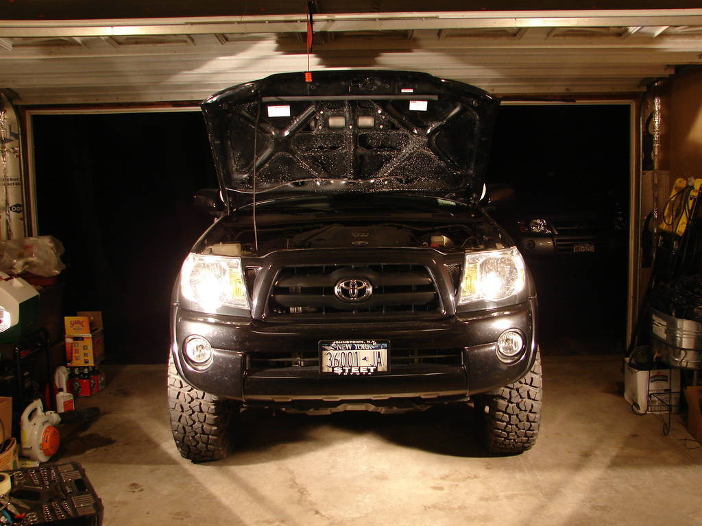

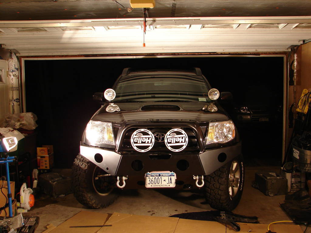

    twisted rage5
    twisted rage5 Member
    Nov 14, 2008
    #10768
    16
    Fort Plain, NY
    08' Black Sand Peal TRD Sport
    DTRL's, URD TCAI, URD MAF, Dome Light Mod, 12v outlets always on, Defroster Mod, Hella 500's custom mounted near windshield, BFG's All Terrains, Pioneer AVIC Z2 DVD NAV
    Before
    After
  11. Apr 25, 2010 at 11:04 AM
    #311
    MJonaGS32
    Apr 14, 2009
    #15949
    12,405
    MJ
    SF Bay Area (East)
    Are those the Hella 700ff lights? Is there a way to mount the covers on upside down on the light, so that it faces upright?

  14. Apr 25, 2010 at 7:34 PM
    #314
    csuviper
    csuviper Moderator Moderator
    Jan 9, 2009
    #12424
    4,430
    Brian
    Broomfield, CO
    2012 Tundra Rock Warrior 5.7L 4x4
    3" Toytec Ultimate Lift, 315/70R17 Duratracs, RW Wheels, Grillcraft Grill, Toyota "Raptor" Lettering and more
    That thing looks mean!!!!
    What do you do that requires that many lights though?

    #319
    twisted rage5
    Nov 14, 2008
    #10768
    16
    Fort Plain, NY
    Thanks! I love the look it has now. I live only a few miles from the Southern part of the Adirondack state park in NY so the lights come in quite handy plus I'm a sucker for over kill.
