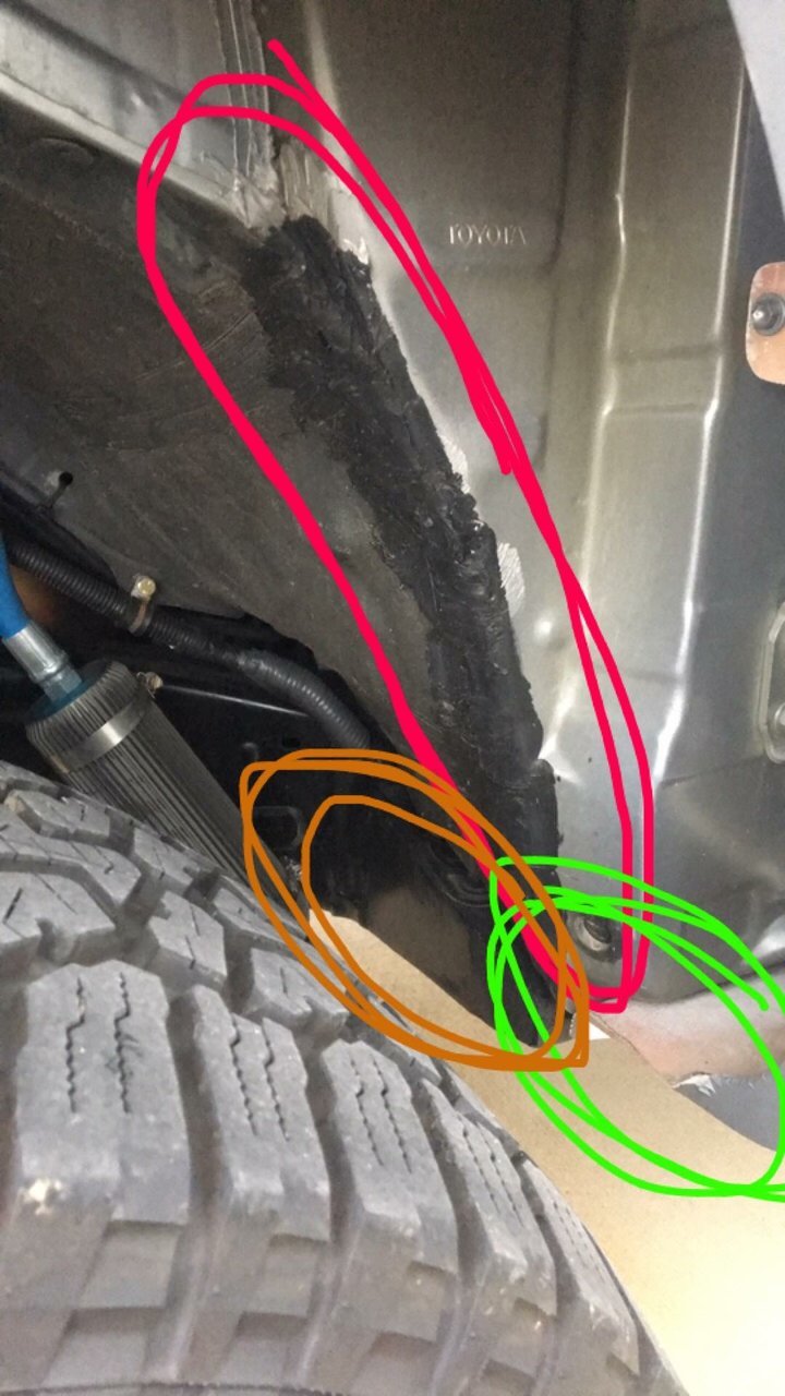

    Narrower tire but higher side walls then? How big of a difference is 255 from 265? What is that millimeters?

    Doodle much? Lol so I wouldn’t have to trim the outside fender then?

    smashed this, broke that, covered it up with tape and paint
    No I still have a cmc
    One side just got over cut and we revered the overcut

    You will have to cut the fender back where the mudflaps are
    And I doodled that because it's accurate and it's a good way to show all the new people on tacomaworld how annoying this question is when a simple search will result in the answer.

    You'll have to take a sledgehammer to the long area circled (it's a pinch weld)
    And then I highly recommend using a sealant afterwords to keep any leaks from forming

    Tire rub has less to do with tire diameter and more to do with the scrub angle, which is effected by tire and rim width when turning.
    I cut my pinch weld completely off (with cut off wheel) Then I mig welded the seam. Then the sealant.....
    No leaks. Looks better than a hammer attack.

    There’s a 99% chance of me not beating my truck with a sledge hammer. Really don’t want to trim anything
