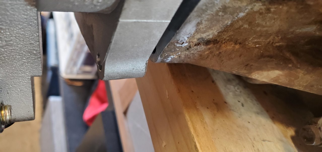

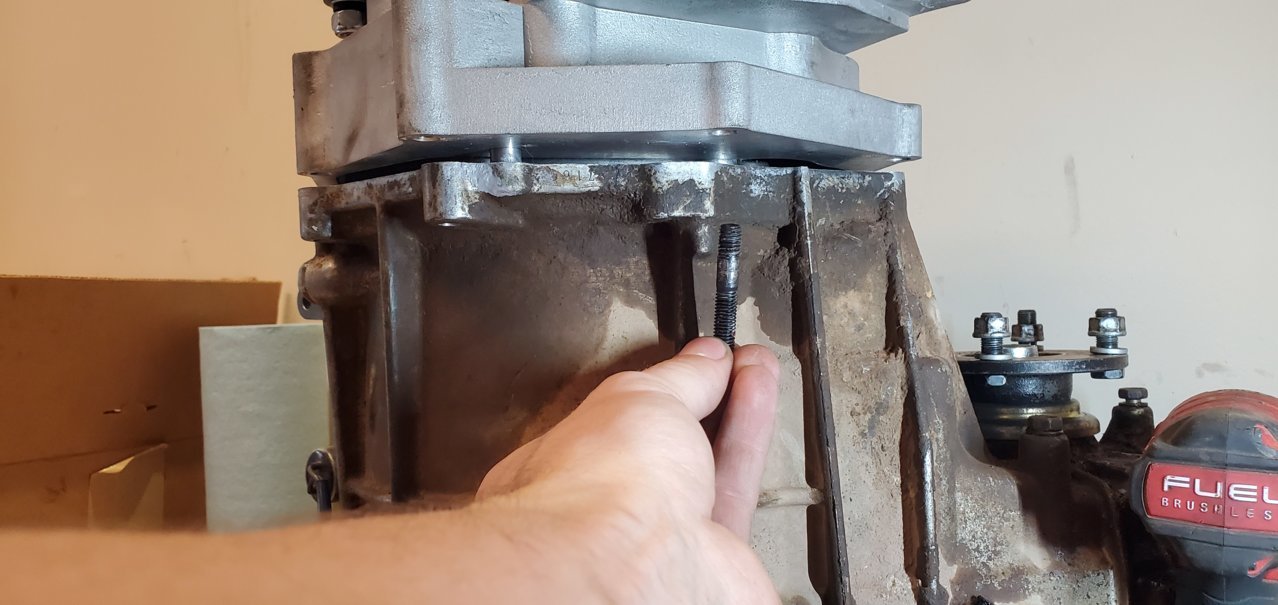

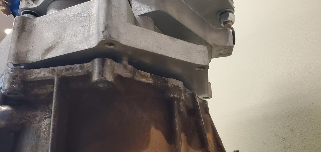

    All right what the fuck. This trail gear adapter isn't even close to matching up with the bolt pattern on my factory chain case. There's like four or so holes that don't line up.
    The pictures speak for themselves. I don't really get what's going on, but it's like this is an adapter for a second gen or something.

    Hate to say it, but that's trail broken gear quality control. A buddy a few weeks ago had issue with shifting his j case into 4wd because the adapter wasn't clearance enough from broken gear. We end up tearing it apart and grinding it ourselves cause broken gear want us to send it in for "repair"
    You can clearly see the scar on the adapter binding with the rails

    4.0 case adapter?

    You're probably right. Sucks that I have to wait until Monday to give them a call and see what the hell's going on. Really curious to hear what they have to say about it.
    Possible that it's a rear adapter for an entirely different truck. No idea
