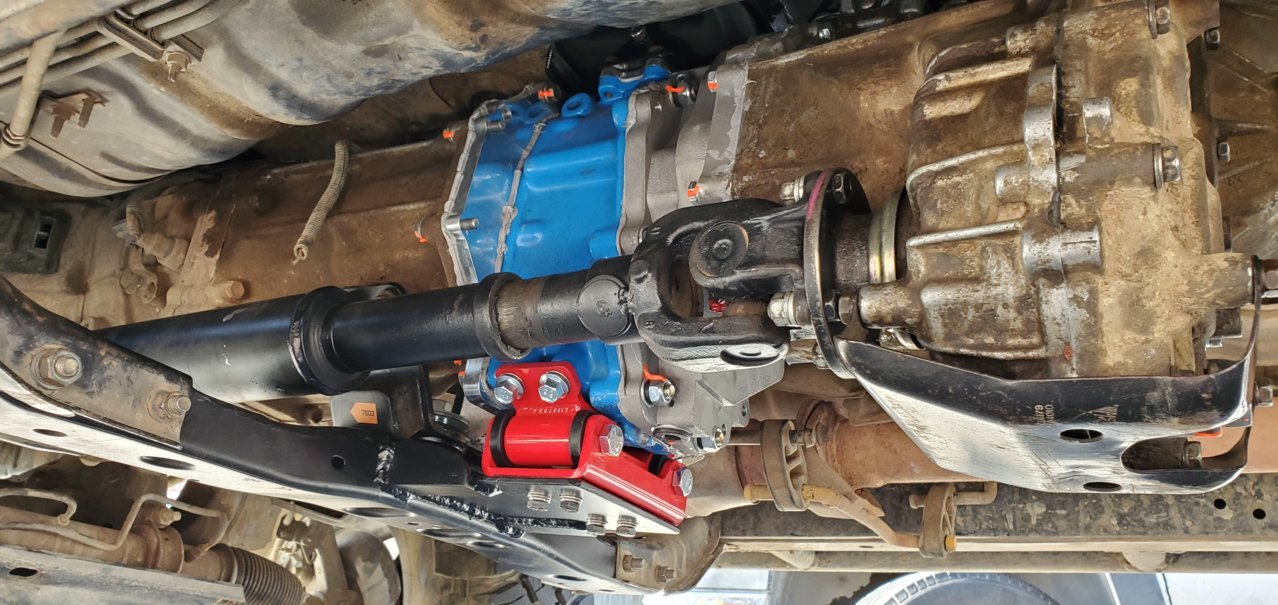

    Got a couple mounts too.
    Going to be a fun winter project.

    Damn mark! Thats tits! Let me know when your wrenching. Would love to lend a hand

    damn you’re tough to have to cut quite a bit out of the trans tunnel to get them to fit. Can’t wait to see them installed and the Uber super slow video to follow :cool:

    I’ve been reading this thread when I can think I’m up to number 20 or so but anyone know where I can go read up on this stuff more in depth? Like, one or two cases, stock vs FJ, what type of fabrications I need to make on cross member and front shaft etc? I guess what I’m looking for is some in depth pros and cons etc. or just keep reading these threads?

    Lots and lots of research. I was never able to find it all in one place. This thread is probably the most extensive on the net. It's just scattered. Keep reading.

    You're options on a second gen Tacoma are pretty limited. As far as I've seen your options are basically either get a tacobox or atlas.....and since you probably won't be able to get your hands on a tacobox any time soon (and they have a lot of issues) you're better off in the long run shelling out for an atlas and doing a good install on it.
    You might be able to mix and match some stuff from vendors but if you look through this thread trying to mix and match shit commonly becomes a headache and it looks pretty uncommon to see people attempt it on later generation Toyotas.

    Can you elaborate on what kinds of issues there are with a tacobox on a second gen?

    I would like to know too, I’ve watched a lot of videos on it and felt this was the way I was going and then this comment... I thought taco box was solid?
