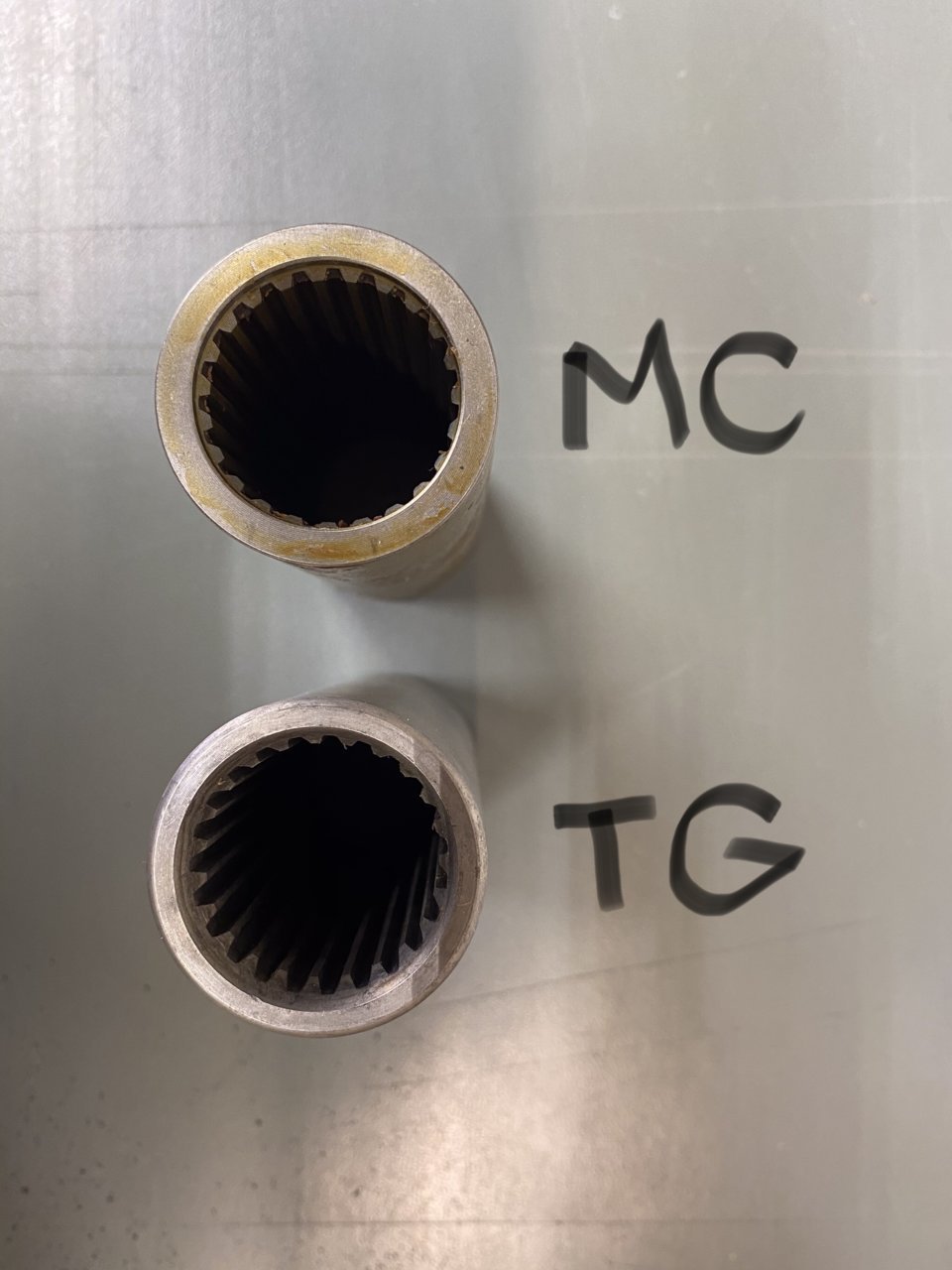

    Part MC but mostly trail gear.
  6. Dec 5, 2020 at 12:53 PM
    #2126
    02hilux
    02hilux What do you mean there’s no road, I’m here
    Sep 14, 2016
    #197244
    6,098
    Planet: EARTH
    So MC gears with TG adapters I assume? Many are running that combo, seems to be working just fine for those as long as you're running MC coupler.

    Yes, the TG coupler splines are taller than the MC coupler ones and are a tight fit on MC input splines

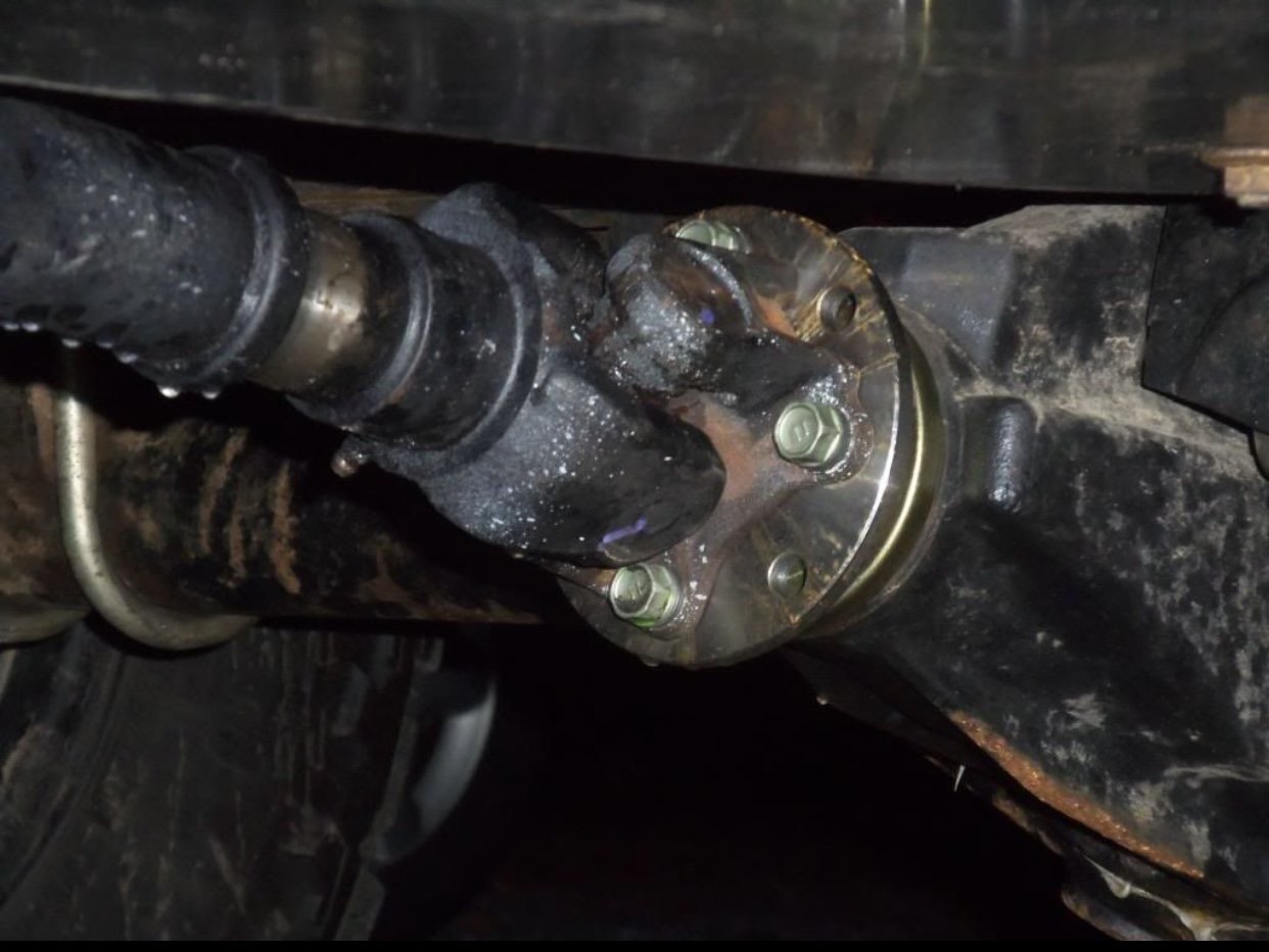

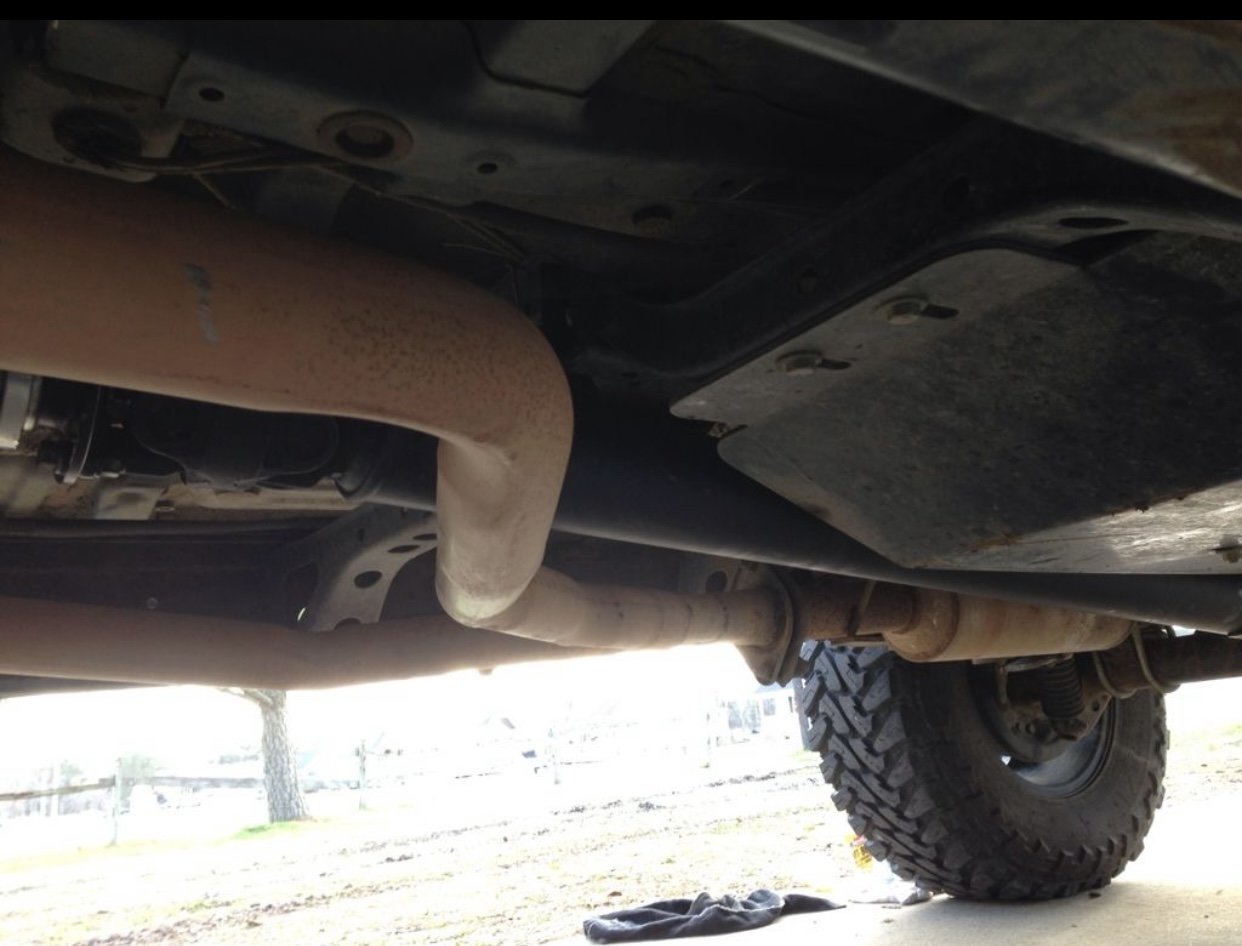

  17. Dec 6, 2020 at 5:52 PM
    #2137
    6 gearT444E
    6 gearT444E Certified Electron Pusher
    Feb 3, 2018
    #243372
    7,776
    Deep South
    Herculiner Hootus
    one piece. Shafts can be had from the rear of the 3rd gen 4runners with double cardan joint that bolt right up to the fj case. I get them from the pick n pull for $50 a pop. Just have to redrill the rear pinion for the 60x60 pattern or swap out to a double drill pattern which is easy if you have a solid collar installed on the rear diff. Negligible loss on clearance if you do the math due to shortening the rear shaft by 8.5”, at least on an access cab. My rear shaft length came out to 60” at ride height.
    Bonus is that you get rid of that foolish carrier bearing and gain a zerk on the slip joint, all while retaining OEM Toyota parts.
