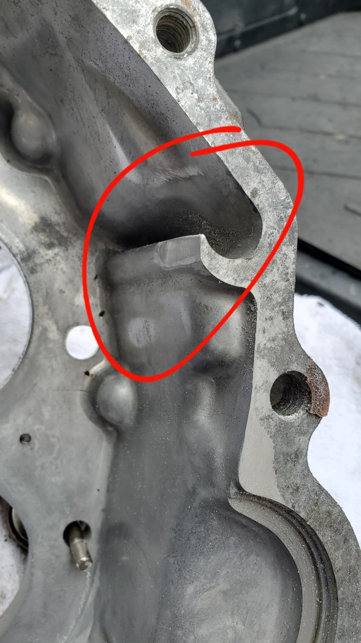

    Yea I'm pretty annoyed that I have to pull it all back apart, but I'm pretty curious on what it is that made all that liquid metal.
    Hoping it's just the housing and not the adapters.

    x2 I think your on the right path with the reduction box housing being the reason for your aluminum milkshake. My first drain was similar to yours, had some metal but not that much. Almost looks like paste, any where did you slather up with antiseize too?
    Before you fill with fresh fluid, get one of those telescope cameras with a built in light and look around, specifically the material around the countershaft gear.
    HomerTaco[OP] likes this.

    Yea I put anti-seize on front input shaft and coupler as well as the rear case coupler and splines.
    I did stick my boroscope inside the fill port, but wasn't able to see much other than some of the gear teeth. Couldn't really snake it around the corner.
    Also didn't want to pull apart all my shifters & floor to look at it from the top.
    Already filled it with fresh fluid. So I think I'm gonna run it for another couple hundred miles or so and check the fluid again. I can check it out with my boroscope from the top at that point if I feel like it.
    If it's still all glittery then I'll pull it apart.
    The inconsistencies between people's first oil change experience is just weird to me.

    ^This, did you get the reduction housing really clean after you did the grinding on it and are you sure that you had enough clearance?

    Didn't wipe it out, but I blew it out with compressed air. Sure that was prob some small bits left in there, but no way enough to make the fluid look like that alone.
    I clearanced close to 1/4" between the 4.7 gear and the housing. Everything spun free just fine on the bench when assembled & doing dry fits.
    Unless maybe there's some gear deflection under load that's causing it, but I doubt it.

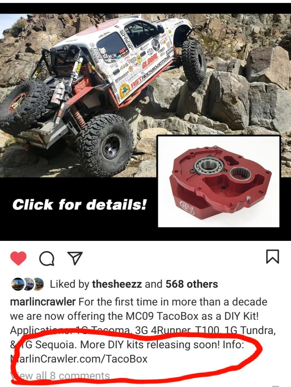

    Per their IG post, they have more Dual adapter coming soon. I hope they mean for other model trucks, 3rd gen Taco specifically. Should I hold my breathe? Anyone hear anything through the grape vines ?

    Definitely wouldn’t be holding my breath... they’re probably still filling orders from last year.

    When Marlin uses the word "soon" it tends to actually mean never.

    I know most people grind the bottom portion, but did you grind the top part?

    I did not grind that part. Again, when everything was assembled, nothing was hitting and spun freely. Maybe I had a slightly newer casting or something?
    Now I'm thinking that if it was hitting some part of the case, that would maybe be where...?
    I just don't understand how it could be hitting some part of the case when I was able to spin it freely by hand on the bench with no resistance/contact inside.
