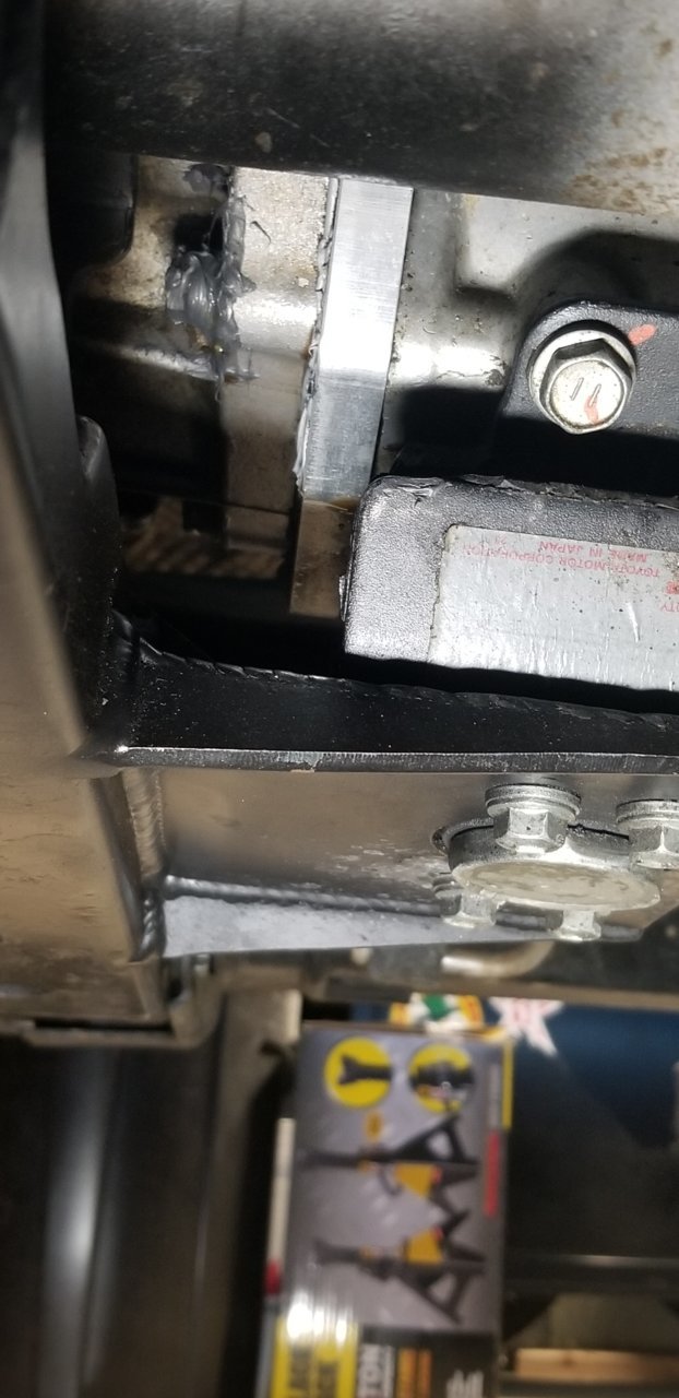

    As soon as I noticed it, I caked the hell out of it with some rtv as a quick band aid, but this atleast shows the location. It's in a real bad spot, as I can't get a gear wrench around it, only an open ended wrench. I tried backing it out, but wasn't having much luck. Maybe it was just coming really slowly at maybe 1/8 a turn at a time. If I end up really going at it I'll pull the front driveshaft and crossmember to help get some room to work. Also, I considered drilling it, but I don't want to drill through the transmission if I don't have to. If I could remove the box, it'd be a no brainer, but I don't want to modify the trans if I can avoid it.

    Have you pulled the bolt out and made sure it's long enough? Could just be RST installed a bolt that's too short, stripped the first couple threads, and a longer bolt would be able to tighten on the remaining threads.
