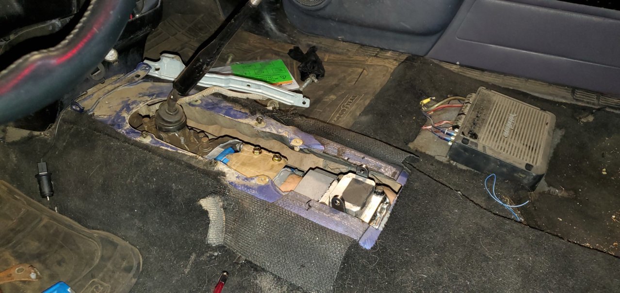

    Is it possible to remove the transmission cross member, drop the drive train down as far as it'll go, and get in with a hammer and a big ass drift punch, so you don't have to fully remove the case?

    I could make my own like 3/4" body lift out of some plate and just plasma cutting it out, but that's a lot of work. Also might look a bit weird imo with armor and spacing the body off the sliders.
    Did you do your own or just a 1" one?
    I did already do that with a punch, prybar & hammer. Didn't drop the crossmember though. Might have to try that to see how if it'll give me any more room to get in there

    1” body lift and you’ll hardly notice the difference. Roger Brown makes a nice kit, and I’ve found installing a small body lift has many side benefits such as trans tunnel clearance, replacement of other various components like starter, fitting larger tires without having to bash the fender well, fixing bumper gaps keeping the bumpers from digging into the fenders, fishing and routing wires along the top of the frame, etc. I have sliders and the body lift kept them from hammering into the pinch weld, another added benefit. Also installing the body lift is probably quicker than fabbing a new trans tunnel.

    Besides my joking, my opinion is to drop the transfer case and clearance or cut a hole. No reason for a body lift and same amount of work.

    looks like only hitting a small spot, so probably not much clearancing require. I had my case clocked to flat belly so there would be no way to accomplish without rebuilding the whole trans tunnel and drivers seat area.

    More what I’m getting it. A few wacks with a hammer and it would be clearanced. Only cost would be time to drop the case vs buying/making body mounts. When I get to caging my interior I’ll just cut the floor out and flat belly it and mount everything to tubes to keep it easier

    I would like to do a body lift for all the reasons you mentioned, but then I would have a decent gap between my bumpers and body. And I don't particularly want to modify them to accommodate that. I know that a 1" gap like that would bug the shit out of me.
    I'm thinking of going this route. Not sure if it would be easier to just drop the whole tranny & cases as one, or try and separate the rear chain case with the RTV on there. It's gonna suck, but I think better than making my existing hole 5" longer. At that point I'd have a hole in the middle of my cab almost the length of the floor pan from the firewall to the rear cubbies lol

    Why can’t you drop both cases like normal at once? Mine is just the crossmember and a series of bolts around the adapter and pull back to undo the collar and it comes out. Transmission jacket makes it really easy

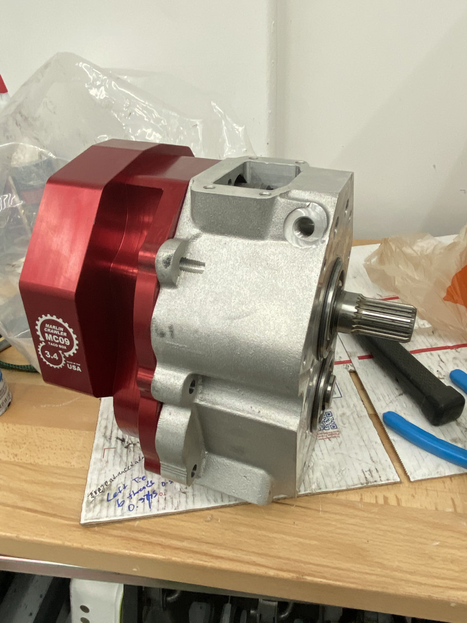

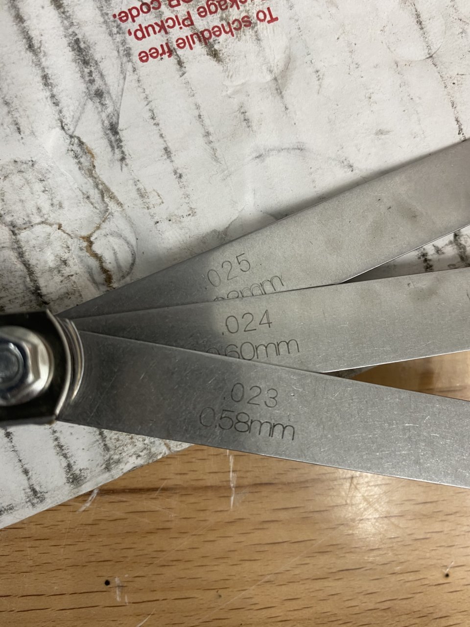

    Hello, I was just assembling a tacobox. Does anyone know if this gap is normal? Seems kind of questionable. Thanks. 1CB0DFDA-C446-4323-8F9E-68385066FA69.jpgD242F045-D013-4EB0-80DC-61893C436AA7.jpgD18F54AE-B40C-41A8-B026-C1B503AD0DDE.jpgE1866274-4157-47DC-97B9-C96DACECA27F.jpg

    I could, but it's RTV'd to the transmission too. Either way I'll have to deal with RTV
    Is yours not sealed between the transmission and crawlbox (between the outer housings that is)
    Duckfatt likes this.

    Just test fitting before I put rtv.

    I just figured removing the rear case might be a bit easier since the input shaft on the crawlbox going into the transmission is much longer than the chain case and you don't have to worry about the seal. I had to fight it a bit getting it to line up and slide in on initial install.
    I didn't use a feeler gauge on anything to check clearances when I built mine up. I think an old Marlin instruction guide mentioned it, but didn't tell you how to fix it if the gap was out of their specified tolerance. Couldn't tell you if that gap is normal or not.
