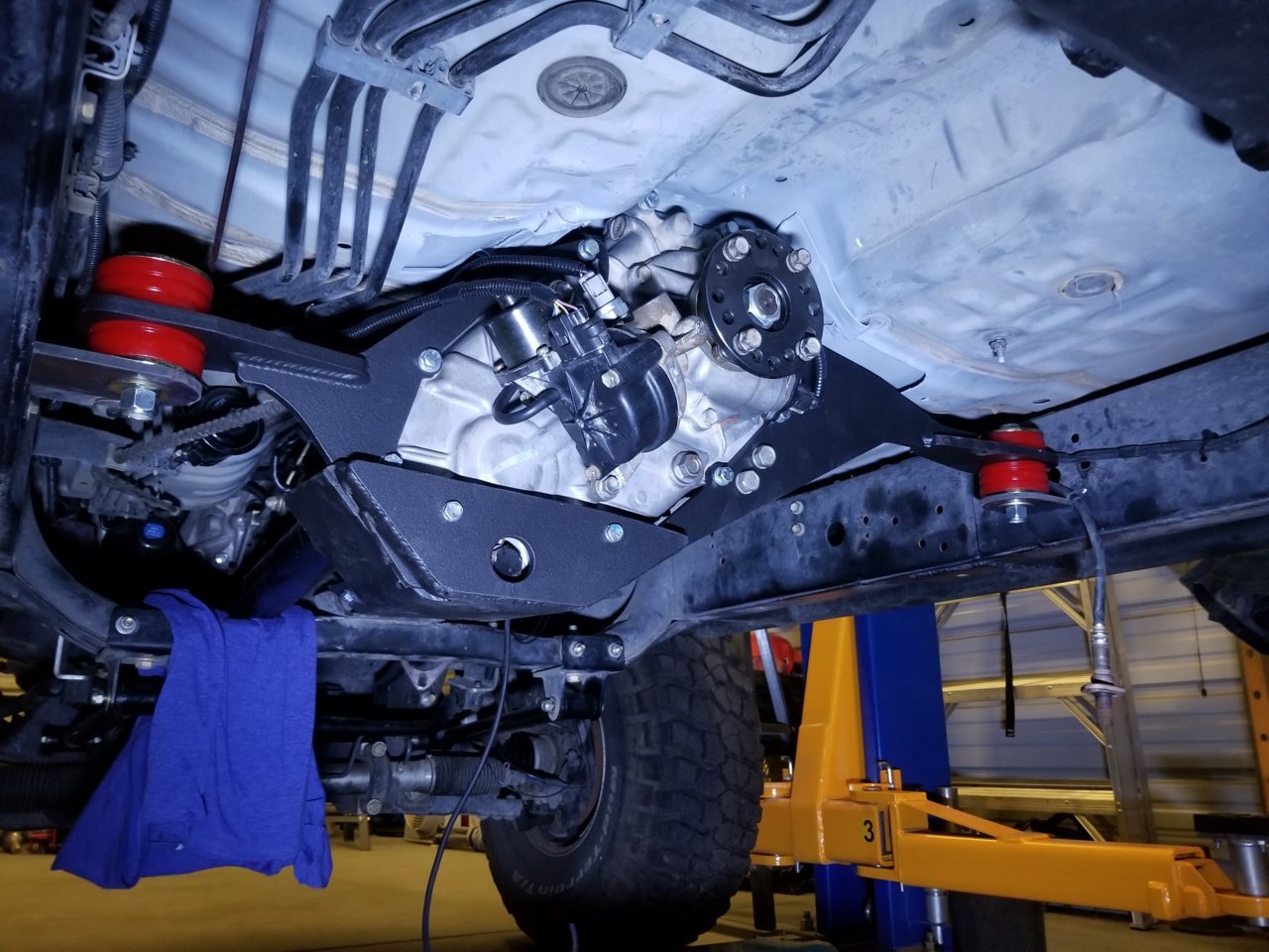

    Oh you are very smart. I cut into the cab to clear that mount and sheet-metal plated around it.

    I didn't want to do that. I'm too lazy to do extra work. Plus, mine sits way way farther back than any dual case. If I did, I would have to cut into the rear floor section for the mount. Plus, this made it easier to remove the mount because it's a 2 piece instead of 1 solid unit.

    Basically what I did, but with the rubber rf1a mount instead of a poly one.
    What are those traction bar looking things that come forward from your crossmember?

    You want the case to be able to move a bit. Tying it into the frame at two points was something I considered and after talking to may folks they all advised not too. So I fabbed that guy up. My rig vibrates but it's from my tires not from me crawlbox. lol

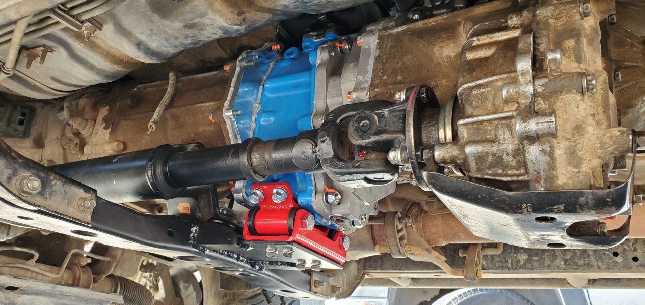

    Mine vibrates a bit, but nothing intolerable. I did just sign up for the solid offroad motor/trans mount to add to this though haha. This mount is the 4x mount for the RF1A box. Definitly grabs a bit better than a stock rubber mount, keeps my shifters from knocking into the console :D

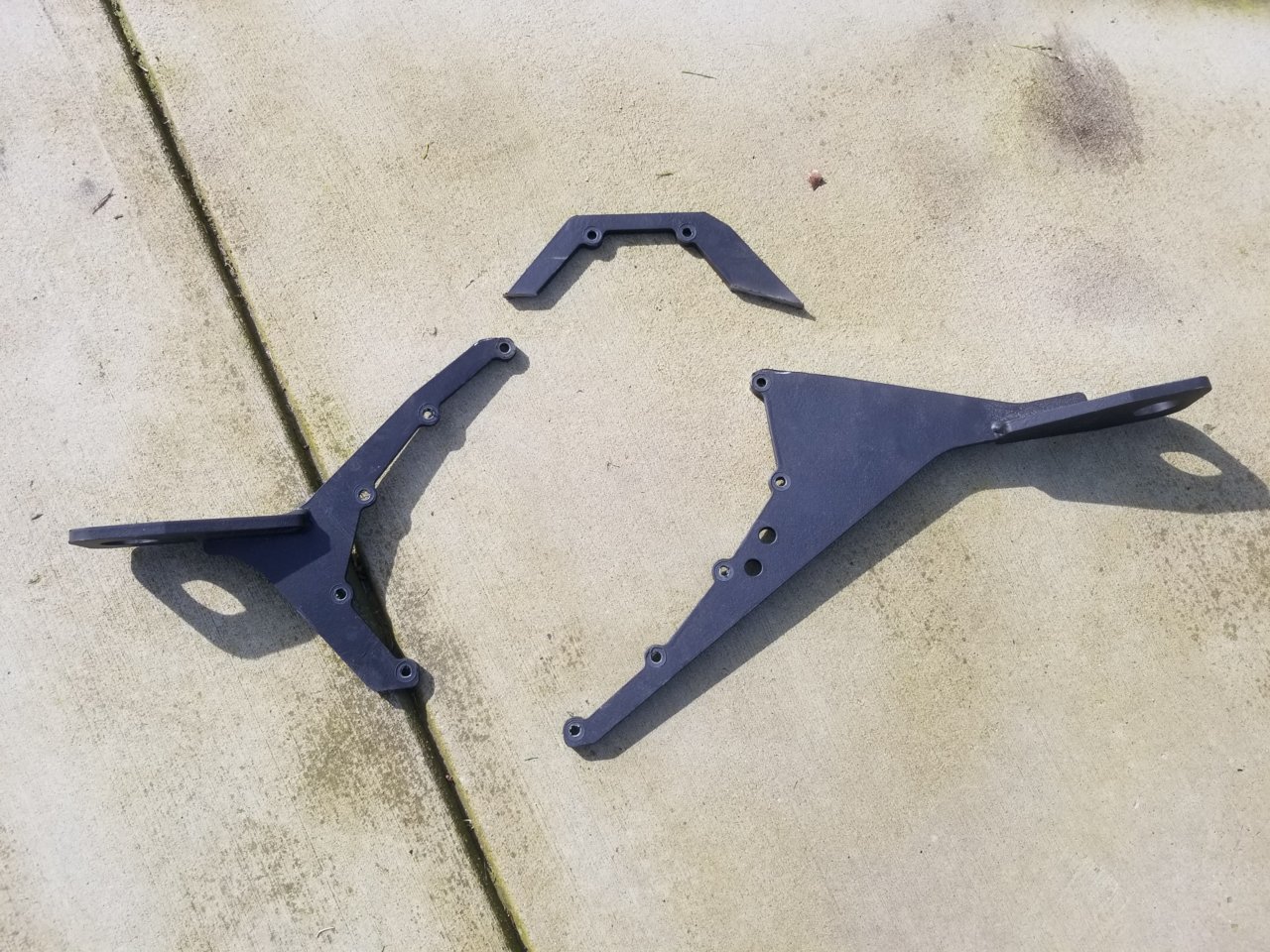

    I barely feel mine at this point. I used jeep yj leaf spring bushings and it's been great. Super simple, yet effective.

    Just another note, I used a 3/4" bolt instead of looking for a long enough metal sleeve. Helps a lot with less vibrations since it's just rubber on metal. :thumbsup:

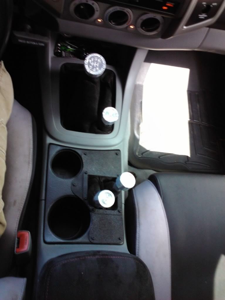

    Hey everyone, I recently purchased another tacoma but this ones a big project. I come here because it does have dual cases, but I am looking for a solution to the stick setup. Currently no cup holders. It’s a 2.7l 5 speed. HomerTaco’s setup is supreme but I am not sure if it’s possible to do that with the 5 speed. Curious if anyone here has gone through a similar situation.
    Pictured is the current setup. The previous owner had a metal plate to “clean” up the look. Which it didn’t do very good at, and the sticks would just vibrate like crazy on it so I ended up taking it out.

    this is what mine looked like at one time. i know longer have twin sticks so its been changed up

    What stick setup were you using? That looks way better than what I got now, and I will gladly take 2 cup holders back.

    that at the time was davez offroads twin stick. i also had Front range offroads but that moved the hole to a diff spot.
