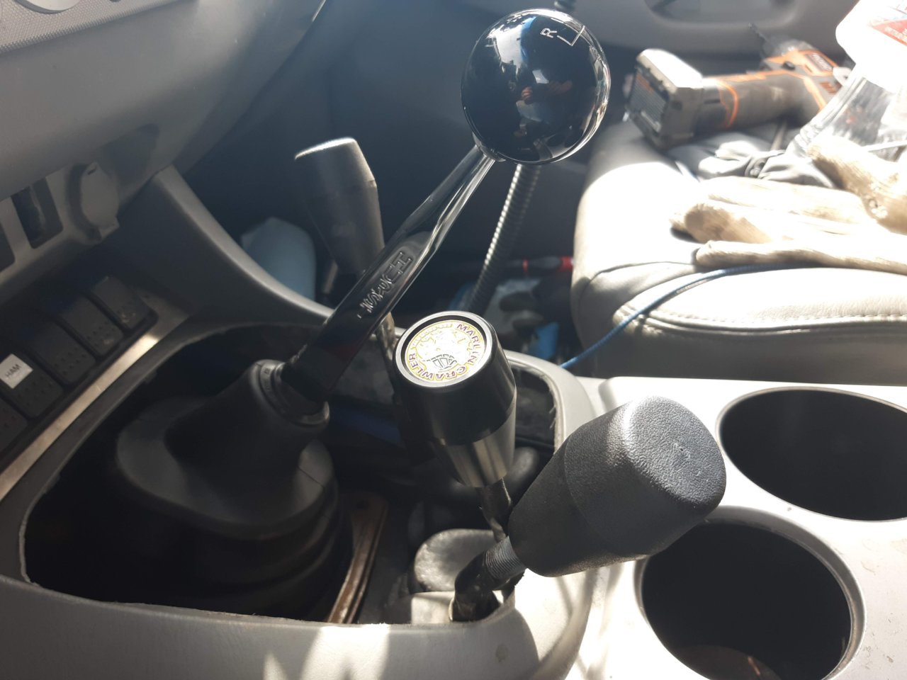

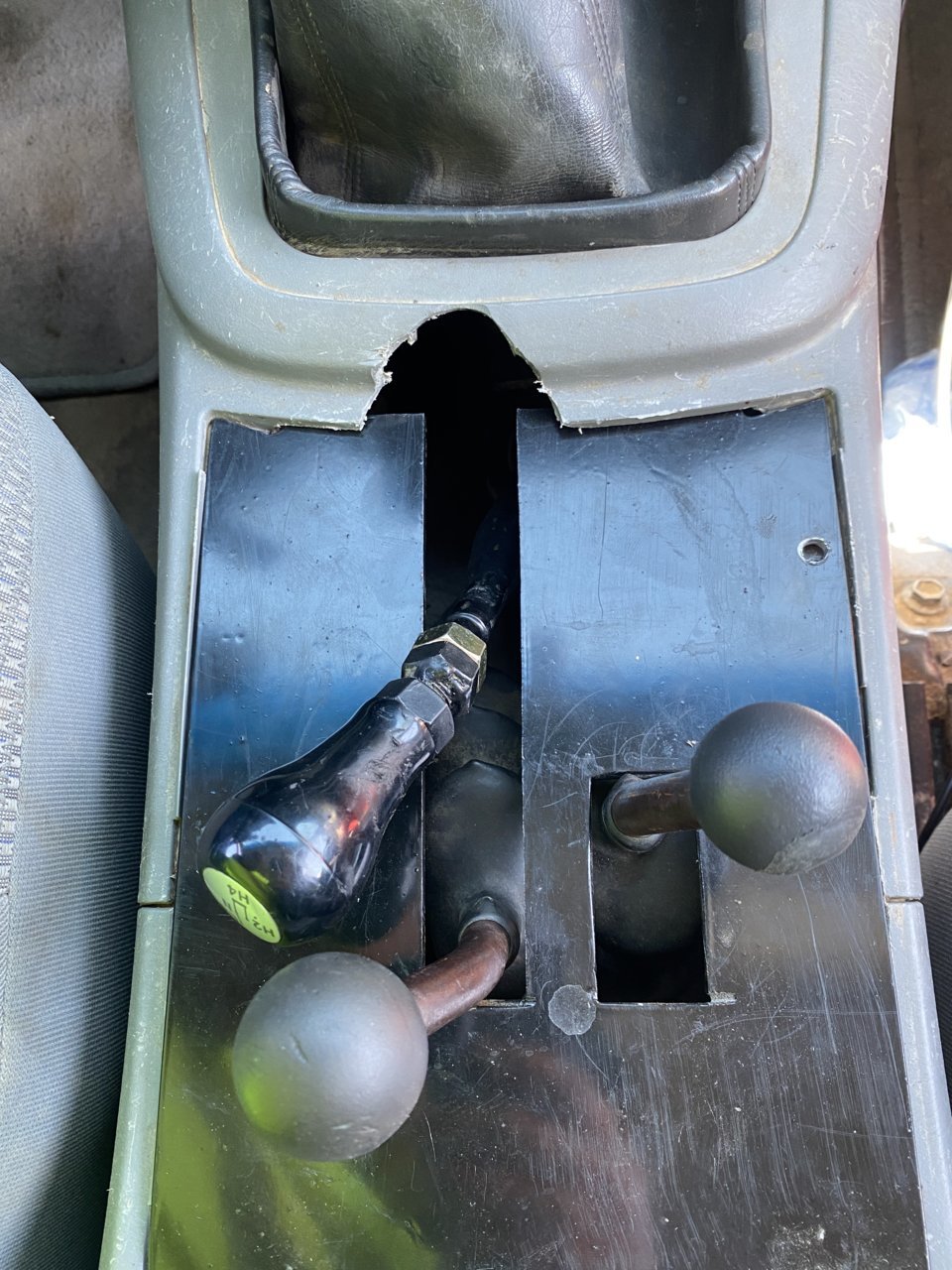

    this is what mine looks like now
    Murphinator likes this.

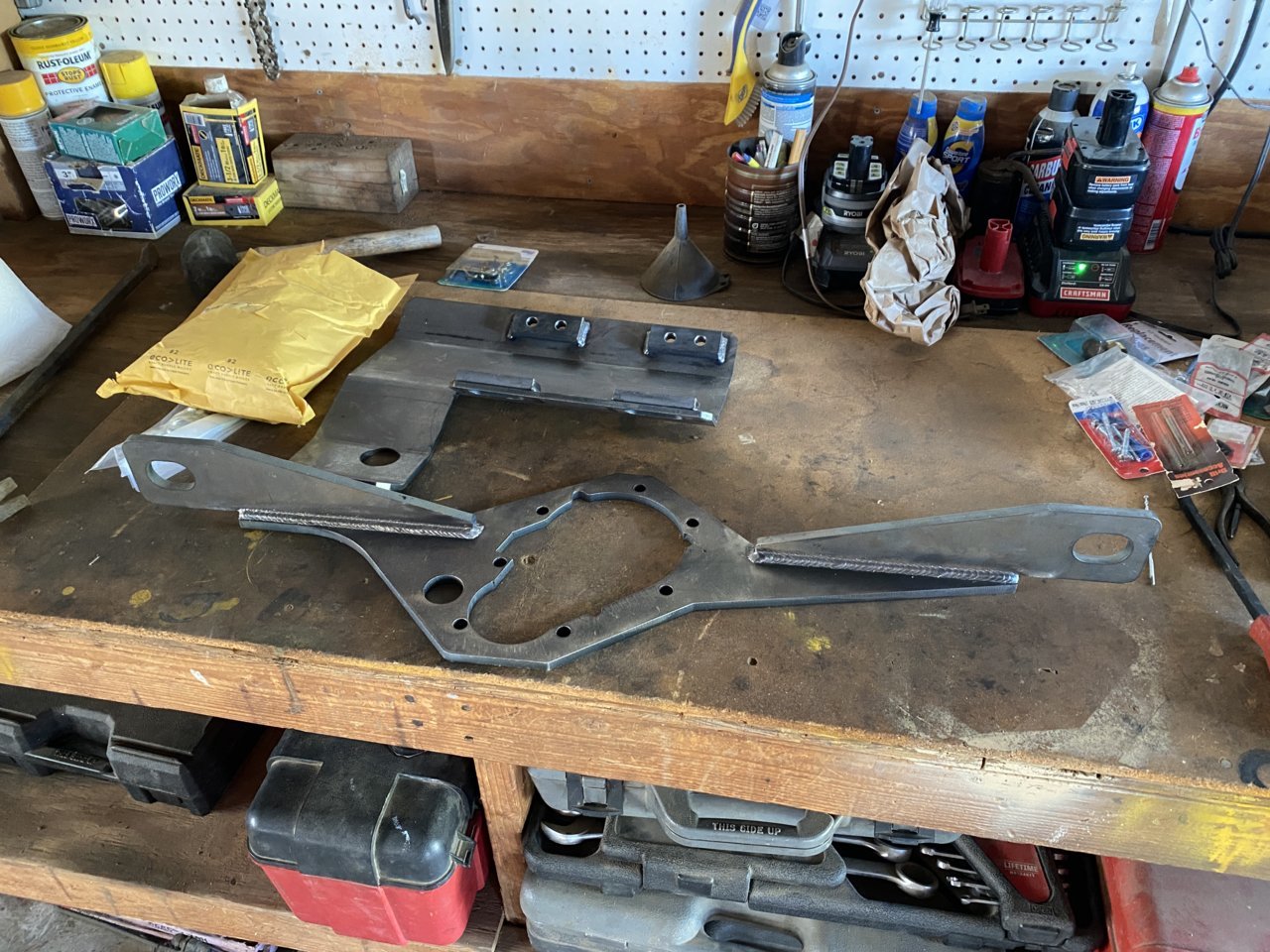

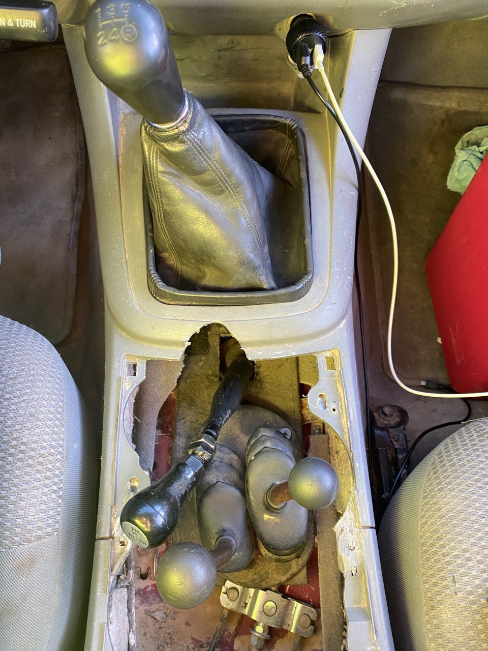

    For your amusement here it is!
    I mean it definitely works I just wish there was atleast one cup holder or preferably two so I have room for a cold beverage and my cellphone. I have also found a website that sells a short throw for the crawl case. I haven’t seen anyone selling one where it moves the front shifter to the back two. I think that would be easier to deal with vs having all 3 up front.
    I would buy the hurst short throw if it was instock! I have been checking since I bought the truck but no luck on that yet.
    Hopefully this saturday I will be picking up a used transmission to replace this one in the truck currently. It’s only a tad jacked up. The crawl boxes need a good reseal kit or something because they are currently leaking.A7CD2E2B-E5AC-4899-B9BE-8D51C9BF03DA.jpg
    Not the best photo but it does appear a lot of fluid is coming out where the twin sticks are, one of the center parts of the case, and the adapter to the transmission.

    Do you have 2 gear driven cases? Looks like the rear case is a passenger drop, do you have a solid axle up front? Either way, to fix those shifters, flip the crawl box shifter around 180 degrees on the base, and do some cutting/bending/welding of your current setup as @Littles mentioned, and you'll have a nice fitting shifter assembly without having to purchase anything new. It will just take some time and patience. Here’s what mine looked like.

    What he said.... cut, rotate, extend, and re-weld. Your imagination is your limitation.

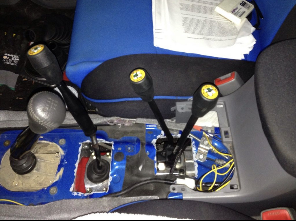

    Fortunately for me I had a bunch of help with the mechanics of the mod & I was able to put a considerable amount of effort into the ascetics. :oops:
    I think I was the first to do this stick configuration in a 2nd gen. I did a ton of research and never could find one prior to doing it. :notsure:
    I wanted to fit all of the sticks through the stock trans shifter location but I knew that the throws would need to be shortened in order for it to work. The Core/Hurst trans shifter was a big help. I also was able to get a custom short throw for the twin-stick shifter which really helped with fitment.
    In the end I just wanted to have it look like an OEM option and not something thrown in. Very happy with it to this day. :D

    Currently yes 2 gear driven cases & ‘77 chevy dana 44. That is a good idea on flipping the shifter around, I didn’t even think to try that. Looks like I need to get a welder.. not only for the other sticks but there is heaps of stuff on this truck that a welder will be useful for. Thank you for the tips. My plan is to ditch the rear driven crawl box for an fj case. Then get a furd axle and swap spindles to keep 6 lug. I won’t do that until I have the confidence and tools to link the truck though.

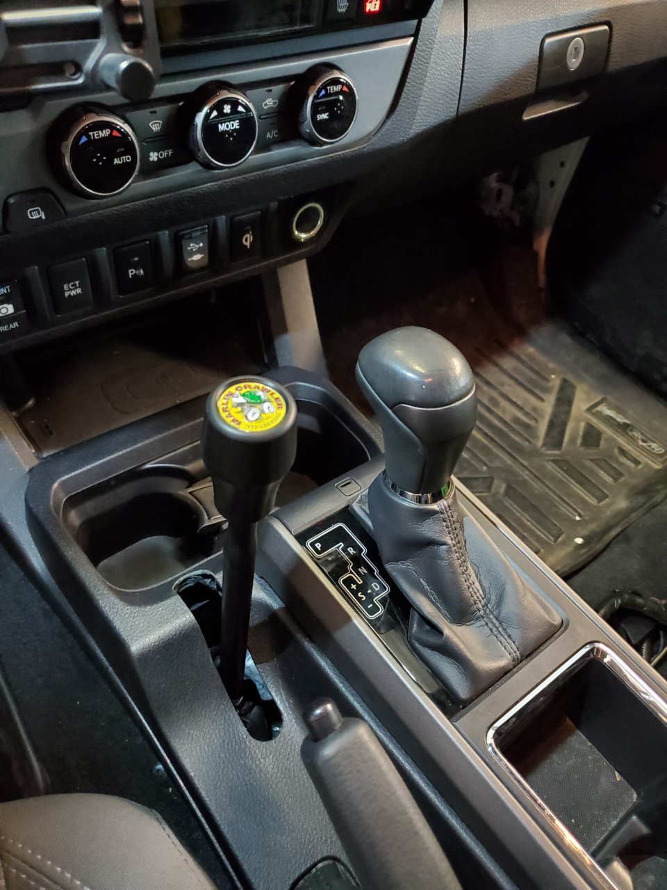

    Was finally able to make time to put this bad boy in my 3rd gen. Super stoked about the Low life and happy that I can finally contribute to this "Crawlbox" thread
  15. Apr 11, 2021 at 6:13 AM

    :bananadance:
    Btw I like your shifter slot, very low key and simple

    Is your drive train poly or solid mounted? I don't see how guys with that small of a cut out don't have the stick hit and vibrate on the sides of the cut outs under acceleration, not to mention compound low going up a steep hill. My drive train wobbles and twists that much just driving down the street. :notsure:

    Poly, I haven't taken it off-road yet, I will trim as needed and I also plan on putting on a slim leather boot

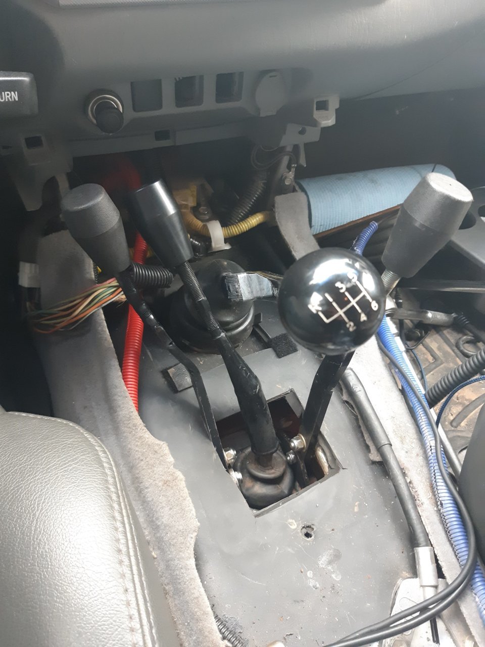

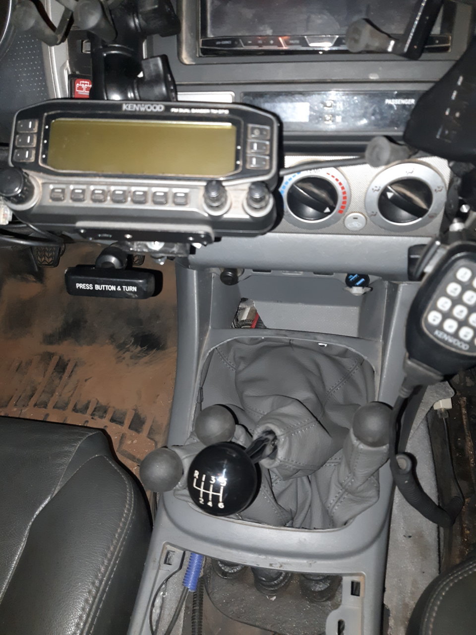

    Five shifters total. Had to custom build some shit.
