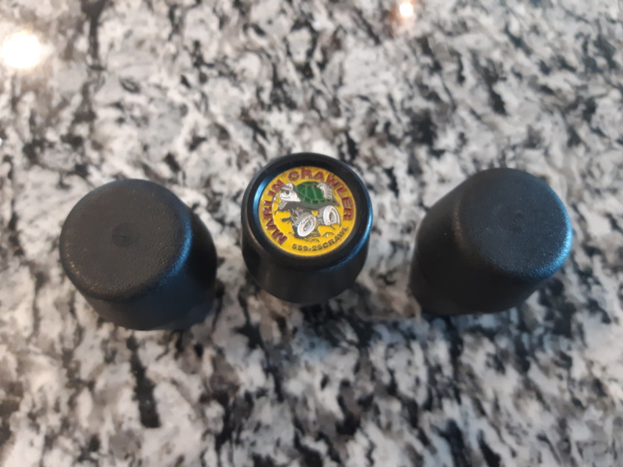

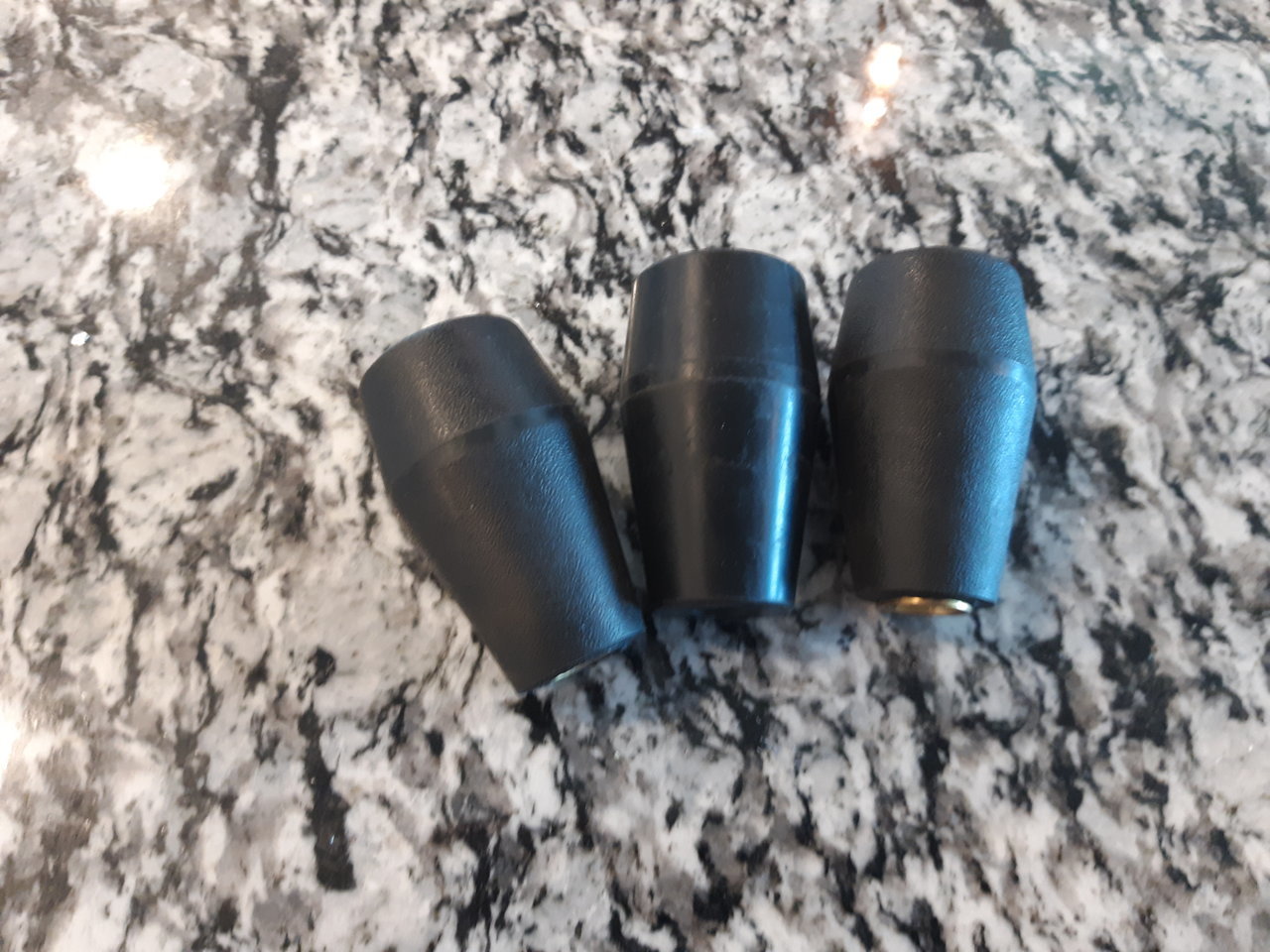

    Anyone need some knobs? Came off a Marlin shifter and radesigns triple stick.
