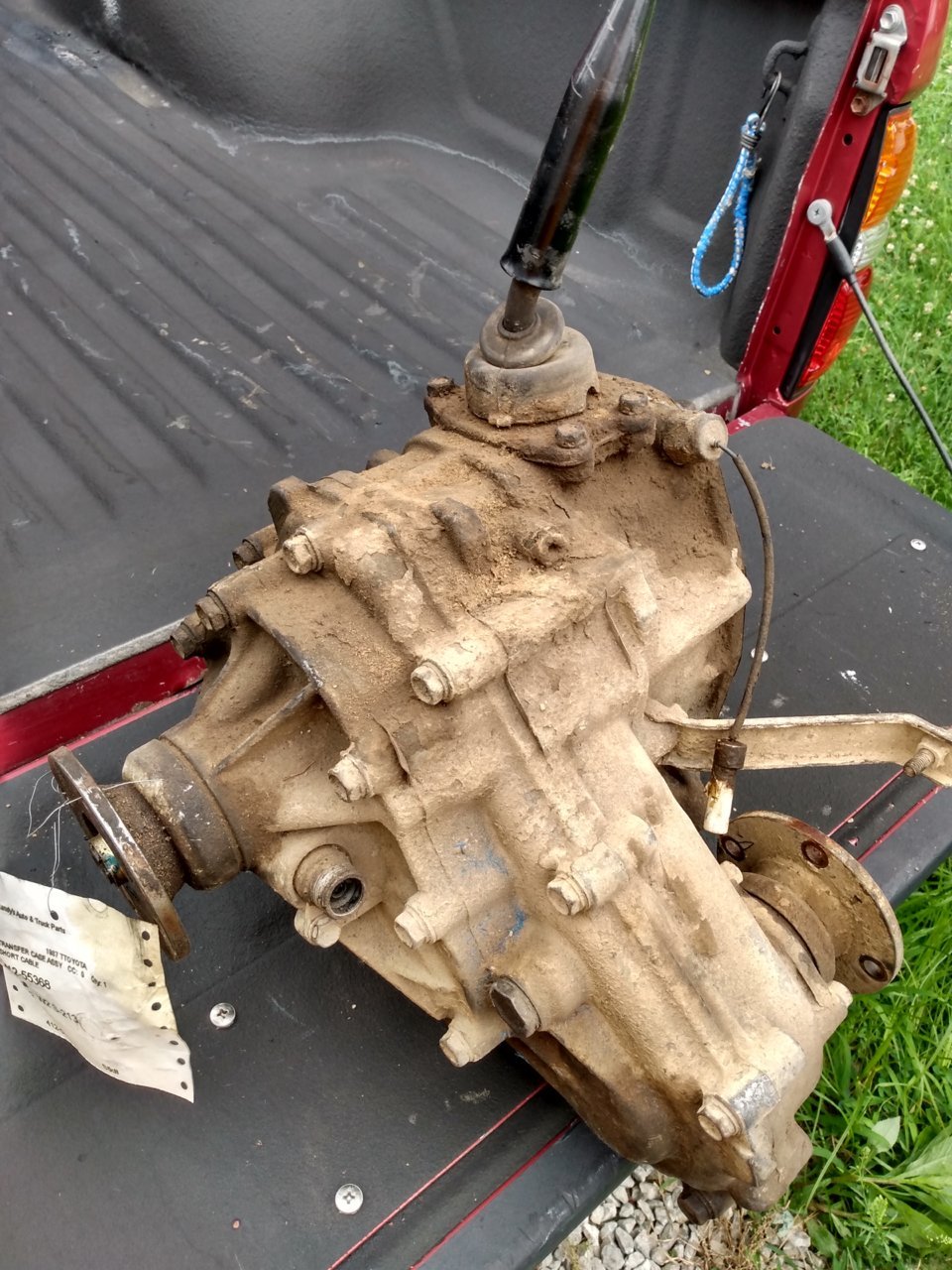

    Found the first piece of my puzzle. Got lucky and found it at a junkyard here in central Indiana, they didn't even have the whole truck just the case up on a shelf. I've been reading thru this thread now and I've noticed most people put the crawl box in front of a j shift case. Has anyone used the factory ADD case in the rear? I've already done the 2lo mod so I'd like to keep the ADD and have both cases have just h-n-l and a button for 4wd.
