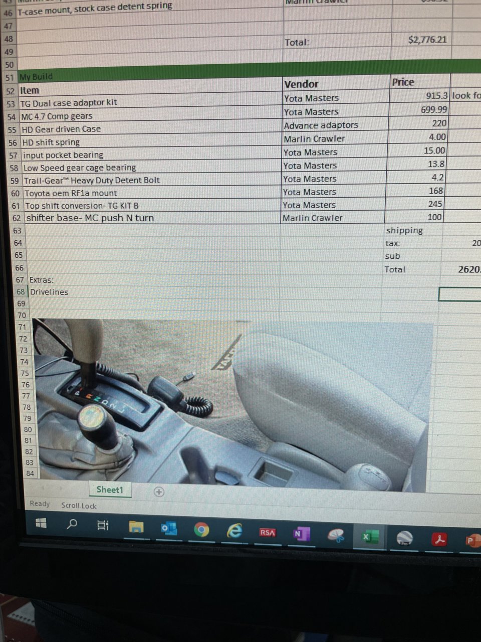

    The conversation kit A is 177, which means I’d be getting the shifter, base and the t case block of plates for 68 extra. I guess I was wondering if there is another brand I’m missing for cheaper than that?

    Parts ordered to get mine going:

    Are the drive line lengths pretty straight forward? Or do I have to build it all and lock it up to get actual length needed

    Yours will be the same as mine. adds 8.5in iirc. Just the added length of the crawlbox unit measured from end of one adapter to the other.
    So lengthen front by that much, and then shorten the rear by that much.
