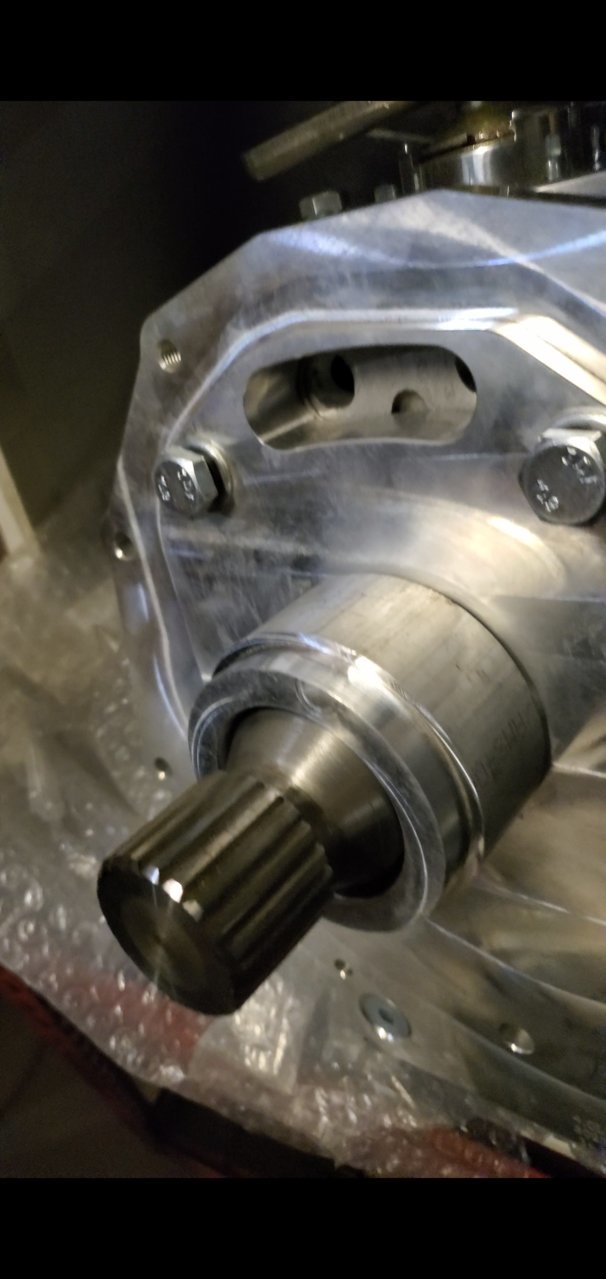

    Hey Jordan- Unless something has change and TG now has the parts, the biggest problem you're going to have putting a marlin / TG setup in a 2nd gen manual is sourcing the oil seal extension housing and the 22 to 23 spline (trans to crawlbox) input adapter that are specific to the manual trans. Unless you can get your hands on a set of used ones, they aren't readily available anywhere. Back in 2019 when I did mine, I was lucky enough to get a spare oil seal extension housing from a good friend who had one on hand, but I had paid through the nose to have my own spline adapter custom made because I wasn't willing to wait on Marlin's empty promises that they would someday design their own. I took detailed measurements and had the shop design the extension housing even though they actually never made one for me, so the designs for both exist. Check out the links I gave you in my responses above.
    I just sold my spare spline adapter to someone last week who is also going the TG route. By some miracle, he was actually able to get an oil seal extension housing in hand from Marlin, but they were out of stock on the spline adapter and couldn't give him an estimate on when they had more. o_O:jerkoff: I told him that I thought it was unlikely that Marlin was manufacturing more of the spline adapters for crawlboxes considering they never had their own design and aren't building crawlboxes anymore...it just doesn't make sense. You could give them a try on the oil seal extension housing and see what they say. They bought a bunch of old inchworm parts last year and put together some frankenboxes out of a mix of marlin / inchworm stuff, but I would say if they don't have it on the shelf they aren't going to.
    I confirmed with the machine shop last week that they can still make both parts. I am happy to put you in contact with them if you REALLY want to go the TG/ Marlin route, but I think you should look hard at the Nfab option. I am actually considering putting one of their boxes together using my old taco case input and selling my Marlin case down the road.
    Chucky_P_671 and wrmathis like this.

    All pro long travel KING 2.5 remote reservoir long travel coil overs with adjusters Arb front locker with Nitro Gear 5.29 gears Cab mount relocation BAMF sliders Coastal Offroad front bumper Warn VR Evo 8s winch BAMF rear shock relocation KING 2.0 12 INCH remote reservoir with adjusters NITRO gears 5.29 gears with factory rear e locker Old man EMU drakkar heavy duty leaf springs Coastal Offroad rear bumper with dual swing out spare tire carrier and dual gas can holder Prinsu roof rack with light bar and storage cases Midland gmrs radio PRP seat covers Dirty life 17 x9 dt-2 beadlocks with 37 x 12.5 milestar patagonia mt Front and rear extended steel braided brake lines BAMF low profile bed rack Pro eagle 2 ton beast jack and mount Hilift jack and mount BAMF rear HD hangers not yet installed Trailgear crawlbox with FJ twinstick transfer case not yet installed Build continues.......
    I am the person @Littles sold his spare 22 to 23 spline adapter to. In the process of the install and waiting for driveshafts, but his design fits perfect on the TG crawlbox. 20210919_110216.jpg
