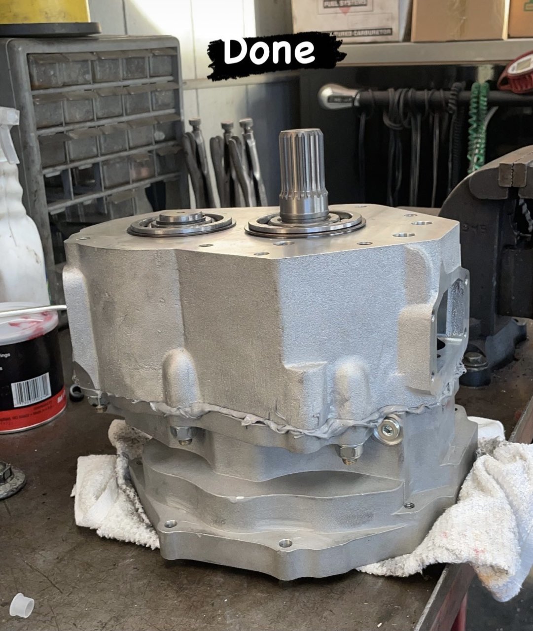

    Case is built. Now just need to find a time to take the truck out of commission to get it all installed. D3BD9A6B-8DA1-4F11-806B-3BC7A9B8FFE7.jpg

    Done? No front adapter o_O

    Lol close to done. Hahah

    How many tube of RTV did you use there LOL

    Lol about half a tube, not super versed in sealing things so I went a little heavy haha learning curve

    Lol reading through this thread, my first take away: dual cases are prone to leak, so more than enough was my goal :fingerscrossed::rofl:

    True, mine looks like that plus I put an extra seal coating around the outside. The adapter is where it's prone to leak the most is what I've seen

    Hope you didn't block the oil channels on the inside of the crawl box case!! I did that on the first box I build going ape shit with the RTV.

    What problems did it cause? Seize up some bearings?

    My coupler/input stripped out almost one year to the day after I built it, that's when I saw the blocked passages. I don't believe that caused any of my failure, but would have not been good long term. So basically don't know, don't want to find out.
