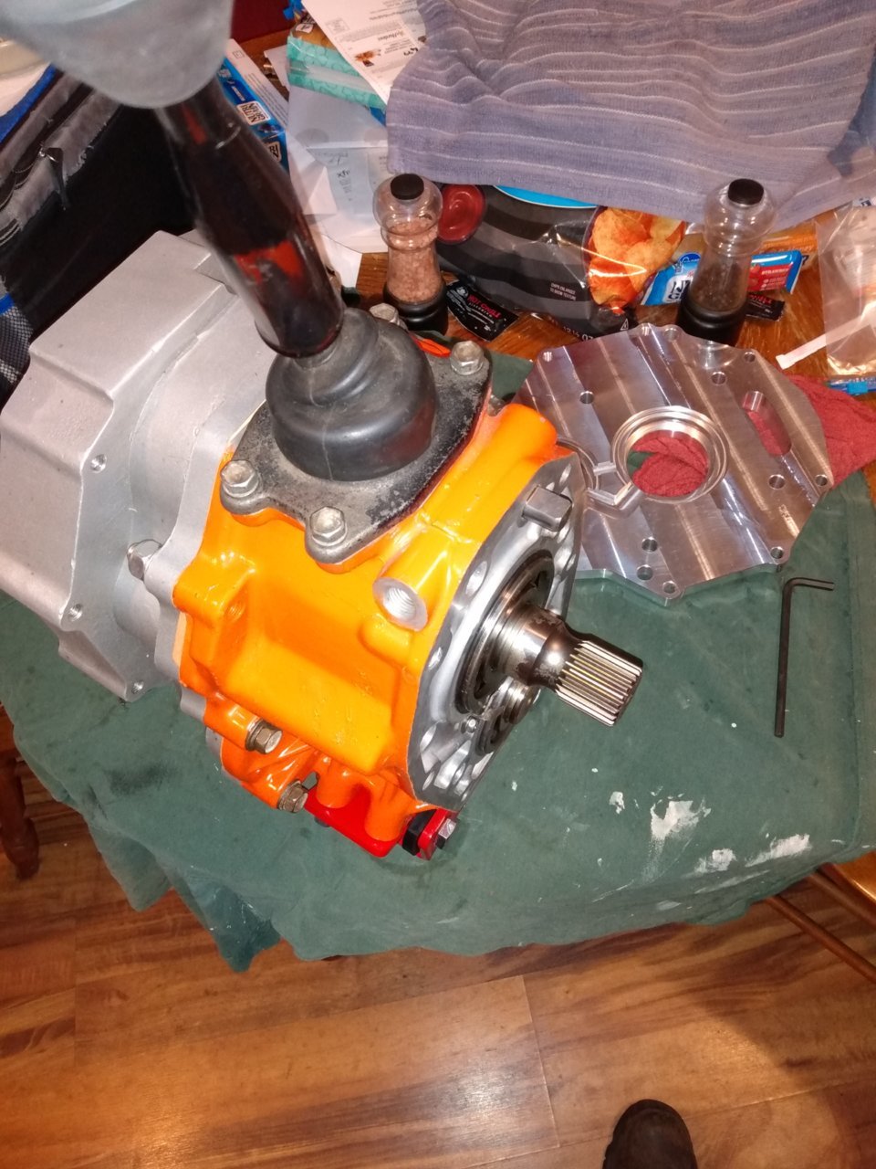

    I've been collecting parts for mine for awhile. I already had enough money invested in the crawl box I'm not gonna switch now. Recently I've had enough odd and end parts show up I started assembly. I got to the part where I put the detent ball and spring in. I put the shifter in to cycle it to make sure it felt good, then I noticed the shift rail hanging out. So my question is was I supposed to cut this rail or the one in the factory case.

    In the factory case you'll pull the "pill" pin if you intend on doing twin stick. For your Orange reduction box you dont need to cut anything. Thay shift rail has room clearanced in your adapter plate seen in the bottom right.

    Thanks for confirming about the shift rail. My factory case is ADD and I've already done the 2lo mod , so I won't need the twin stick.
