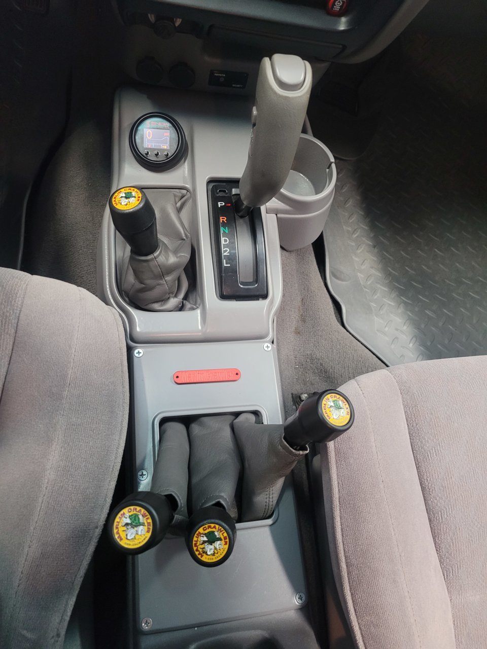

    Man this looks sweet as hell. What twin stick setup is this.

    Look like a RAD

    @Dan8906 Davez make a really functioning one as well. But out of stock and still out.... 3 years later and still not stocking
    As far as tunnel clearance, you won't need to do much since the TG unit is not clockable.

    Im not planning on twin sticks at the moment. But definitely want to get my shifter to come out the front cup holder like that. Hopefully that won’t be to hard.

    Like mentioned, RAD triple stick setup, but the mounting base has been modified to place the twin stick shifters in the forward cup holder vs with the crawlbox shifter.
    While your messing with the tcases now is the time to convert to twin stick, pretty easy todo. Recommend it if you have a lunchbox style locker in the front or plan to, makes it easy to disengage for sharp trail turns then re-engage. If your open or selectable in the front you probably don't need it. I use to have a lunchbox front and the main reason for the twin stick.
    It'll be more of a challenge to form the single tcase shifter, but certainly possible.

    @cbechtold fab a very nice setup. All 3 stick coming out from the factory 4wd position. With time and some fab skill, anything is possible.
    This is my setup as picture. I didn't care to much for the dual cup holder. Plus I swap out to a pre00 front/first console with a pull/slide dual cup holder already.
