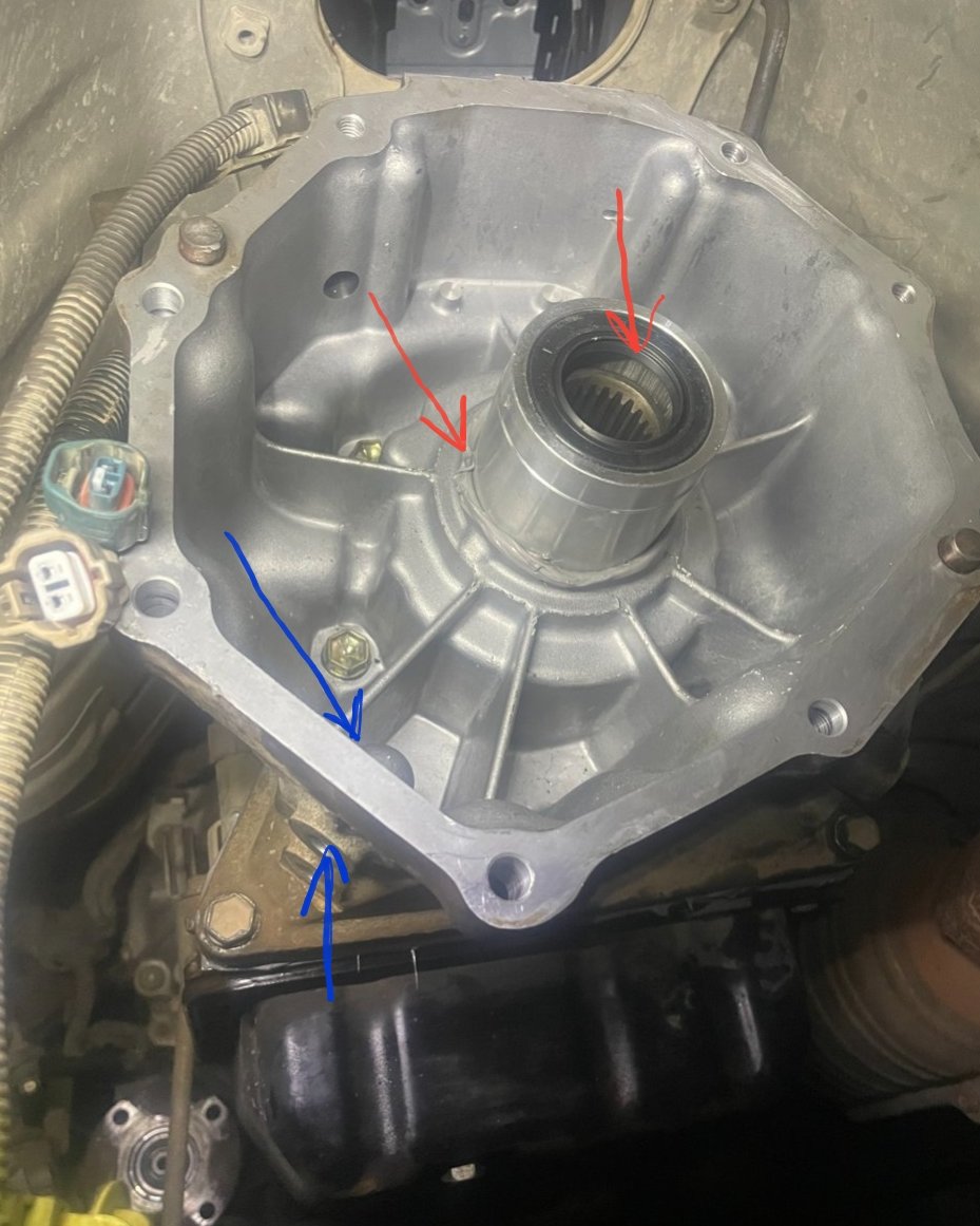

    The old style adapters were that way. Autos now share the same advantage. Hence why its important to loctite the aluminum seal housing coupler and rtv a quality seal at the crawlbox input.
    This is what keeps the two fluids from mixing. This is a bigger deal on autos since the bearing and seal must be removed from the tail housing due to smaller bearing ID as well as a splash shield. Vs the manual config where the splined coupler fits through the ID tail housing bearing.
    It is quite odd over the years most manuals have to seal the blue arrows as the holes for the tcase mount thread all the way through vs the autos that do not.
    Can confirm this as the newer crawlbox adapter plates allow like 2.3 quarts of gear oil the sealed version that uses like .8 or so.
    Also, this is why auto guys should make sure the additional pressed in breather/vent stays unclogged to prevent pressure build up and not blow pass the seal. This is the hole at the top of the trans extension housing.

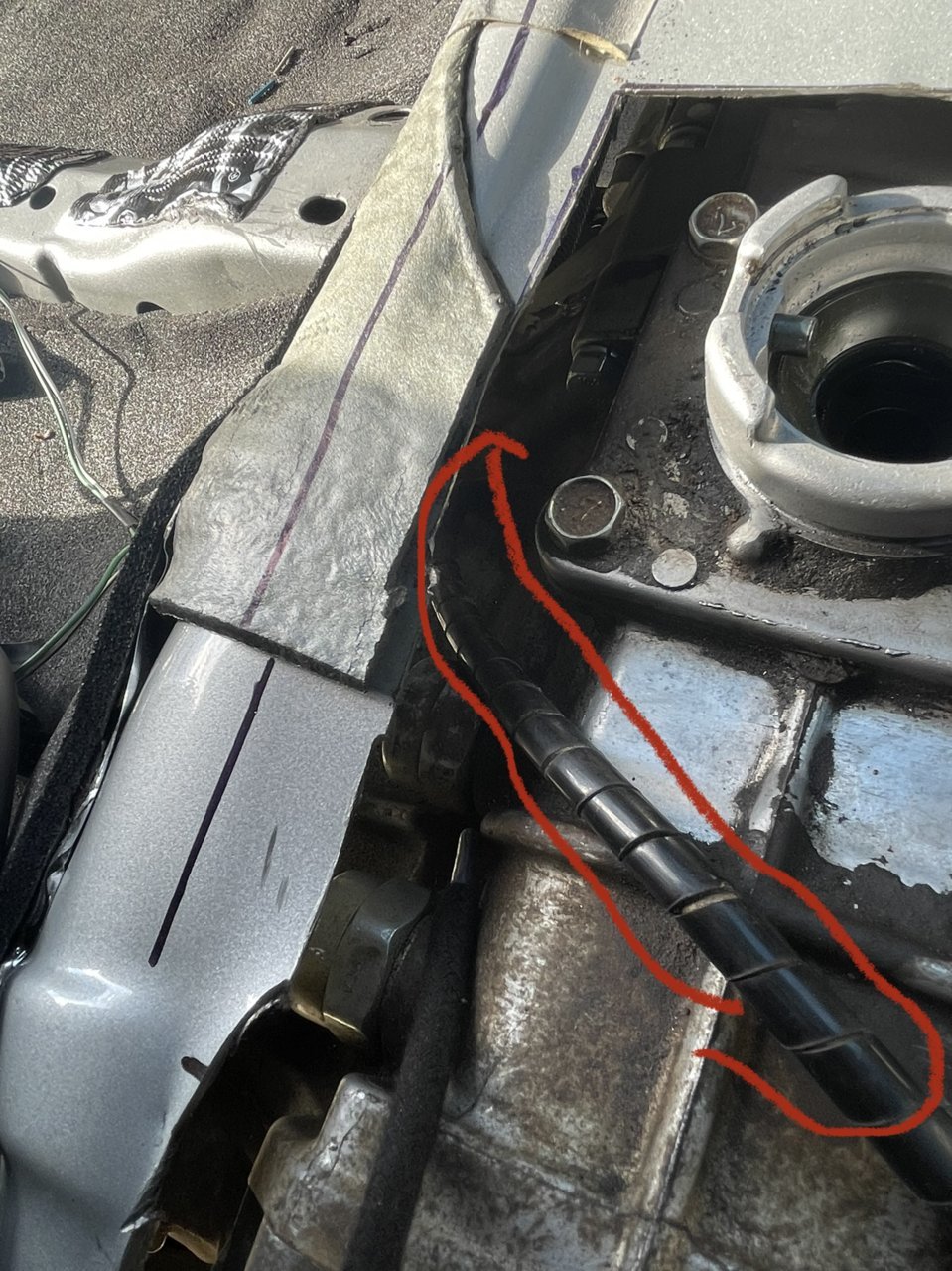

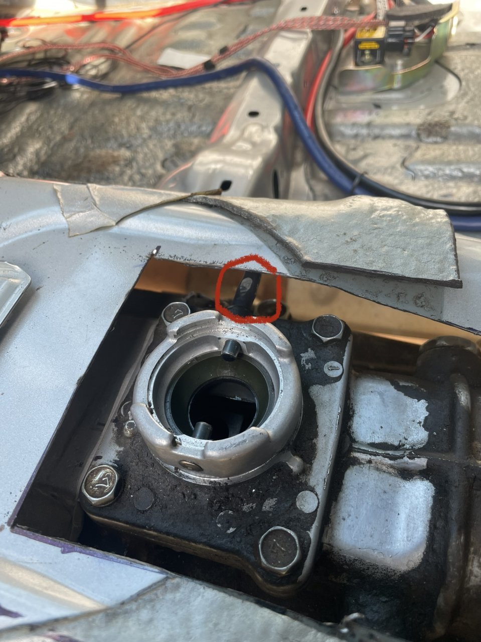

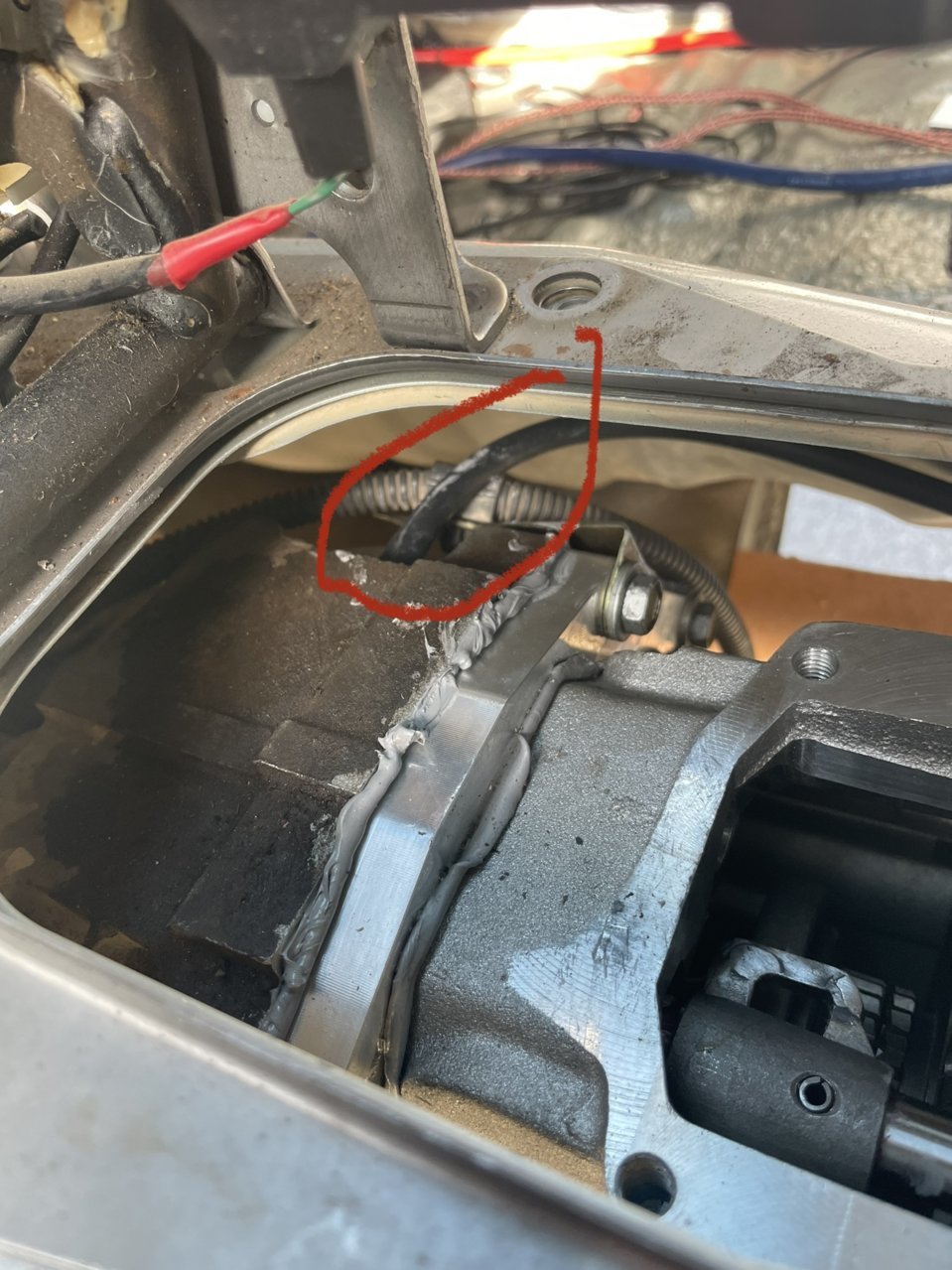

    So when I pulled my t case it had a vent house going to the tranny coming out the shifter base, is the right thing to do just to extend just extend that hose. It’s what I did I just want to verify.
    also what about the vent on the side of the t case?

    These are the connected breathers
    11218603-77B3-4A64-99AC-F24B2E6A33C2.jpg C536F42A-619D-4626-B3C8-548E7CE375AF.jpg
    and this is the one off the side of the tCase I’m not sure what I’m suppose to do with.
    ToyRyd04[QUOTED] likes this.

    The smaller hose just go ahead and lengthen and reconnect. This is the breather from the tcase to the trans extension housing. Most tacoma tcases, had another breather thats capped on the tcase housing itself (only need to mess with if your clocking the tcase). I think that is what the other hose is on one side, not sure where it "ends" or connects to. Most twin sticks at the shifter base will have a breather tapped. This would get rid of the need to connect tcase to extension housing.

    Realized that other one goes to the actuator :facepalm:
