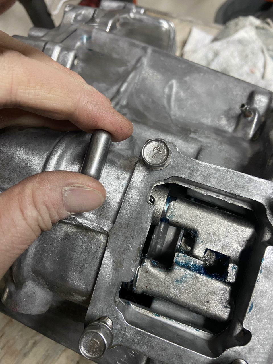

    I got almost done with my rear case the other day and found this mysterious tic tac important looking pin left over. (never a good sign) Tried like 3 spots before I realized it went between the shift rods. Assembled it all and I just got a front range twin stick for it today. The only thing you have to do to install it is remove the god damn pin. FML!IMG_3023.HEIC.jpg

    You also need to grind down the shift rail in addition to removing that pin to get the shifters to operate separately.

    I didn't see anything about the shift rail being ground but will have it out anyway. Do you have a pic of what needs to be ground or is it on the fork so it can clear the hi low?
    Just sucks cause I siliconed the crawl box to it last night. Now I have to take it apart and clean both sides.

    If you're not running twin/triple stick, the pill box must stay on place and you don't need to grind the rail.

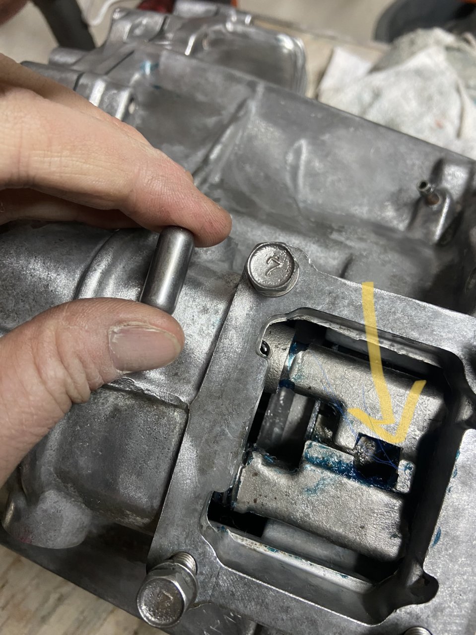

    Not sure how they missed that in the instructions as it's a pretty damn important step.
    Make sure you grind the tab so that it doesnt touch the other rail, but also turn it on its side and grind that little hump that sticks up. If you dont grind that hump, it might hang up on the shifter tab and prevent it from fully engaging, and then you'll have to pull it apart again.
    https://www.tacomaworld.com/threads...l-and-b-s-thread.356319/page-23#post-21536729
    He said hes running a FROR twin stick

    Yeah, i was looking at the pic. I have to shave this??

    Correct.
